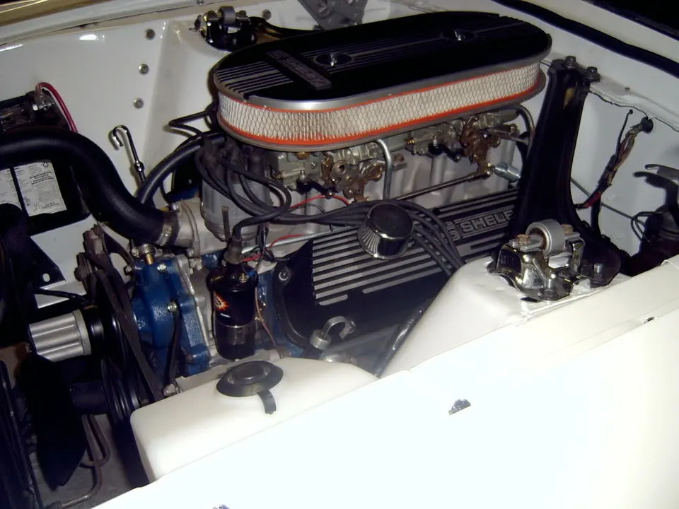

I'm also a body-color kinda guy, and it's sooooo easy to clean. What Meguiar's Quik Detailer doesn't take off, a squirt of 409 will. Of course, being white, every freakin' bug and speck shows, but I spend less than 5 minutes every few drives and it still looks as good as the day I assembled it.
