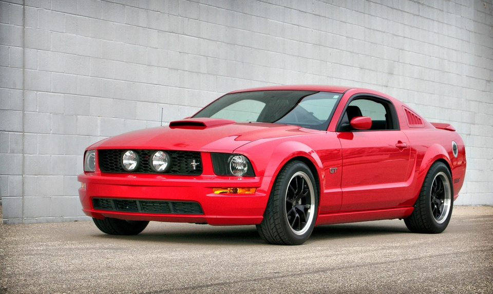

My street set up is the same thing --- here is exactly what I have.
Front: 18x9 +36mm offset no spacers with a 255/45/18 tire.
Rear: 18X10 +45mm offset no spacers with a 295/45/18 tire. I went with a 28 tall in the rear because I also have 4.10s. With the +45mm offset, you can also lower the car without the fender hitting the tire. I lowered the rear of the car 1.5 inches so the car didn't look like a 4X4 with the taller tire in the back. It really fills the fenderwell nicely since its lowered.
I'm running pretty much exactly what PSFracer is running, except +40mm rear offset.
DarkfireGT,
Did you lower your car or did you have any suspension mods done? I am also looking for wheel sizes to put on. Plus are you running on the same size rubber as listed above?
Yes I'm lowered with the Eibach Pro-Kit. Also have D-Specs and pretty much full BMR suspension. LCA's, UCA, LCA Relocation Brackets, Adjustable Panhard Bar, etc...
I'm running 255/45/18 front and 295/45/18 rear. 18x9 front 18x10 rear.
Only go with the 28" tall tire if you have 4.10's.
:lol: Do these Mustangs have any other gear??????:lol:
They should have the 4.10 as a factory option!
Seriously, I don't see why you can't go with the 28" rear tire if you have stock gearing???? That is almost like saying you need 4.10 gears if you put in an additional 150-200 lbs of stereo goodies:shrug:
I"m running 3.31's. Any loss of acceleration is made up by more traction. Both my street and track tires are over 28". :shrug:
