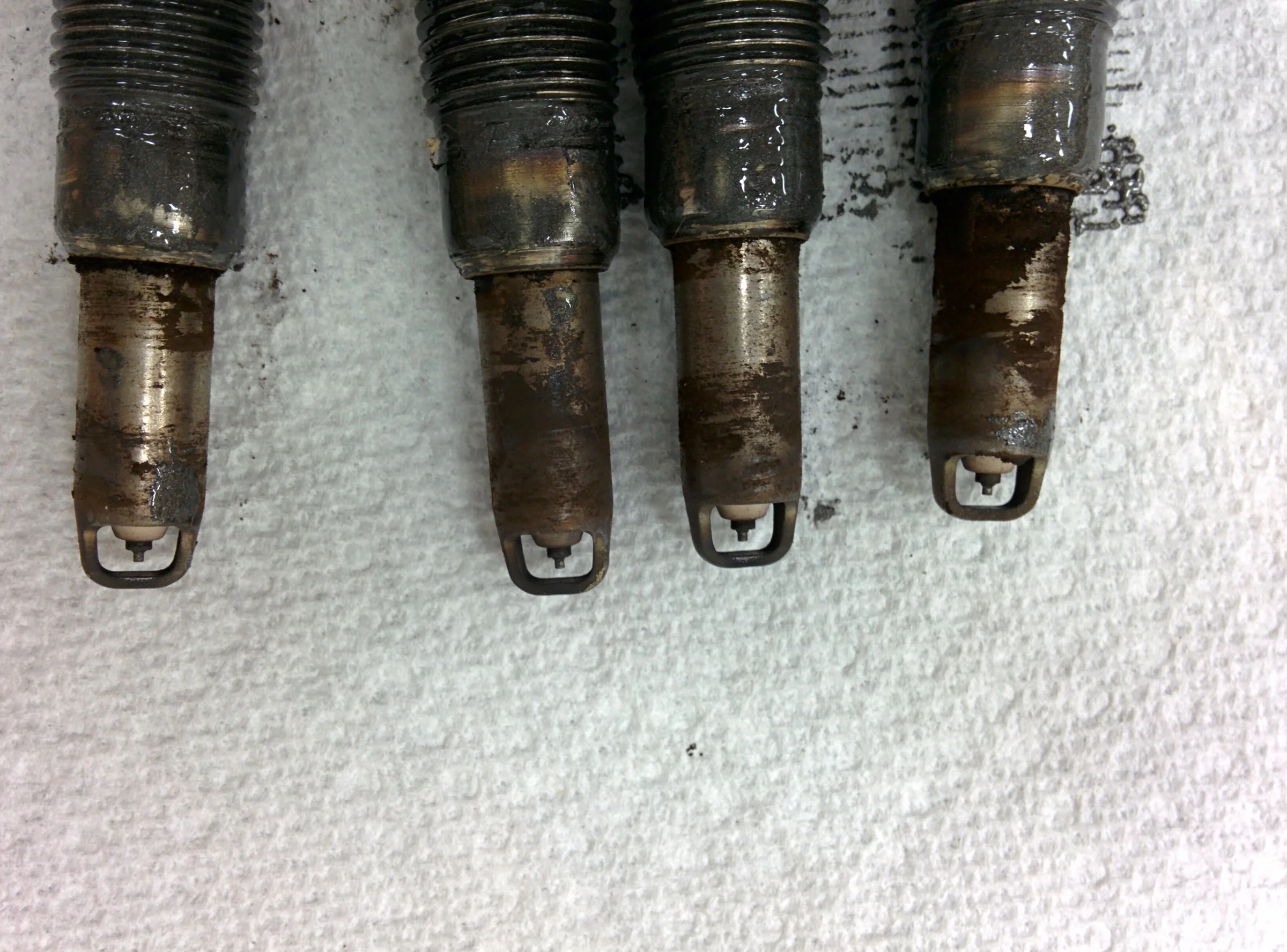

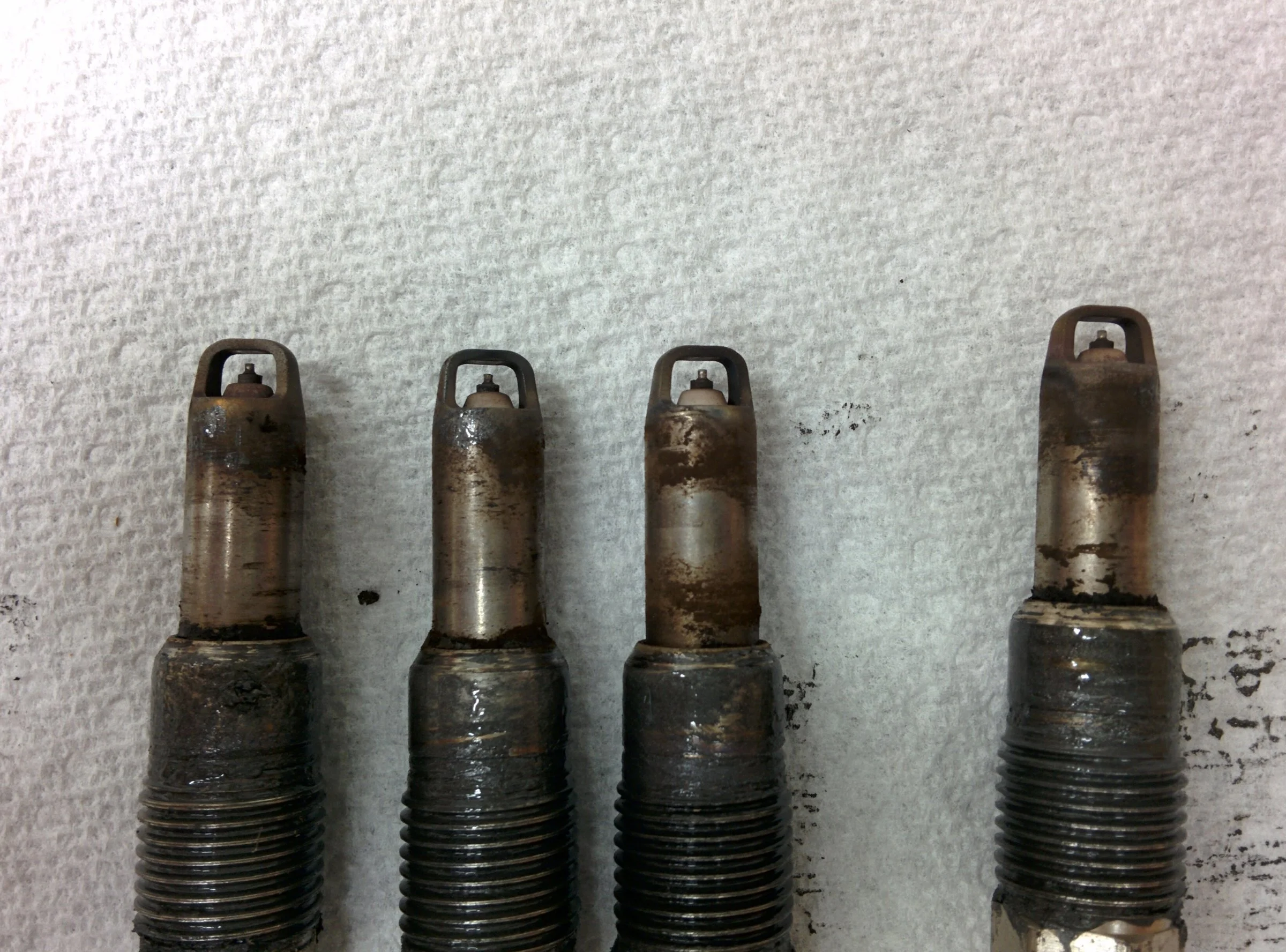

I finally had a chance to take the plugs out and take a look today. It doesn't look like any of them have any issues to me. Do these look normal? They grey stuff is nickel anti-seize BTW.
I also checked around the water pump and did not find any wet spots. I may try to pressurize the system and see if I can find any leaks.
Nothing there to suggest a head gasket leak but since the plugs are out anyway, do a compression check on all cylinders to make sure they're even across the board.
