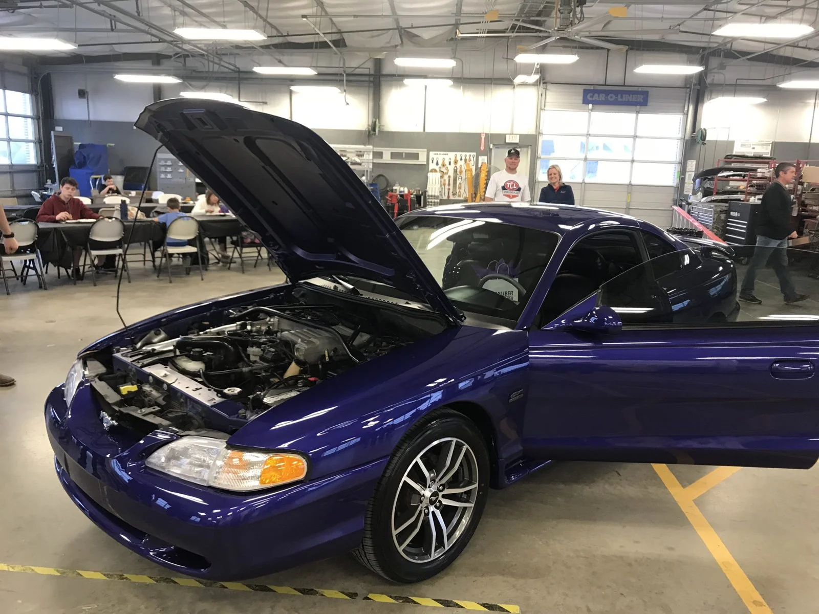

So I’ve been having this trouble with my beautiful SN95 GT 5.0 mustang. When I turn the key the fuel pump doesn’t make any sounds at all. So far I have replaced the fuel pump, and the CCRM. I have tested the voltage and it’s getting low voltage but I think it’s just because it hasn’t started in 3 weeks now and I’ve been constantly trying to start it. Also I checked the button on the inertia switch and it isn’t popped. I’m not sure where else to turn and need some good ideas. I have checked the fuses also.
