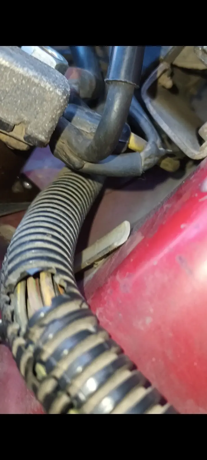

Unknown solenoid wire help 89 2.3
Has no other end so i cant see where it goes, previous owner maybe. It says "fuse 14 g". Google has been no help.

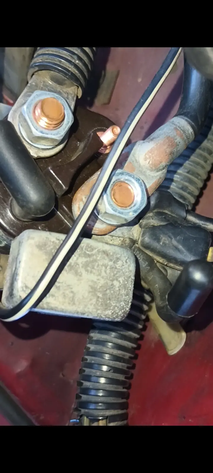

I believe that is not factory automotive wire, take it off, it's going to be 'hot' all the time. I bet it either has a crimp connector or nothing at all.
DISCLAIMER: JMO and in no way any actual mechanical experience.
It might just be a hot wire, very unsure I don't normally deal with this stuff.haha but tomorrow I will take apart the solenoid again because If I remembered that wire was connected to another on and linked up together to that post, I will take a picture and report back.

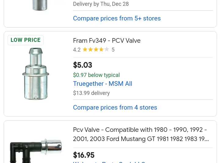

Yes it does, the sensor on the EGR looks new and white, the vacuum lines are routed correctly I know from googling pictures a thousand times haha. I checked the pcv valve too and it didn't seem clogged with oil and I can shake it a little, my understanding that it's good right? And my pcv valve looks like that silver one.

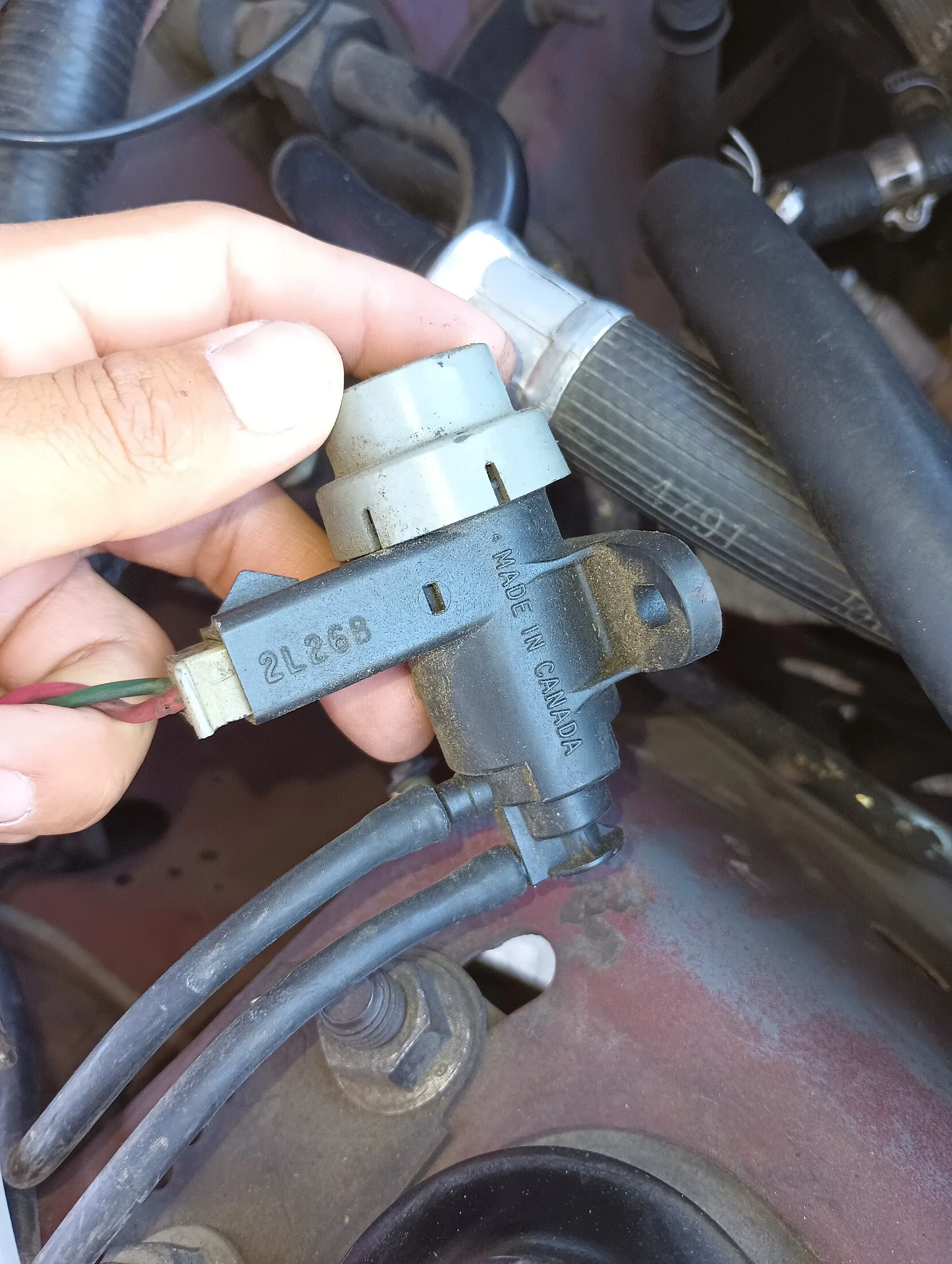

Also I've been trying to find vacuum leaks by listening to the car, I don't have a smoke machine. But if plug the top hole under that gray cap for the EGR solenoid the car shuts off so will that indicate I fixed the leaks?
Are there anymore valves I'm missing?. Again thanks for helping me!

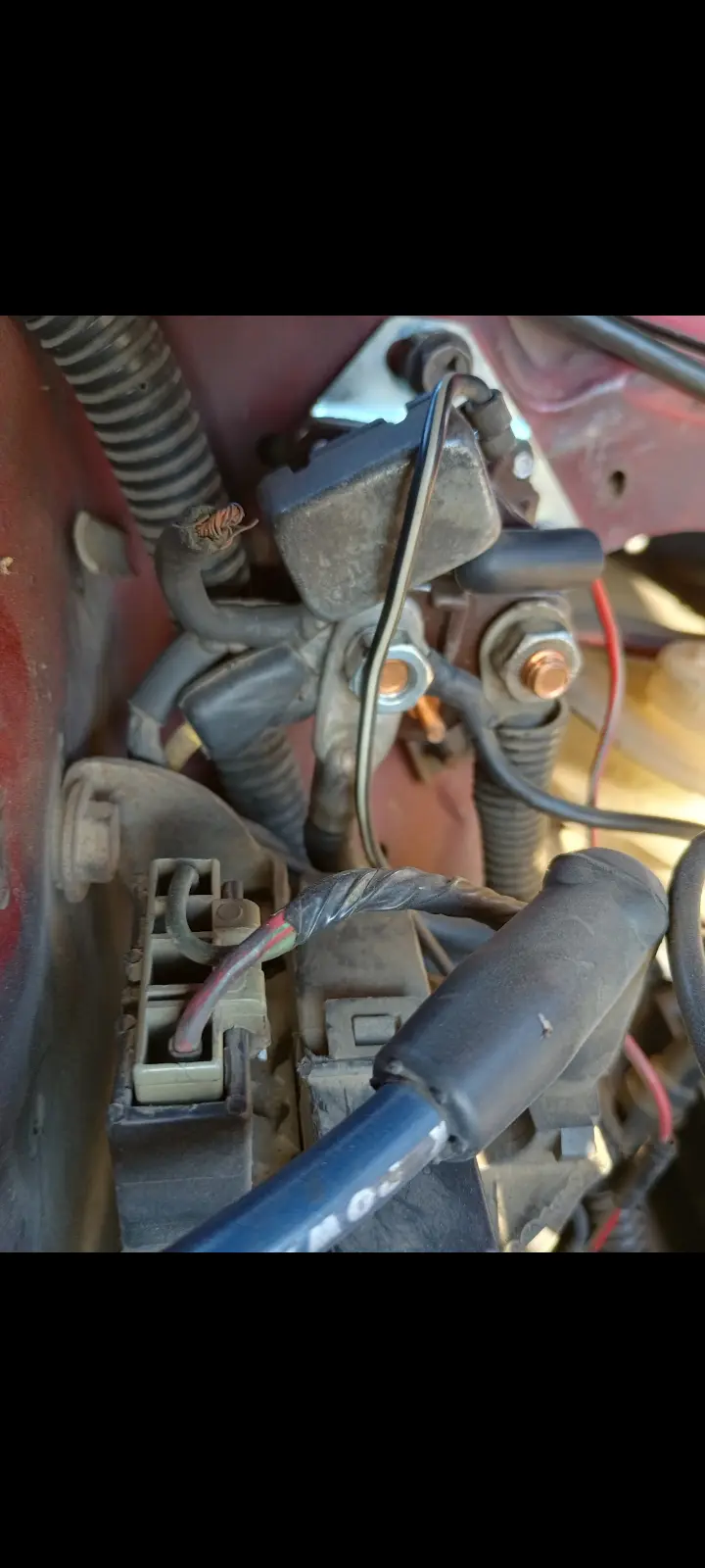

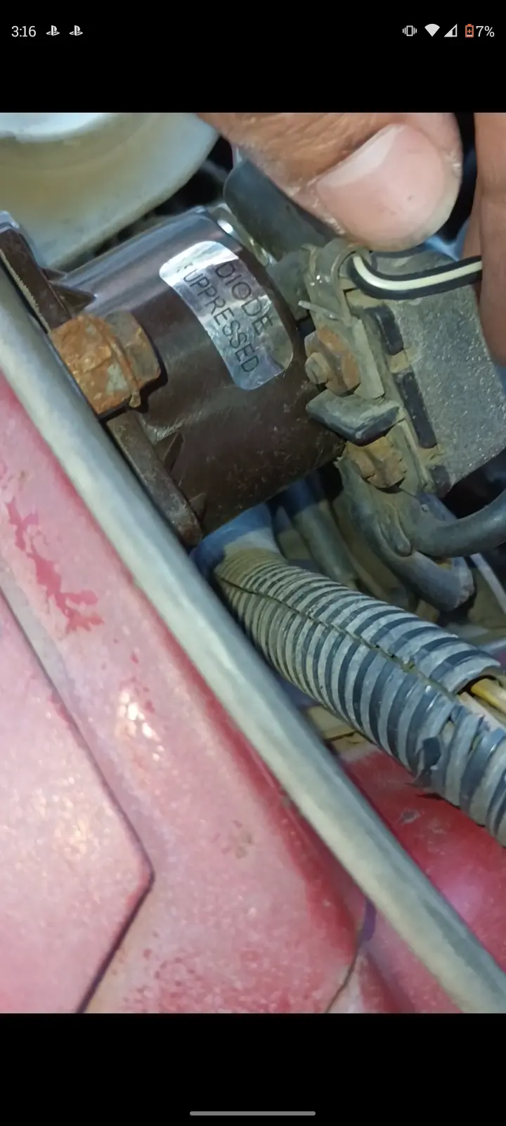

Yeah it looks like it's part of silver box set up, it actually has a couple other wires connected to separate into more. Do you think someone did this in the past or it looks factory
