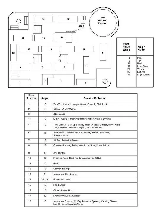

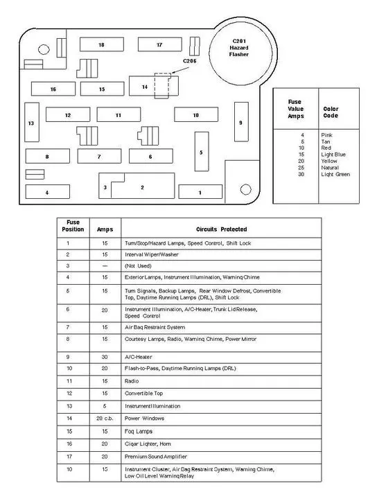

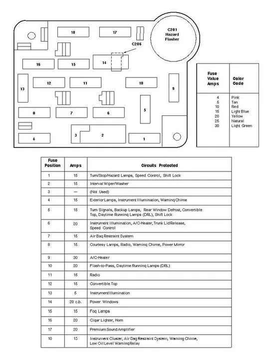

Here's the 93 fuse box diagram. There are none specific to a convertible. You just have to know what your model has or does not have. There are enough differences that no single diagram covers 87-93.

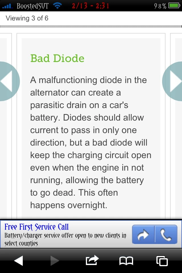

The diode inside the alternator could be bad. A diode is an electrical "check valve", allowing current to flow in one direction only. Parts store can check this for you if you bring the alternator to them. You can't check current draw with a test light or a volt meter. The best way to check for current draw is to use a clamp on meter that reads DC amps. With the key off, clamp it around the positive battery cable and see how many amps the system is pulling. Then you can clamp each circuit behind the fuse panel individually to see where the current is going. Hope this helps.

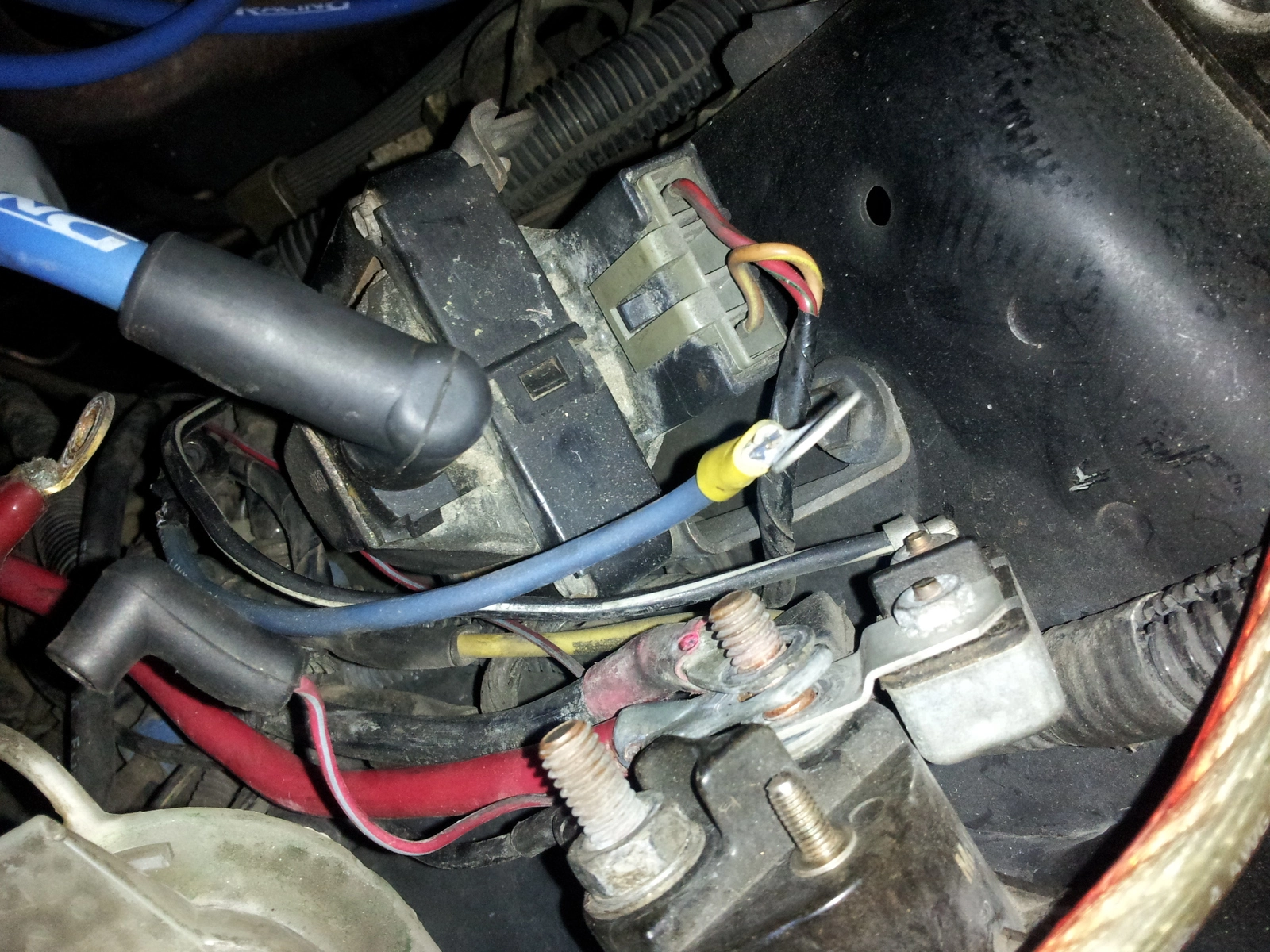

Alright found my draw...check it out...
Traced it as a fusible link. It's hacked in to a two wire line that runs down to the frame under the battery. This is a 4amp draw. With it out and all other fuses "in" I have ZERO draw. Now what link is it? Can I run the car with out it? Heh.

Are you talking about the red and yellow wires in the pic?
