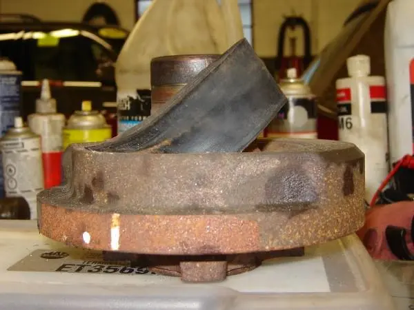

Check the HB. If you want to get a quick..."this may be an issue with little effort/movement". Hookup a timing light and see if with the spout out your timing is at 10* if you have not changed it. IF its a bit off the HB is probably toast. You do not need to get under the car or do any heavy lifting to check the timing...just pop the hood and in less than 5min you will have some good proof as to if it is the issue.
Also take a quick look (with the motor off) at the rubber part of the HB. If it is not even all the way around and looks like a grilled cheese sam-itch with cheese oozing out its toast.
I thought mine looke fine too, looking at it from the top. Then when I put it up on the lift at work, this is what it turned out to look like on the inside.
my.php
EDIT - I wish for once I could post a pic on this forum. Anyway, take a look at the pic of my old balancer in this link.
http://img151.imageshack.us/my.php?image=balrp8.jpg
Awesome. Trust me, I know how annoying that vibration can be. The days before I replaced it, I couldnt even stand to drive the thing. I ended up getting one off of an 89 GT that a friend had and now its been smooth driving ever since.
Just had the balancer taken off by a mechanic and the whole thing 'came apart" lol Sooooo all of you were correct = ) (of course, right? lol) My mom is in town and she was SET on getting my car running correctly what with having a child soon. (p.s. I'm 3 days past due as of Sat and will be induced on Tues)

One thing however, the autozone HB is known to go out. I myself had 2 go bad in less than 6-8k miles. I got a pioneer unit (about the same cost for the non-SFI one) and it has been solid for years. Just be aware it could raise its head again.
