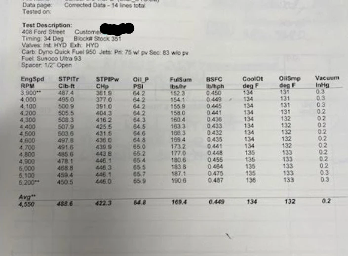

Another instance is in my newest 410 stroker build...Same brutal torque build-up as the 408 and seeings I hate using roller camshafts even though they alleviate friction in the upper valvetrain they are also prone to failures due to quality control issues concerning roller lifters and lifter bars not doing their job on everyday street driven vehicles with non-roller blocks so instead I went with a set of EDM style extra oiling lifters that have a tiny hole lasered into the bottom centers of the lifters to force oil between the flat tappet hydraulic lifter and the camshaft lobe essentially alleviating rotating friction in the valvetrain aswell but those type of lifters will also tax a stock oilpump so in this case a HV/ High pressure pump is warranted and to do the job Im using one from Milodon in my 8qt Canton oilpan w/crank scraper and slosh baffle to control windage and oil return back to the pickup..
I'm also making up for the friction of a hydraulic flattappet camshaft by using a set of shaft mounted roller rockers.............On the 408w I ram Comp Cams pro Magnum Steel full roller rockers w/7/16" studs and stud girdle but they were a tad too noisy for my liking after a 40-45 mile run...
Im even running Edelbrock E-Street heads with the smaller valves yet on a carb on a dyno first pull the flat tappet hydraulic .477/.493" lift camshaft made this kind of power after breaking in the camshaft...Then with my EFI Performer intake that according to Edelbrock delivers an extra 40ftlbs more torque with my performance tune it was closer to an extra 60ftlbs more and the brutal torque came on a lil earlier too............LOL
