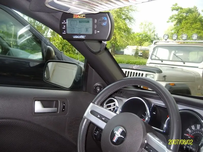

I have an SCT Livewire and Brenspeed 93 Octane tune. I am VERY happy with it. I like being able to monitor and datalog different paramaters with the livewire, and having a shift light and my speed displayed on the unit so that I don't have to look down at the (inaccurate) speedometer is nice too.

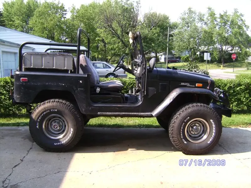

Yeah, I traded my 1973 FJ40 Land Cruiser on 35s for a '95 Wrangler. My wife couldn't drive the 'Cruiser and it sucked in the winter because it basically had no heat. I have never been a big fan of Jeeps (well, to be more accurate, some Jeep owners) because they would come to offroad events where we were driving pretty modified Toyota rigs with their parents stock Jeep and think that they could go everywhere that we did. Then when they broke or got body damage they would whine like babies. Jeeps are a great platform to build on and make a very capable offroad rig, but like everything else, it takes mods and work to get them there. My wrangler (or my wifes, since she drives it most of the time) had the light bar, fog lights and some pretty good rock sliders when I got it. The suspension and tires are still stock, which I'll soon be changing. I'm going to do a 4" lift and put some 33" BFG Mud Terrains and it should be a decent off road toy, but still be very streetable. Heres a pic of my old land cruiser:
Well, I did have the hard top and everything for it, but the heater in that thing wouldn't even defrost the windows, much less keep the occupants warm.
Plus with an old unsynchronized 3 speed transmission, and a 6 cylinder "tractor motor" top speed was about 50MPH, downhill with a strong tail wind, and the motor screaming....LOL
But it was still a fun vehicle....especially off road. :D

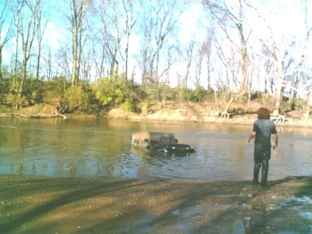

Here's a perfect example of the type of jeeper that I'm talking about. I had to pull this guy out after he took his dads stock jeep into the river without paying attention to how deep it was. The motor was hydralocked, and all he kept saying is "my dad is gonna' kill me" :rlaugh:
OMG................freaking hilarious!!:rlaugh:
patrick
