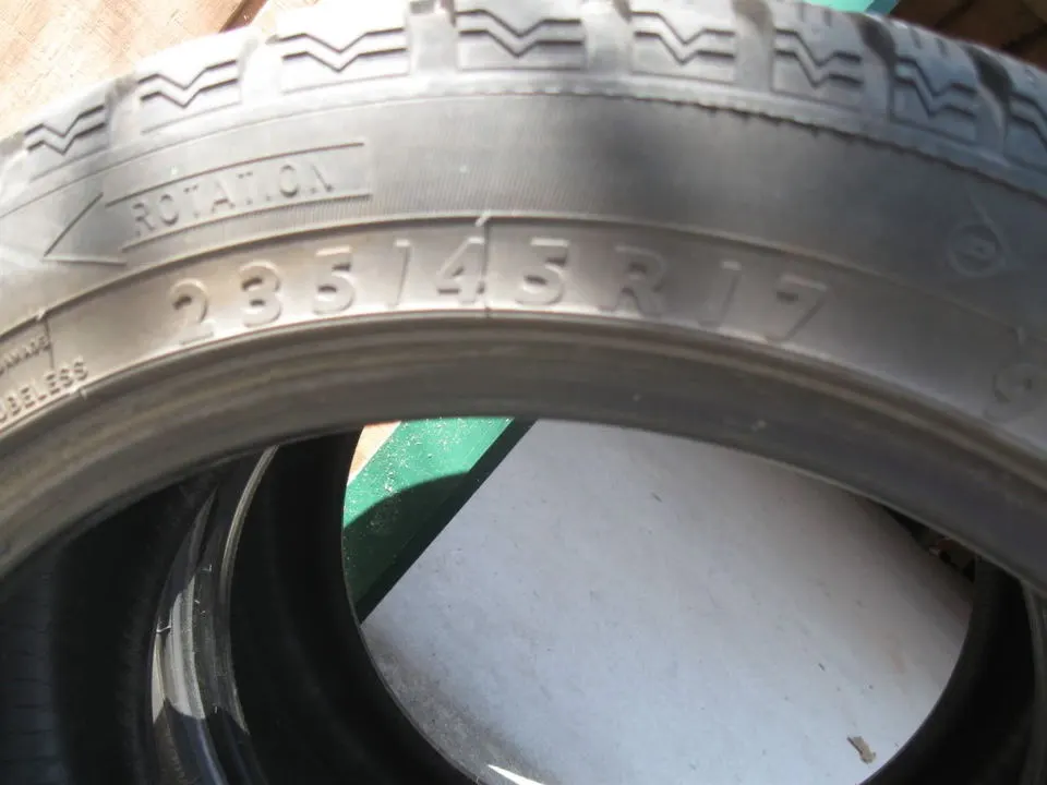

I just up graded my whole rear end just a few weeks ago. I got the Moser 31 spline axles from Mustnags Unlimited and the Differintial from Summit racing, BFR did have it cheaper but I didnt see that until after I got it from summit. Purpose of the rear end upgrade was so I could run these and not have to worry about stuff breaking as much.
