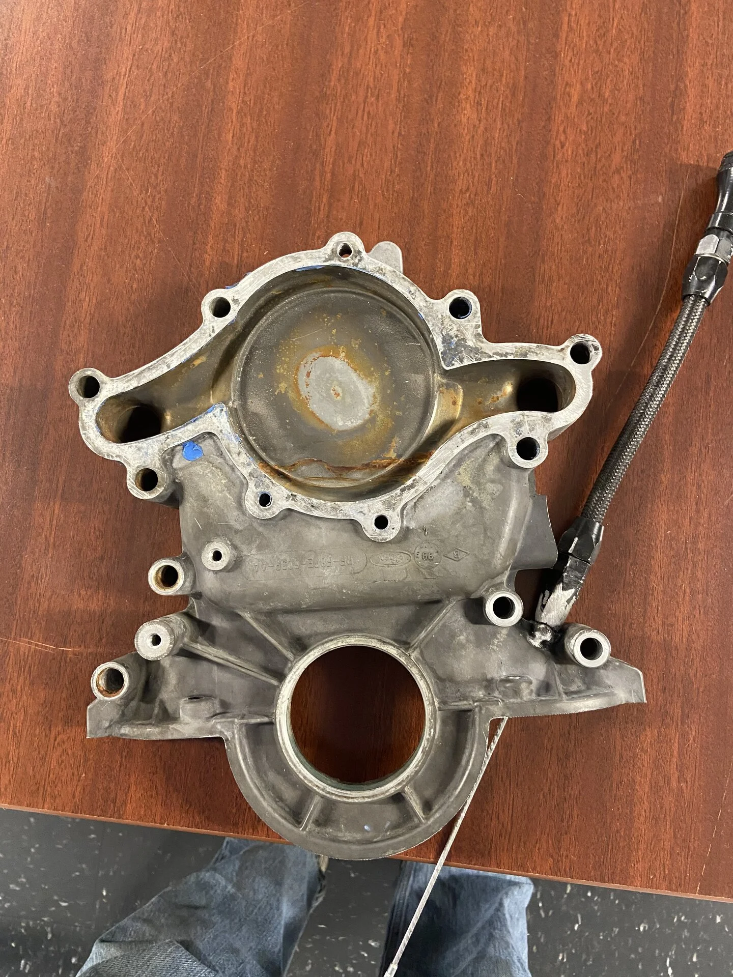

To use the Explorer coilpacks you have to use Explorer front dress so you have to add a hole in the front cover for a dipstick for the front sump pan. (see photo). You will also not be able to use the rear outlet Explorer a/c compressor(maybe in a '69?), you might get a Crown Vic compressor with top fittings, but at least in a '66 it will require shock tower mods.

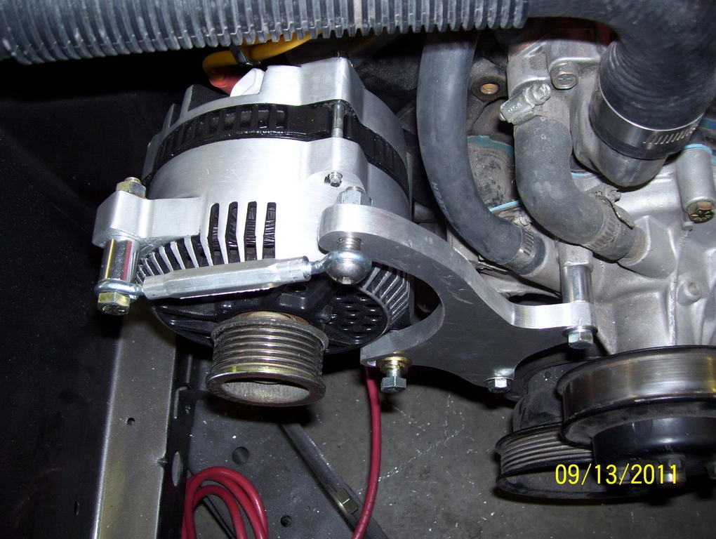

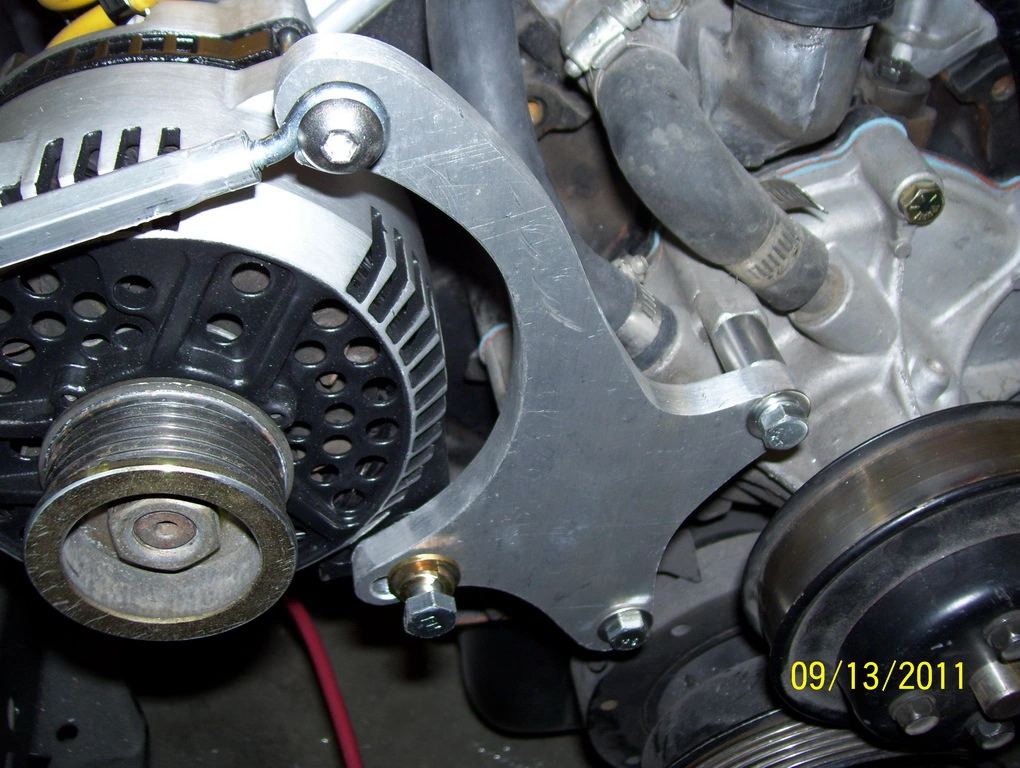

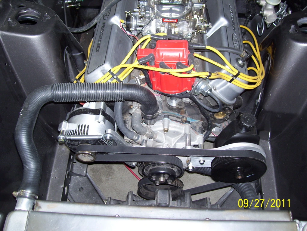

The accessories will be relocated based on best fit for the application. I will make my own brackets. Like the ones in this picture. I will probably use these and tuck the AC under the alternator. I will also use the remote reservoir power steering pump off of the explorer.
I will probably do the dip stick the same way you did in your picture.
