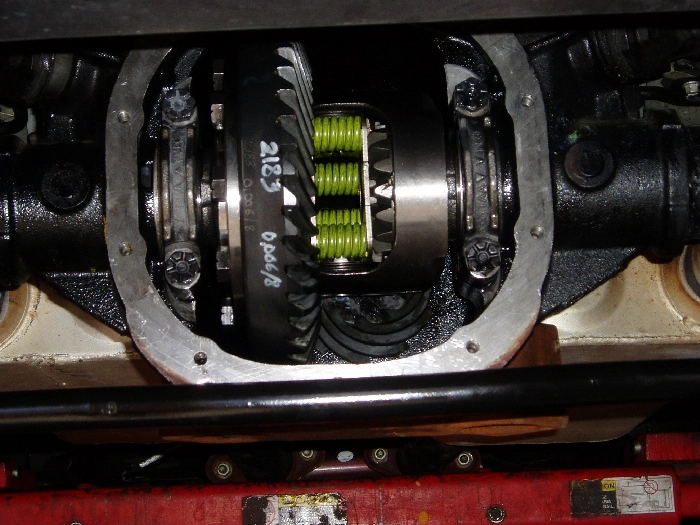

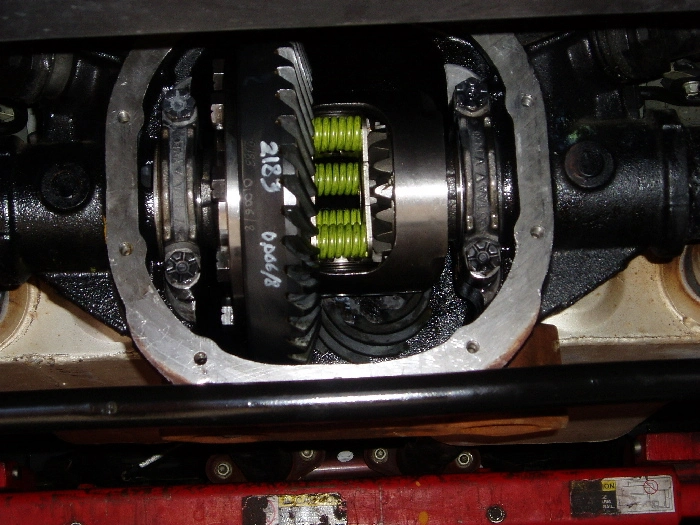

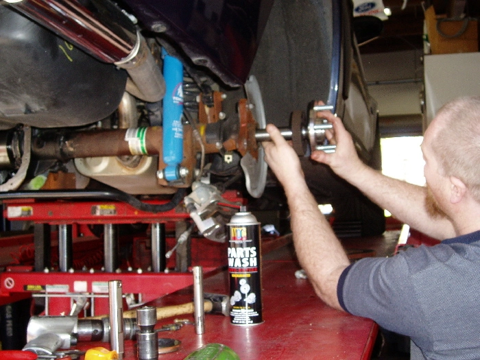

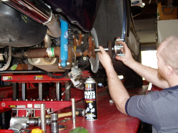

Eaton posi's are the best. Nice straight launches and great traction. I was able to reuse my ABS rings, just be careful when removing them. Also reused my axle bearings.

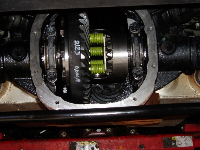

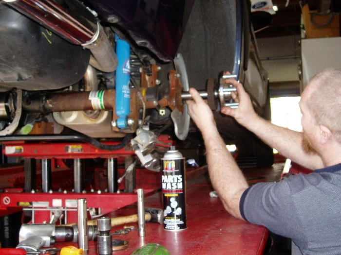

I think the same people who installed yours(That looks like XMP) steered me away from the Unit because the had said they were having to many fail and needing replacement from not so hard Usage, that was about this time last year.
