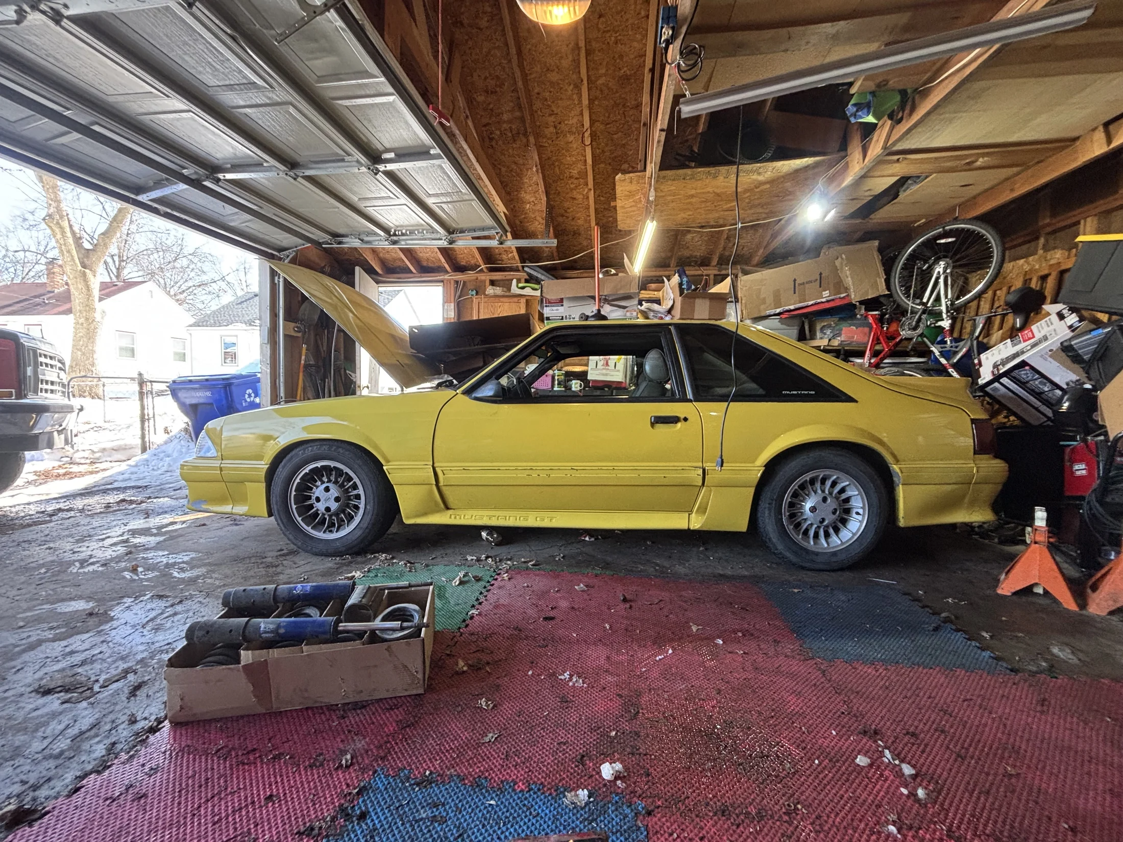

Well the suspension work is about done, everything is in and torqued and I'll be taking it for a test drive tomorrow! I did notice that my front left seems to be sitting lower than front right, left measurement from floor to top of wheel well is 24 3\4" and right is 25 1/2". I don't like how far down that front left side is, it looks like its going to hit the fender if I hit a bump at a turn, turning the wheels lock to lock isn't an issue as there is clearance. I s this a spring install issue? I do know the car was in a serious accident at some point in its life so I wouldn't be surprised if the chassis was twisted.
I do really like the way it sits now!!!
Reactions: gkomo
Drive it a bit to let everything settle before measuring.... Are you sure your floor is level>> I know mine isn't....
