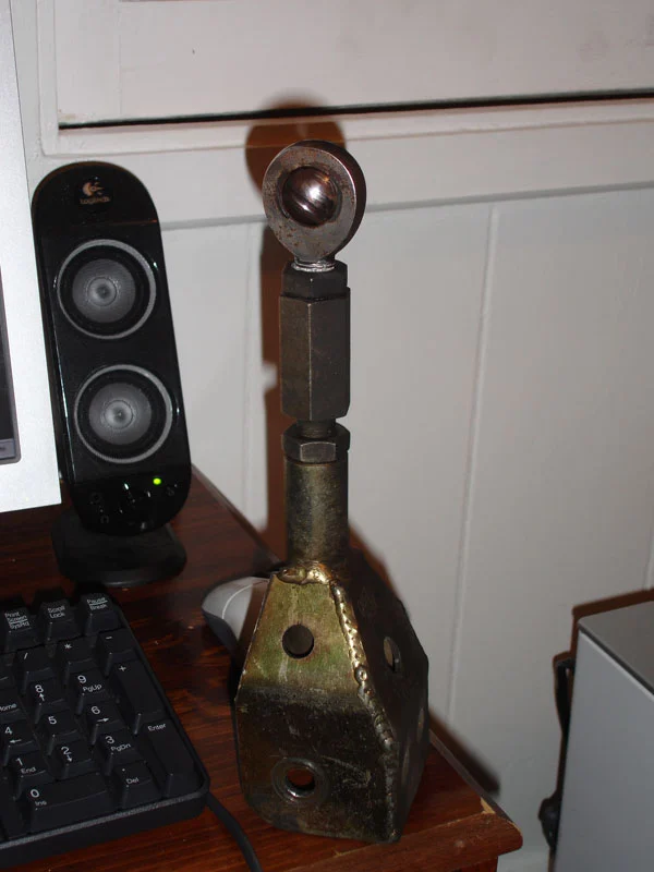

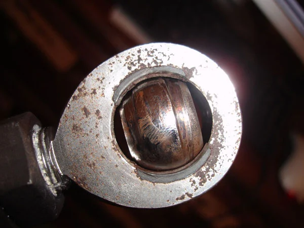

Ok so this clunk finally drove me to near insanity so I went out and took the upper control arms off (I had suspected these to be the issue), and what did I find? The HPM Megabite JR. Upper Control Arm spherical bearings had worn themselves into oblivion! Take a look, I have contacted HPM to see if I can just get the replacement bearings but I'm waiting to hear back.
In searching for the same issue I've found a LOT of people complaining about clunking in the rears of their SN95 mustangs, so check these guys. Oh and another thing, to test them you can just disconnect them from the frame and jump up and down on your trunk (with the lid open of course) and see if you get the clunk or not. That's how I concluded this to be the problem, well besides the fact the bearings are totally shot!.

These are HPM Megabite JR. double adjustable upper control arms for 79-04 mustangs, they lasted about a year and a half. I know spherical bearings don't last all that long dealing with everyday driving, ie: potholes and bumps, so I'm really not that surprised, might have been a better idea just to get some reinforced or heavy duty motorsport ones with bushings on both ends instead. I'll just replace the rod end bearings on these guys though since I already have them, and it'll be more cost effective that way anyways :) I'm assuming there was some sort of teflon bushing in the housing that wore away first as you can see in the pictures it's only on the top and bottom and has completely worn from the front and rears allowing metal on metal contact which caused the grooves.

well that depends on the type of hime joint(s) used, as some have a teflon liner that do not need tobe lubed (and some dont.) the one in the pic looks like it did have the teflon liner but maybe it broke-up due to them being cheap($) hime joints, improper install, something not tight/straight, rear not being square wth the chassis, bad or improperly installed lowers, wrong pinion angle and prob somemore I could think of if I had more time:D
These did have a teflon bushing, they're not very cheap as you can see on HPM's website, and the lowers were installed by probably the best mechanic on the island (besides me :) ), Henry of Honolulu Ford. Pinion angle is set perfectly as well. It's probably a combination of things really, from the weather here in Hawaii to the harsh road conditions, speaking of that, I was out driving today and just noticing how many potholes and rough roads are here makes me not want to drive so much. Camoflauged speed bumps are just as bad, I went over one about 15mph today, hammered my exhaust (Bassani X-pipe), I got out and cursed out the speed bump for a few minutes, made me feel a little better.. Haha... Also this car used to be a Honolulu Police Officers highway patrol car so I'm sure he got quite a bit of use/abuse out of it.
