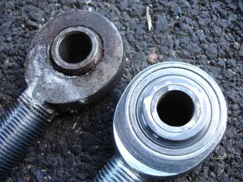

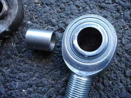

Thanks for all the posts, I finally got ahold of HPM and they sent me the rod ends for $12 a piece, I'll post up after I get them installed next week to let y'all know if they solved the clunking issues.
Well, HPM sent the rod end bearings regular ground so I'll get them in 2-4 weeks probably, so I just went to my local bearing distributor (Mequires Bearings, Honolulu) and purchased some LM10 5/8-18 rod end bearings, the only thing is that they had 5/8" eyelets so I had to get a sleeve to reduce them to 1/2". I got them replaced, had to shave the spacers a tiny bit because the bearing is actually a lot bigger than the ones that come with the HPM control arms, which in a way is good I think, a lot more bearing surface area to ride on, probably last a lot longer. Here's a couple pics of the new rod end bearings, oh and the clunk didn't go away entirely either, I'm thinking the pinion snubber is hitting a little as well. A lot of the clunking went away especially while shifting.
