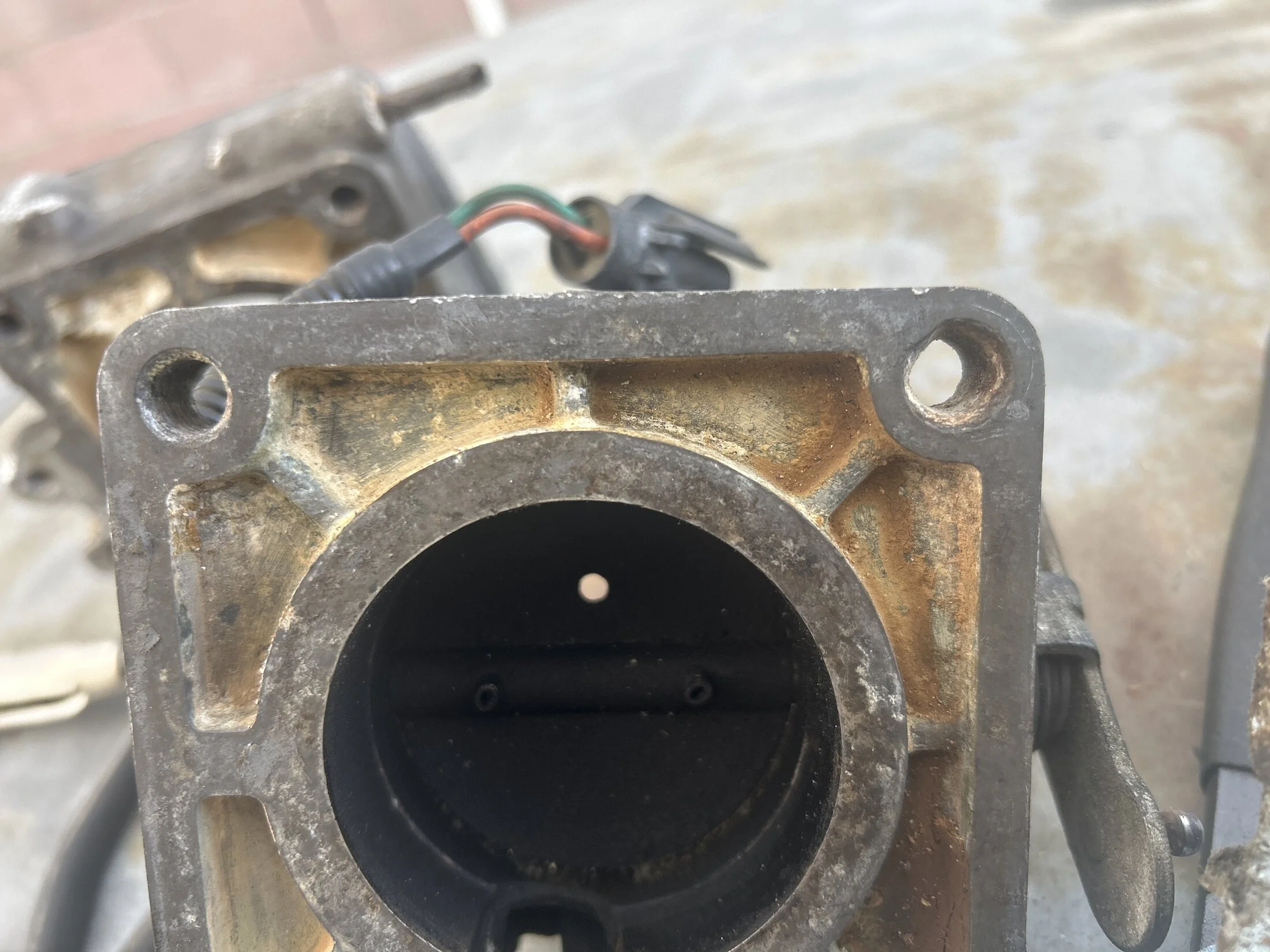

Hey all, just wanted to get an opinion on whether this damage is not salvageable? What you’re looking at is the plenum side that mates with the egr spacer; it was a tough cookie to remove the spacer so the plenum took some damage
Could I just sand this down and carry on or will it never be the same ?
Fill it with some JB weld, sand it flush, add gasket and send it.
If you were planning on deleting the EGR it won't make a difference regardless as you'd be blocking this cavity off anyway, but I would still repair and prep it.
Reactions: General karthief

Never mind, the top right hole in the image below looks corroded beyond fixing
