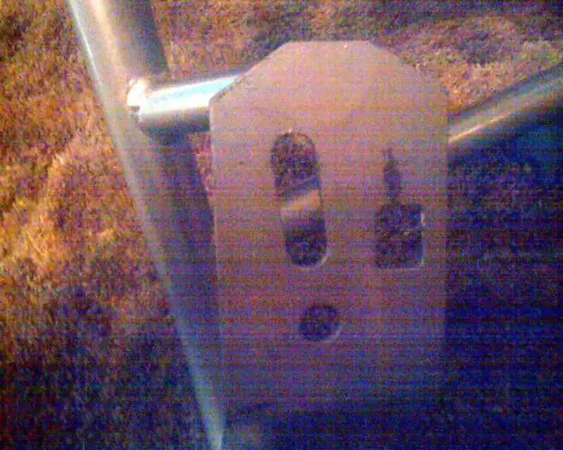

The alignment pegs are hitting an inch above above the alignment holes on both sides of the k-member. You can see where they make contact.

Well I got that sob in there! Yippee. I turned the header collector flange on the drivers side which gave me almost a inch of extra clearance to jack it up. Then I ground down the motor mount alignment peg a little and it went in. So I'll just send back the new one coming tomorrow.
There's a little bit of my blood on it now, but at least the damn thing is in.
