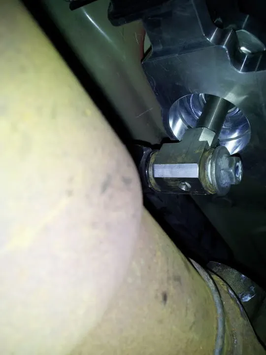

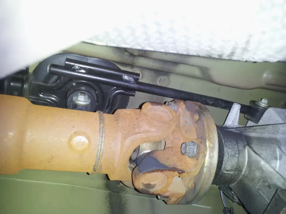

Unbolt the original shifter from underneath the car.

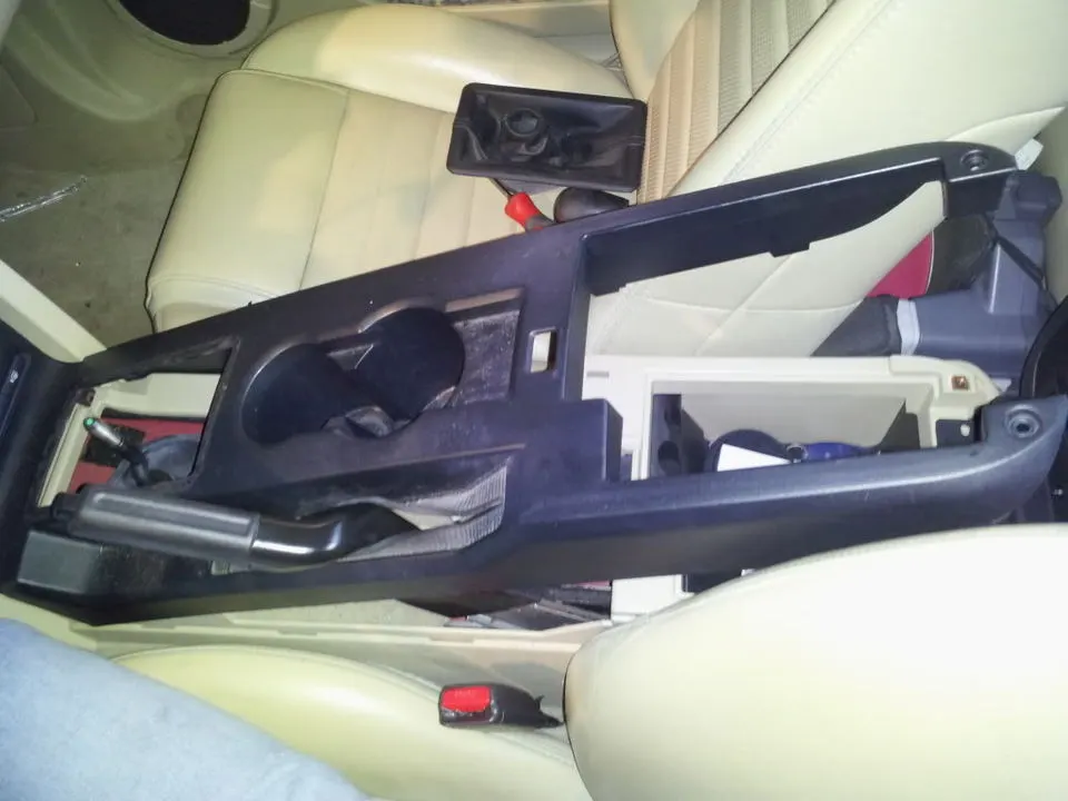

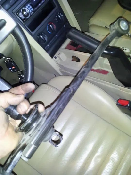

Move up top to remove the center console so you can pull the shifter out from the top.

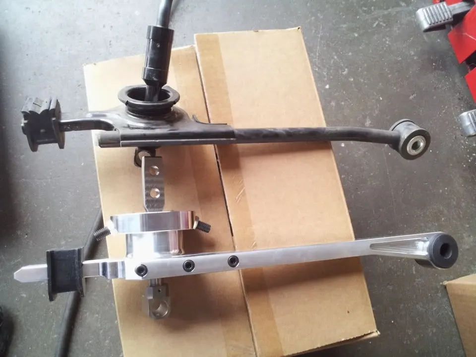

UPR Blu Thunder Billet Shifter vs OEM floppything.

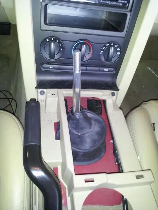

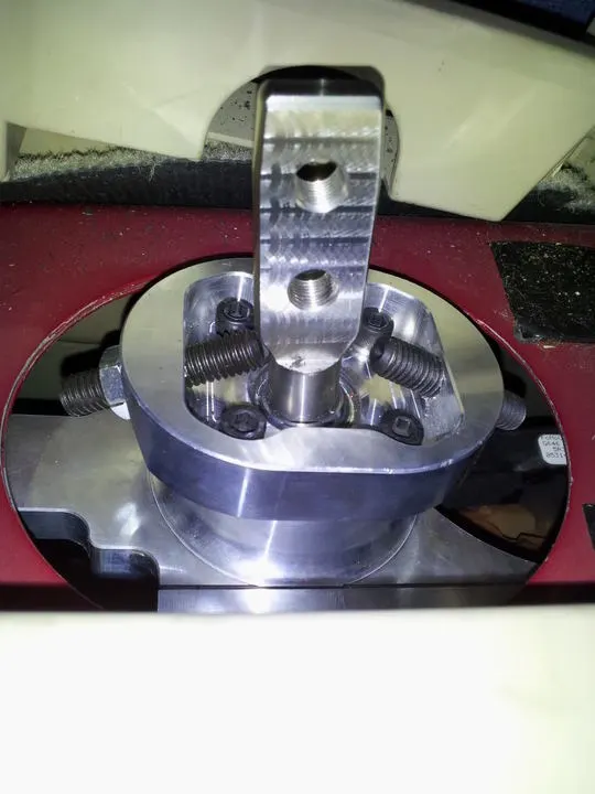

Install the Blue Thunder Shifter with the long side of the lever toward the driver's side.
Adjust the stops.
Attach the handle and the inner boot.

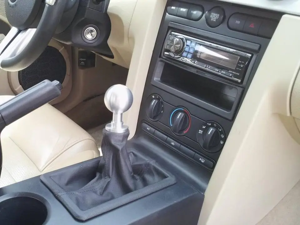

Reinstall the center console, shifter boot, and your choice of shift knob. We chose the billet ball with the 5-speed pattern.
