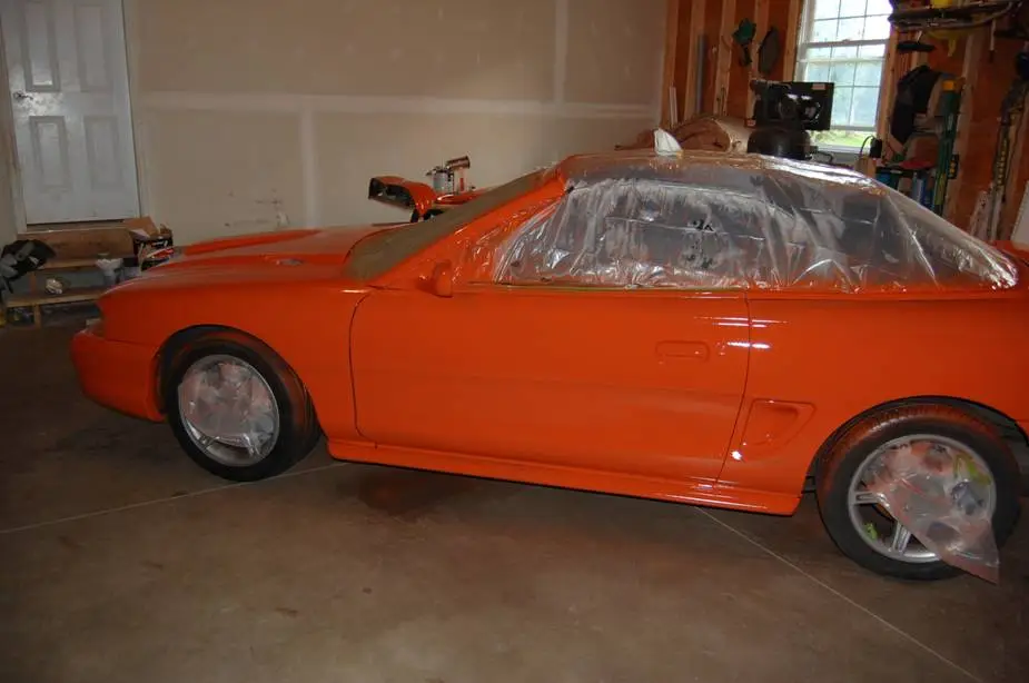

I'll let you know how mine comes out next week... I am using an oil based enamel single stage paint...
Including a used rear bumper cover, a new fender, a hood scoop that I am molding on, an aluminum fuel filler door, buying the HVLP gun, sandpaper, etc, etc, etc, I am going to be into mine for between $600 and $700 for a two tone paint job... Black over Orange... Here is a pic of the car after my first coat of orange (some runs, some orange peel, thin on the top since I planned to two tone it anyway)... But hey I learned on this coat of paint...
yeah definitely keep me updated. I'd love to see some pics when your finished.
