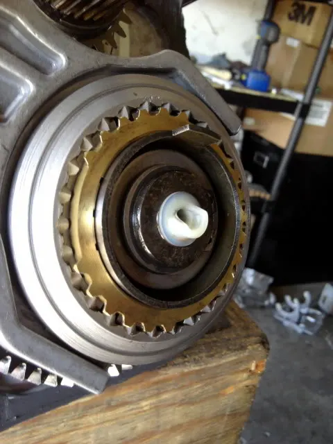

On certain T5s, there is a "directionally keyed" washer that attaches to the very end of your reverse / 5th idle shaft to allow the shaft to move X amount of degrees in order to provide for smooth engagement into reverse or forward gears. If you failed to align the "tooth" of that keyed washer with the notch (which is about 2/3 of the diameter of the area into which the shaft fits), you may be experiencing binding there and will eventually cause the c-clip to fail. The first time I experienced this, of course my wife was driving the car back late from work, and was stuck in 3rd gear due to the binding - Call the tow truck! If you pull off your tail again, look for that "notch" and make certain that the washer aligns with it before you tighten everything back up - worked for me.
Actually, that "keyed washer" is part of the reverse brake that was supposed to solve the grinding when going into reverse that the T-5 is notorious for. It was introduced around 1992 and most newer T-5's will have it.
Your right about it needing to be aligned corectly with the tail housing; however, I would think it would be mpossible to seat the housing all the way if it were not lined up. Seems like it would break off if it were not aligned.

FYI,when re-installing the tailshaft housing,the Tranny should be in neutral, and the metal tab should be in the 12 o clock position.
