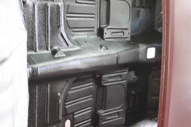

yeah i agree with pocketlint ,i would use bed liner. wall mart sells a gallon ,its a two part mix around $80 .i used it in my 69 and its very tough stuff .can be sprayed ,rolled or brushed in . i think it would look great under the floor as well. i am going to spray it in the wheel tubs and in side the quarters as well. it does look better if sprayed in they do sell a cheep gun that works prety good.
I may have to try putting it inside my wheel wells, too. Early on when I did the control arms, tie rods, all that stuff, I sprayed that rubberized paint under there to make it all uniformly black and for sound deadening. Worked and looked great, but has started to flake off in some places.
if you follow directions with this stuff i dont think it will ever come off
epoxy prime first and make sure its clean and no rust and no tar ,forgot to mention the liner from wall mart is a kit ,comes with a roller and scuff pad, it takes a few hours to dry depending on temp and humidity so have patience,sorry bout the double pics
