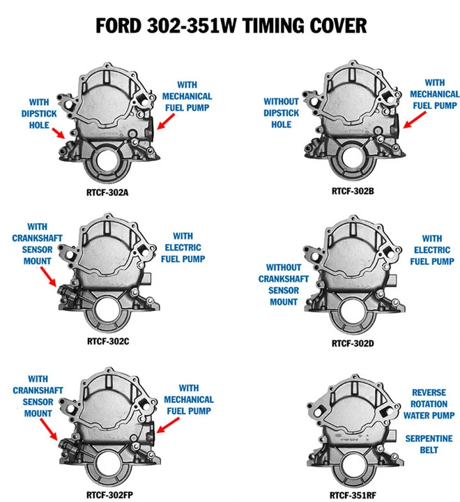

43593d1209496010-there-any-difference-between-years-timing-covers-ford-timing-cover-chart.webp
Thanx for the great info, guys. According to a seemingly knowledgeable tech at Ford Racing either pump can be used on either cover "as long as" the rear plate of the pump has round port holes instead of D/U shaped. He said most/many after market, replacement and rebuilt pumps have the round ports to allow wider application coverage for a given part number. We are going with a carb, but there is already a new Holley "Red" electric pump laying in the trunk and a new timing cover isn't really in the budget. We are looking to maximize an estimated $700-$1500 turn around for getting it roll (not road) worthy. Every extra $100 detracts, yet we certainly don't want to sell a roach. Obviously if it was a car "I" was gonna keep, I would be anal, but the car will sell cheap enough that the buyer can dot the i's and cross the t's to his own liking. It WILL have correctly working brakes, start, drive, steer, charge and stop properly but still be simply a rust free convertible restoration project car. It will be a nice platform, yet still be a "blank canvas" for a restoration/resto-mod or roachy (yet dependable) driver/work in progress.

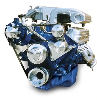

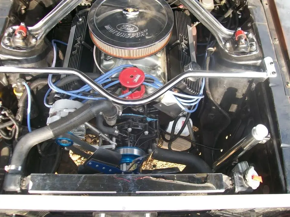

when i put the 5.0 into my '66, I just used a 5.0 swap radiator and a kit from march performance which put the alternator on the passenger side and the tensioner on the driver side. It maintained the proper rotation for the serpentine system. I also had to use an electric fuel pump.
it looks like this
I did the same thing on my 68. Then I got tired of the way the tensioner looked over there by itself and took it off. I use the adjustable link for the alternator to tension the belt. I know it doesn't look like much belt wrap, but it doesn't over heat in the TX summer.

Thanks for all the thoughts. A March setup is WAAYYY out of the budget, but a cool setup. It turns out the pump is a standard rotation so I"ll just use the grooved pump pulley that came with the car (it also had a smaller diameter "smooth" pulley) and use the OEM tensioner between the alternator and fan. And the timing cover is a standard rotation style with no fuel pump mount, looks like RTCF-302D. Bonus is the pump, alternator and all pulleys are chrome :rolleyes: Woo-Hoo! DOH!
