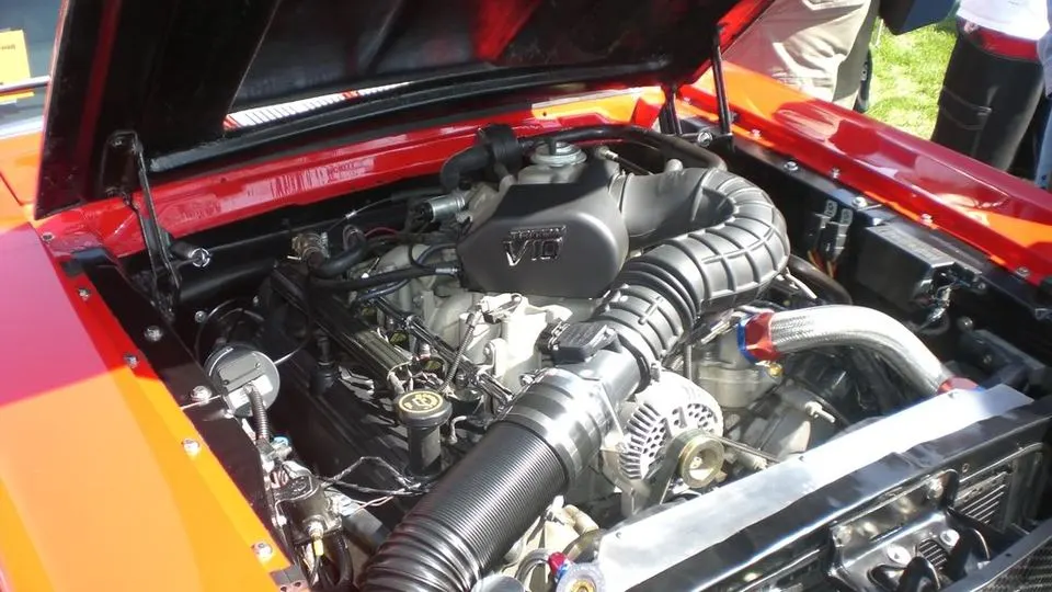

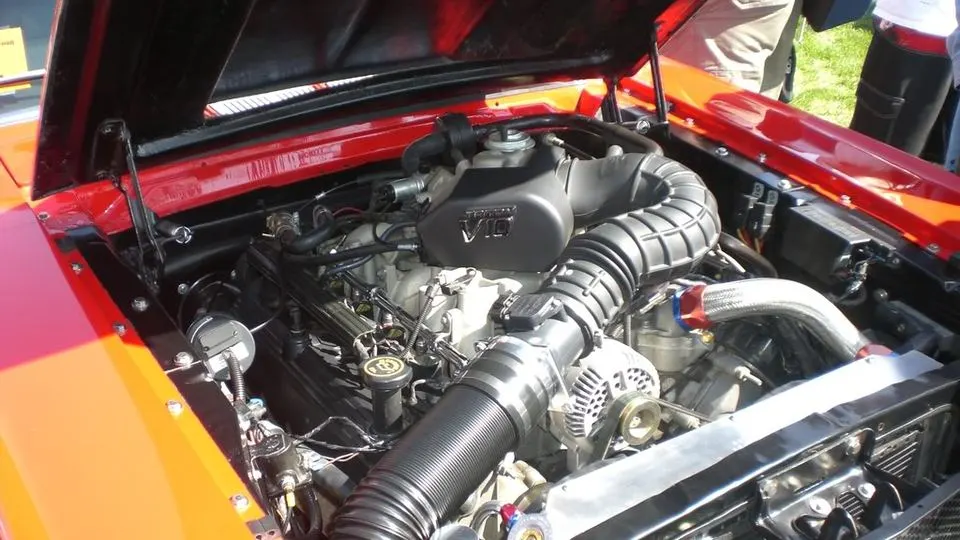

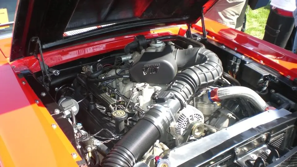

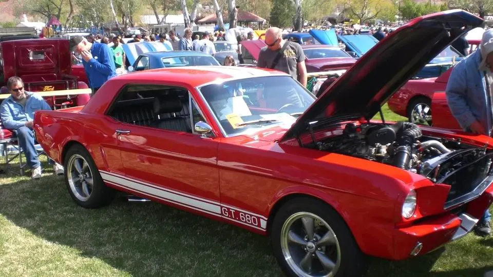

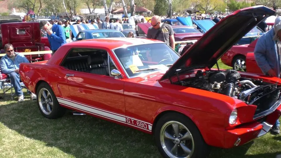

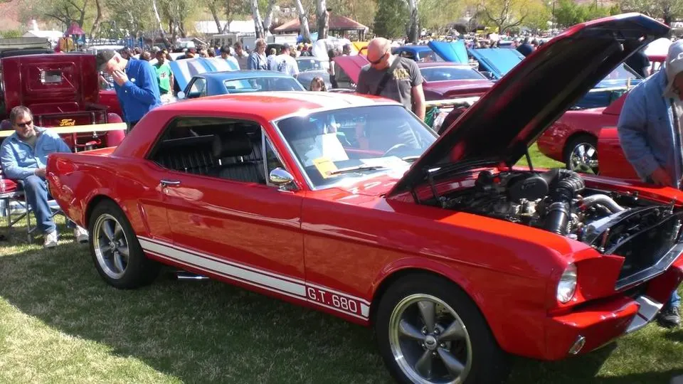

I think the V10 would be awesome in a classic stang. I love the exhaust note. Nice and smooth with those extra 2 cylinders. I can see the point of building a v8 to match power as well but the V10 just has that WOW factor you get along with the customization. I say go for it and post some sound clips when it's done cuase it will sound great.

I would hate to change spark plugs on that LOL
Not as bad as you think. In the "close-up", look between the valvecovers and the fuel rail for the injectors; the little black cylinders with yellow lettering on them are the "coil-on-plug" (COP) modules. Each one is a little ignition coil; triggered by the computer; and like the name says, they're sitting right on top of the spark plugs in place of plug-wire boots. You've gotta pull the fuel rails to get a straight-on shot with a plug socket; but at least they're not down with the exhaust manifolds! :D
