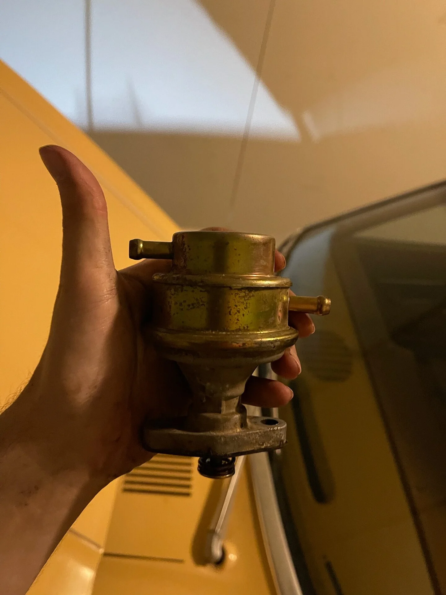

Anyone know where to find a mechanical fuel pump for 77 mustang v6? All I see online are a different one with wrong bolt pattern. Attached is a pic of it
Spectra Performance SP 1268 MP is similar (pictured below)
It has the hose connections both on one side
It is for 78 Pinto with 2.8
Play with the year to get the hose orientation you need
and yes the old Capri's had the same motors in them
Responding late as I never ignore a summons from @LILCBRA. :) Listings for the II with 2.8v6 are often wrong or just not there. Bronco II, Ranger, Aerostar, Pinto, Capri are all good bets. The 2.8 stayed pretty much the same through '84. I personally blocked mine off and replaced with an electric pump since I like something that will cold-start after a few months in storage without draining the battery and needed more juice for the turbo - always an option and not a bad one to modernize the car a little bit without the expense of EFI.
