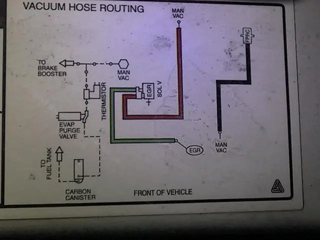

Vaccum Diagram
Here you go. Snapped from my 96 a couple min ago. Hope this helps.
FYI , the vac routing should be the same for a 2000 v6. Just that the EGR is in a different spot. If you need to know where a hose goes by location, just ask. I know the vac hose routing like a map.
