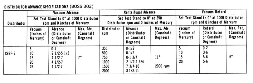

Almost all smallblock distributors had the same weights.
Here's the BOSS specs. I use the advance portions, and ignore the retard unless I am working on a BOSS distributor:
