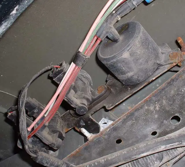

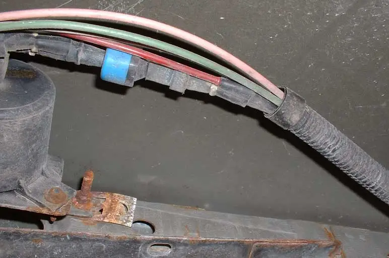

Here's what they run to.

They're electrically driven, but no other vac runs to them other than that 4 (red, green, white, pink) tube harness. Disconnecting them is no problem. Although I not using any of their functions, I'm going to leave them in there. They can't weigh that much (1 pound max), and I decide later to run an EGR or smog, they will be there. Most importanly, I don't want the electrical connectors to be open to the elements, corroding them. I'll just stuff the vac harness under there.
I actually found them for the first time last night. Always wondered what it looked like under the fender liner.
Rick
Go pull it off, it's easier than I thought it would be. I found a 7mm 1/4 drive socket in there on one side, and discovered a hole plug that had come out of it's hole on the other!
Rick
