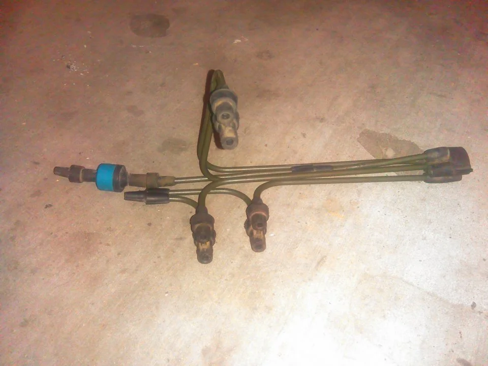

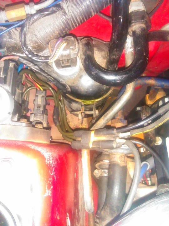

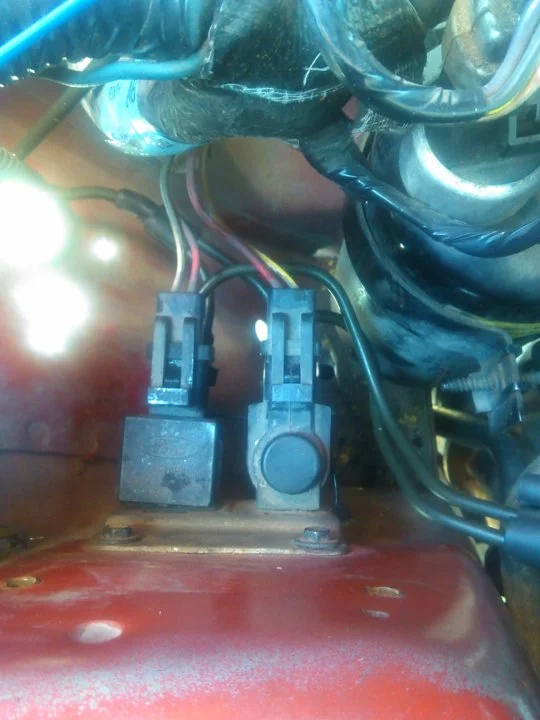

I have come up with a worry free way to eliminate broken and cracked vacuum lines from the vacuum reservoirs inside the fender to the solenoids on the strut tower. Use 5/16 brake tubing, cut, bend, and reuse the rubber fittings to connect to the solenoids. Here is a photo of what they look like.
