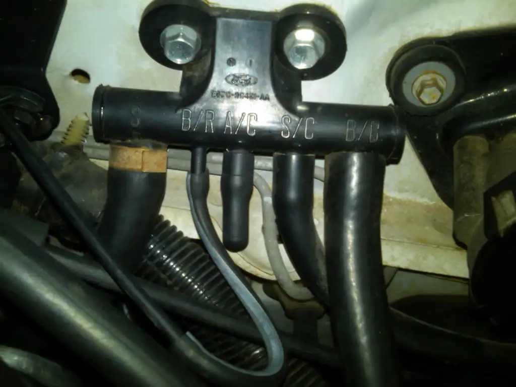

Engine Vacuum problem
Dirtnastyfox
Mar 15, 2019
14
Virginia
I’ll make this as short as possible. Basically I plugged off all my unused vacuum ports on the “vacuum tree” and it bogs down like it wants to shut off once it’s warmed up. But it runs good at idle. But if I pull a couple of them off it doesn’t shut off but idles down a lot and runs worse. Any ideas??

the car is supercharged and you randomly started plugging vacuum hoses? Why were there open ones? One was not the BAP/MAP sensor that you capped?
Take some pictures and post them underhood

The middle three lines on my car aren’t there. They were just open when I got it. This is not my car it’s just a google picture. But that’s basically what I did was cap all three of the middle ones and it rand good but after it would get warm it would shut off. Then I pulled a couple of the caps off and it ran a little rough but wouldn’t shut off or anything.

Well it’s been running great for the last few days. Apparently I was only running 30 psi to the fuel rail. Adjusted that and it runs great but still if I plug the vacuum tree that I’m not using it idles up and down and when you give it gas it shuts off immediately.
