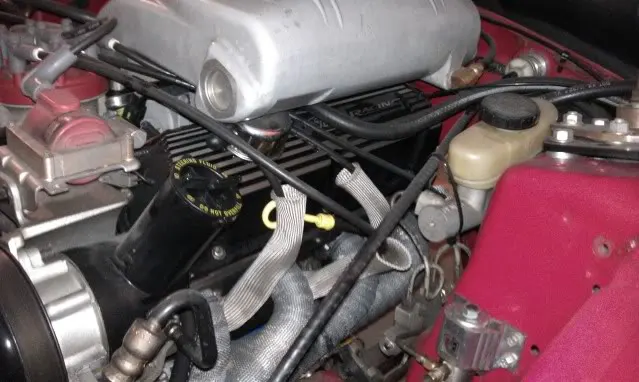

I've got the Summit brand '347 die-cast' covers, and they have bolt-in baffles on the inside of the covers. I have the pictured chrome trickflow breathers that simply push in the pre-drilled holes in the valve covers with the supplied rubber grommets.
Again, I have a fresh rebuild with almost zero blow-by, so your results may be different if you are running boost on a stock original rotating assembly that creates blowby....
