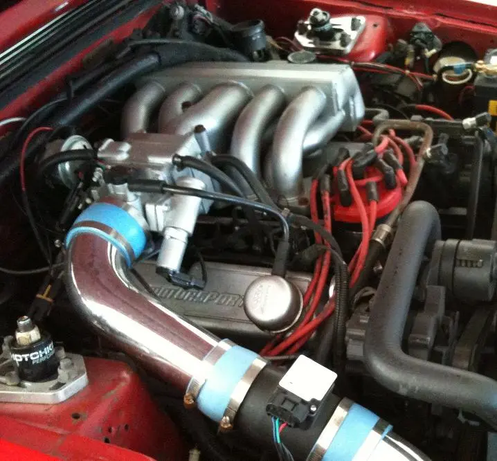

so why then does my valve cover to throttle body hose let oil into my TB and intake if the air is supposed to be going from the TB into the VC? It looks like my intake is sucking vacuum on my valve cover and pulling oil up into the throttle body, so my entire intake and EGR system is coated in sludge.
^That's not from your TB hose, it's the oil bypassing your PCV valve and making it's way into the intake. Check your PCV screen and the valve itself. Also make sure your lower intake is baffled. A very thin film of oil in the lower intake is relatively normal.
To the OP, most people use valve cover breathers if they decide to remove the PCV system (pointless in a N/A application) or if they go forced induction. At that point, most will typically install a remote catch can with a breather on that. Valve cover breathers tend to blow oil mist all over the place.
no, its clearly coming from my TB hose coming from the passenger side valve cover. When i look into the TB, i can see the oil build up coming from that port, and it has basically covered the entire upper intake and TB in black gunk.
Unless you're saying its coming up from the PCV and making its way into the TB past the open blade and into the tube... then id say thats crazy. How could the oil go against the air current when the throttle is open?
Original Poster- if you have a stock EFI system youll want to keep the pcv set-up and the original stock closed cap and line coming from the Valve Cover to the TB.
OooDeanisS-If you have oil in the TB it is DEFINITLY coming from the valve cover connection...or if you have a K&N filter it could be oil from it.
yea, its not the air filter, its thick black sludgy dry oil caked on everything from that port on the TB down into the intake. definitely coming from the valve cover hose. So... should i replace the cap or is that normal? i could get an oil separator but ive only seen them used on the PCV hose. As of now, i capped the TB hose and replaced the PCV valve and grommet, along with the crankcase filter.
heres a pic...
