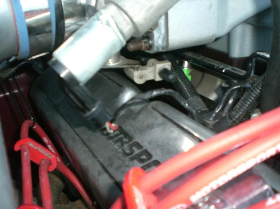

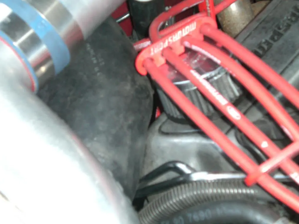

I have a '91 5.0 and I just installed an S-trim on it. I have trick flow heads and intake, 1.6RR, with a 1" spacer. I just installed an 70mm throttle body on it and the throttle linkage hits my tall Ford Motorsport valve covers. I also have a power pipe on the vortech that also hits the valve cover (the rubber boot that connects the power pipe to the S-trim to be exact). Does anyone know of a taller valve cover that will clear the Rockers yet not too tall where the throttle linkage and power pipe do not hit? I tried to install my stock covers without the baffle but they are still too small and hit the rockers. I'm not too crazy about grinding out the inside of the covers - I'd rather find nice covers with a baffle in it. Thanks for any help. These small problems I've been encountering are frustrating.

the throttle linkage should not be hitting, ive run a few different intakes with a 1" spacer and the same valve covers you are running with no problems. what intake are you using? can you take any pictures of it and post them on here?
I have the Trick Flow "street burner" intake with a 1" spacer. The throttle body is a edelbrock/BBK and it's linkage just hits the valve cover. If I had another 1/2", it would be fine although the power pipe boot still hits the valve cover. I had to put the 65mm throttle body back on until I figure out what to do. I'll see if I can take pictures to let you see how close the throttle body is with the 65mm.

Can you post up some pics?
I do have the thicker rubber gasket on there although it seems as though I would need a little more room even if I went with a thinner gasket. Here are the pics of how close the 65mm throttle body is (which is fine) and the power pipe rubber boot that hits. The 70mm throttle body only sits down another 1/4" - 3/8", but it's just enough to hit the valve cover.
