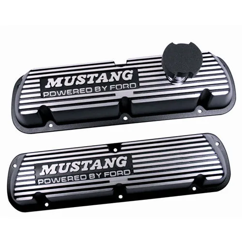

TFS-51411801 valve covers
TFS-51400800 oil fill neck
But I've always liked these too. Description says these are taller, so I assume they will clear as well
M-6000-E302
Any direct experience or opinions on one over the other? Cost is about the same considering I need to buy the oil fill neck for the TFS covers and install it. Like I said before, I'm already running a 3/8" spacer on my Cobra intake, so they should be enough clearance I assume?

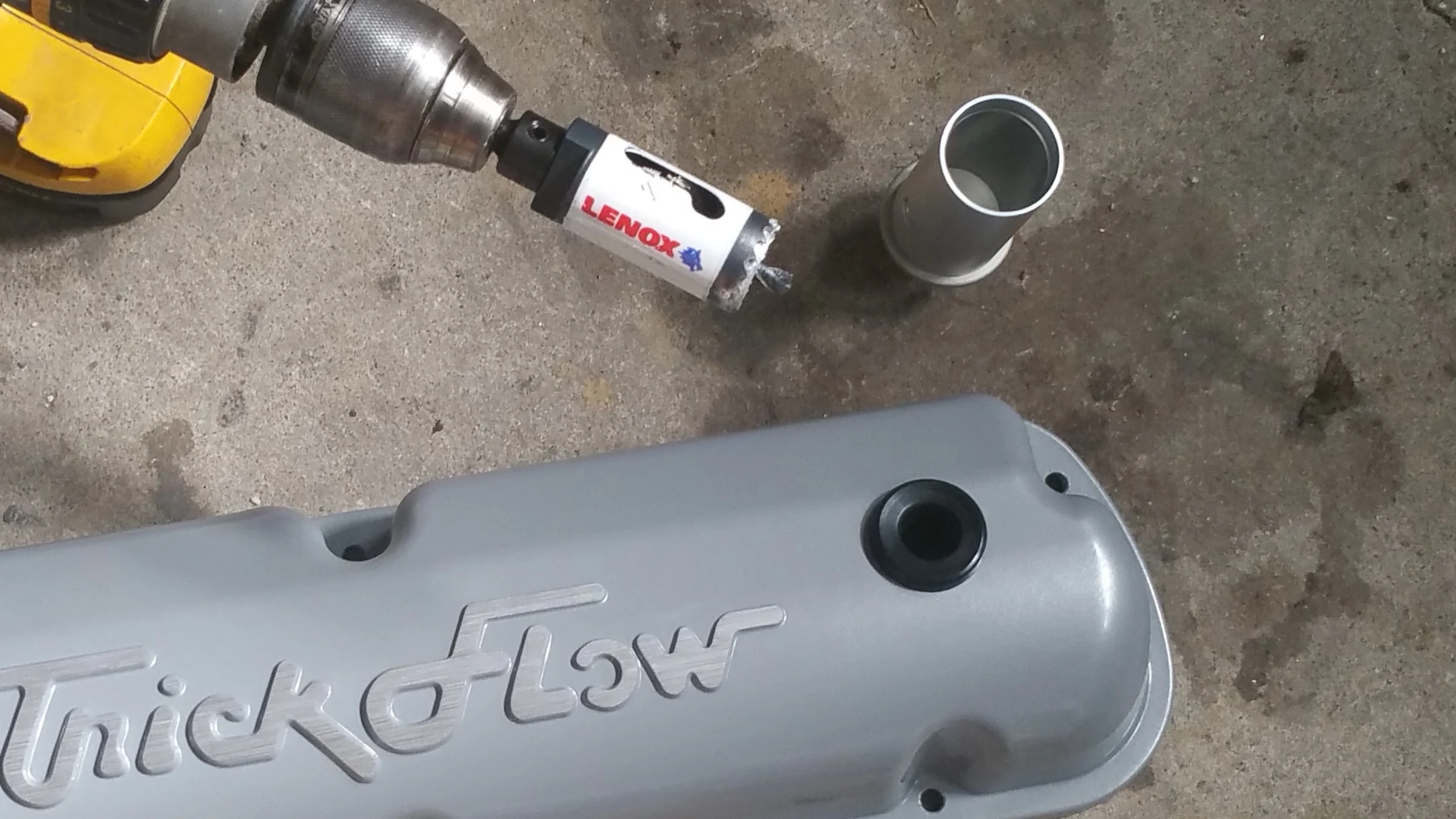

I know the tfs covers will clear, but you will need to drill for the oil fill/vent and there's no baffle.

How difficult is installing the oil fill on the TFS heads? Does it need to be located in a specific spot to clear the rockers, or just drill where i please (within reason)

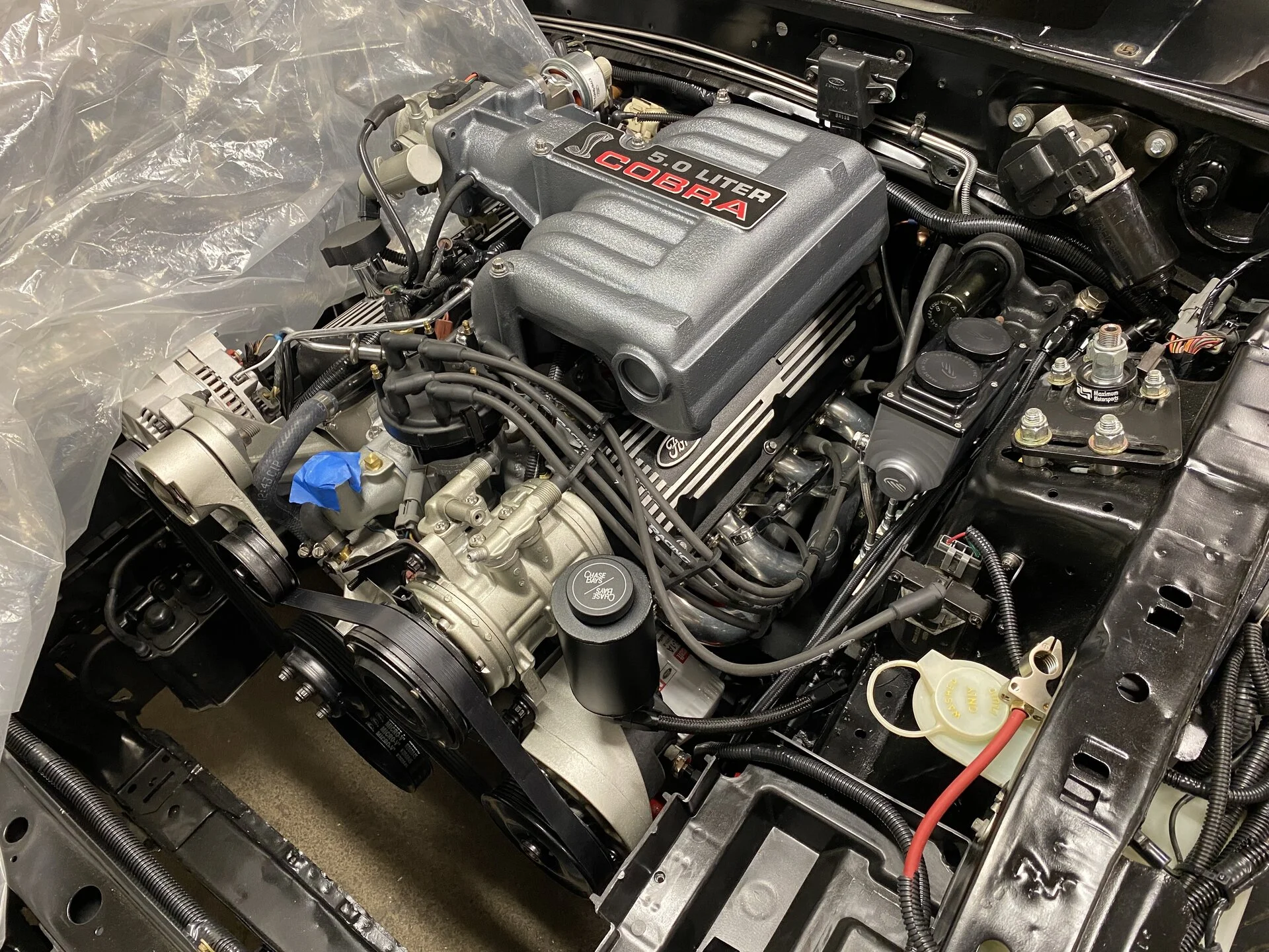

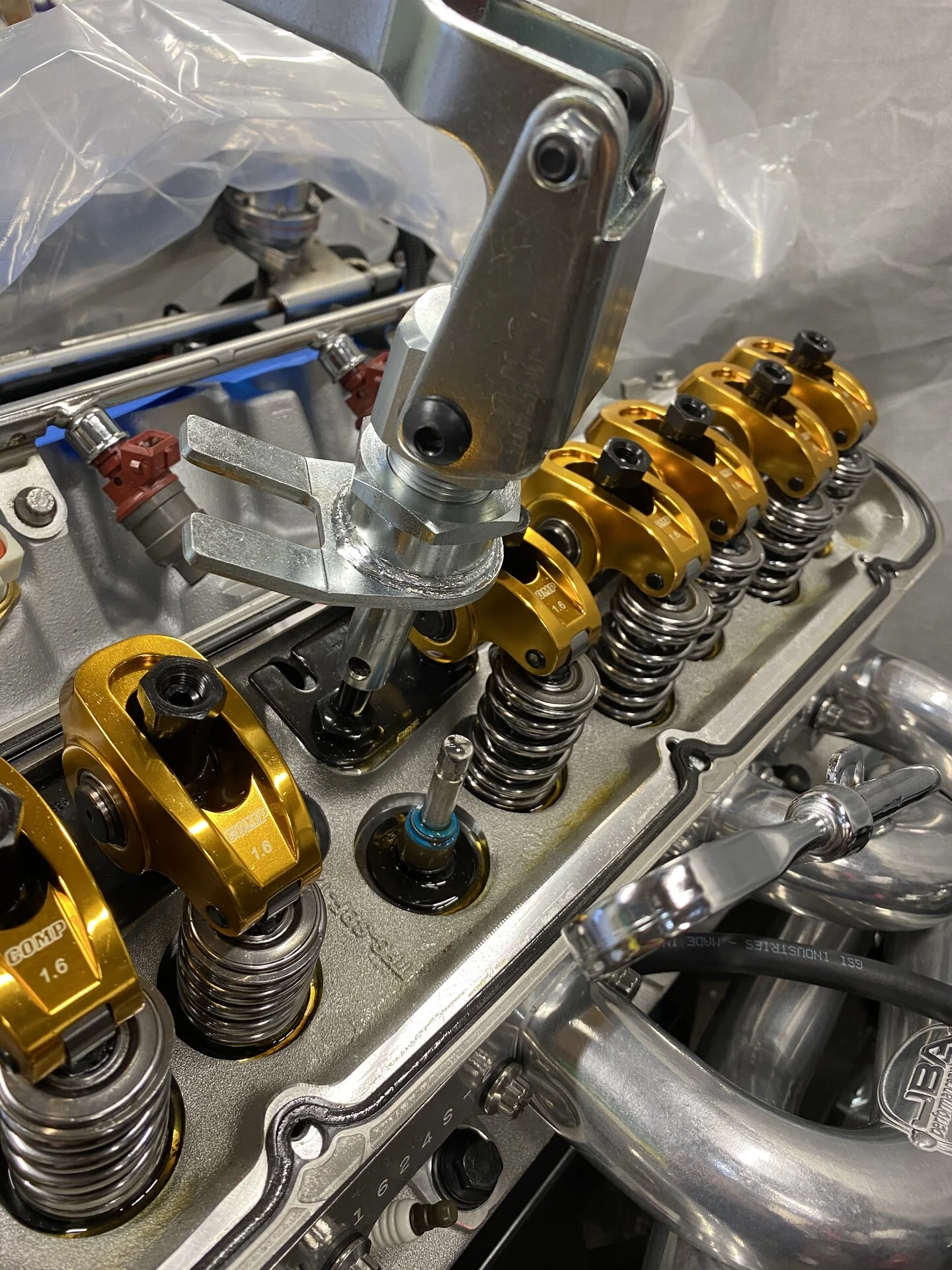

What I ended up doing was the Ford Racing valve covers. I had to remove the internal oil fill baffles and grind down the casting bosses on the inside to clear my Crane Gold 1.6 rockers.
For the intake, I needed a 3/8” spacer to allow the throttle bracket and the drivers side PCV fitting to clear
Should clear the stock hood. I say that because I have run the 3/8” spacer and this intake and it cleared fine. The only major change however is that I went from worn 1988 engine mounts to new energy suspension poly mounts. About to confirm if the stock hood still clears

They clear some. For my stud-mounts the interference wasn’t on the rockers themselves, but clearing the actual tops of the studs. It’s was only 1 or 2 that actually made contact.
Pedestal mounts might be perfectly fine.
Here’s what hit. The boss along the center line was contacting. Like said, only 2 actually hit but I took my grinder and took down more than needed just to be sure. After grinding, need to really clean the shavings out.
With a 3/8” intake spacer, here’s my clearance.
If i slotted the throttle bracket, and eliminated the PCV connection under the plenum, probably could have gotten away with no spacer.
