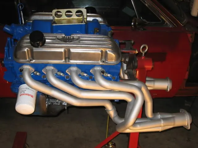

Back in April I put TFS Twisted Wedge heads and a cam on my 351w in my 68 Coupe. I have M/T valve covers and I really like them and have no desire to change them but I had to remove the baffles for the roller rockers to clear. But now they're pushing oil out of the breather cap. I know that the baffle will stop this, but to run it I with these valve covers I will need a spacer. I've seen them before but for some reason I can't find them now.
Does anyone know where these can be found?
