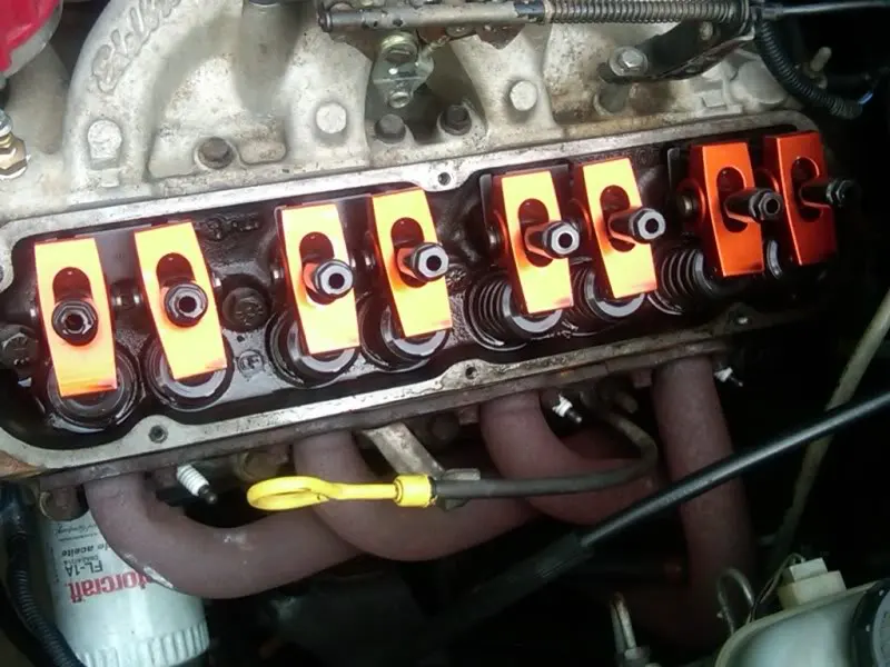

I'm about to figure out how to get my stock Powered By Ford covers to clear my stud mount rockers...i'll probably be running the thickest gaskets i can get my hands on. I'll post up pics when i figure it out.

To be honest, I'd never pulled the covers till yesterday. I didn't build this engine so everytime I go into it a little more I learn a bit more. I'm fairly sure the rockers are Harland Sharp. I've taken this engine over 8000 before the valves started floating. I won't be doing that again btw :lol:

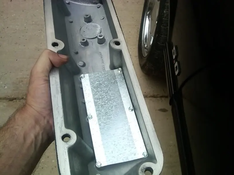

Here's the underside of one of the FR covers. I removed the baffle and set the cover on the head, still over a half inch gap because of the three bosses on the other end, and the tops of the rocker studs are touching the inside of the cover. I started grinding away at one of those bosses with a Dremel. I ground at it for 30 minutes, didn't get that far and there's 5 more to go :lol: so F it, I'll just get some spacers and put the baffle back in.
