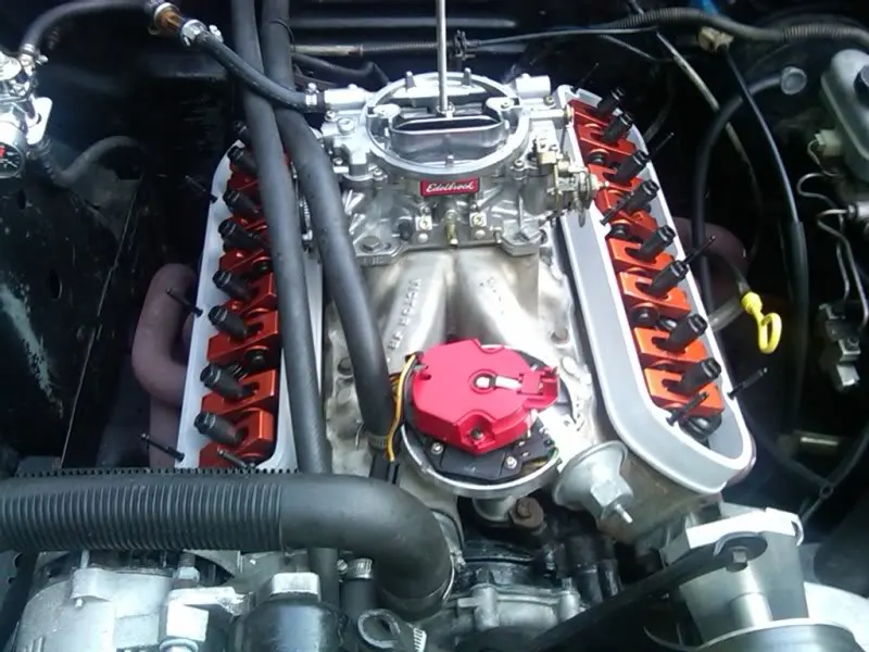

Stever89 said:
I'm looking into this. At the risk of sounding ignorant (too late ) what do they do, and will they cause even more clearance issues with the covers?
The tall polylocks (locknuts) on your roller rockers are designed to use with these girdles. The girdles stop excessive stud deflection that happens at high rpm's like 8k. You don't HAVE to run those tall polylocks, but in your case, I would. With the girdles.
Whoever built that engine knew what they were doing, and probably had girdles on there, but pulled them and sold them seperatly when the engine /car was sold. That happens a lot, I've noticed.
Look into tall valvecovers that clear them.(or keep the ones you have) Summit carries them among others. Function over form!
You know, I think you're right. If you look you can see where they rubbed a bit of the finish off the rockers.

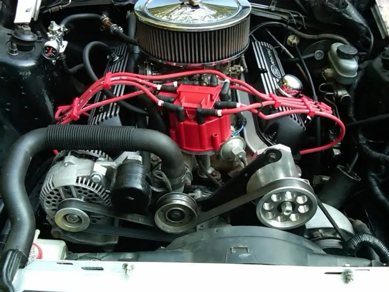

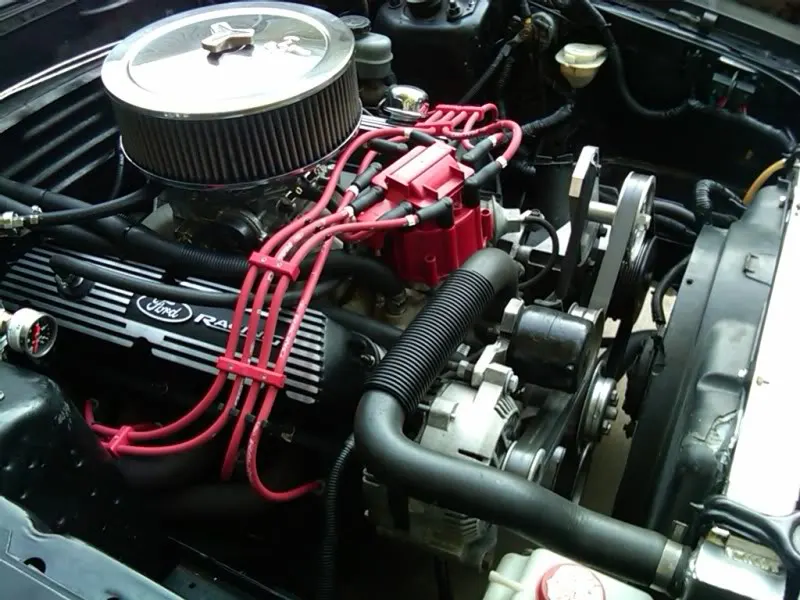

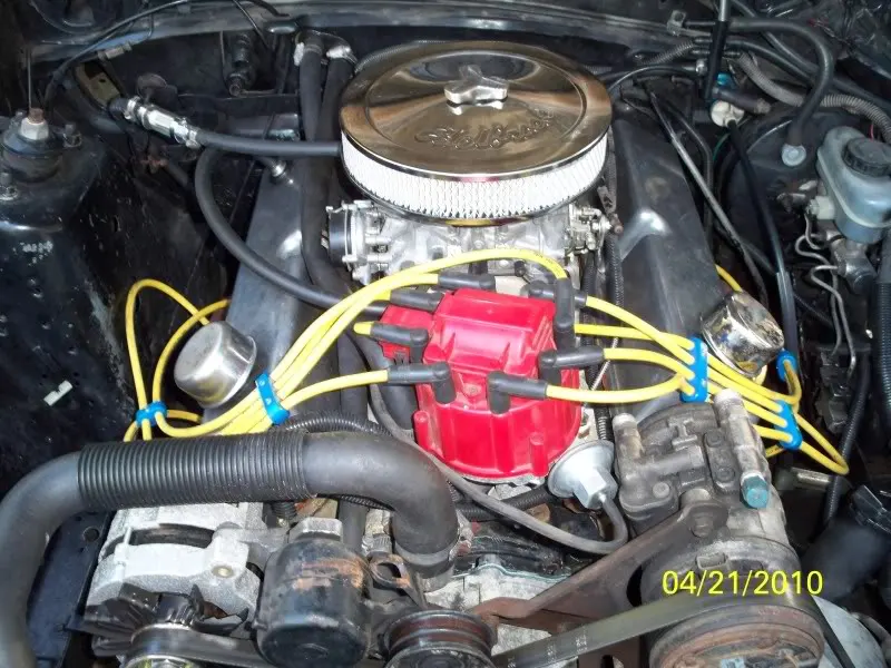

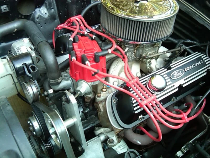

Got the spacers.
Covers on.
Quite a change from this.
