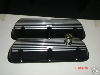

I can personally tell you that those valve covers suck. Teh chrome doesnt last and they are made out of very thin metal. So thin that you will have to buy shorter valve cover bolts because the stock ones will bottom out. Look around i got these for 40 bux on ebay and they cleared my 1.6 scorpion roller rockers.

now THATS what i want :nice:
