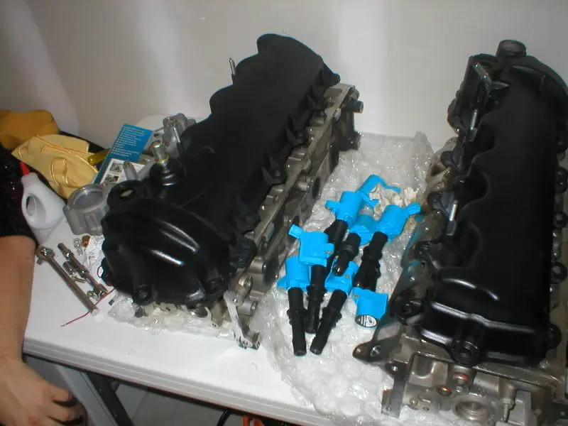

Those are my friends 2v pi heads they are sitting on btw.

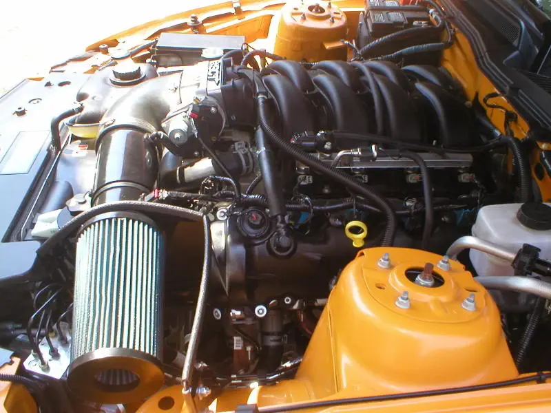

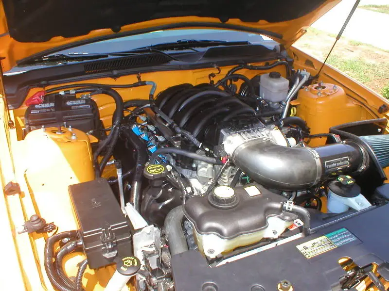

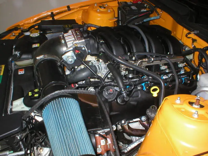

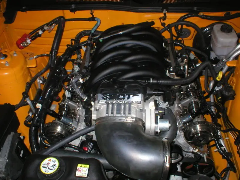

Before:

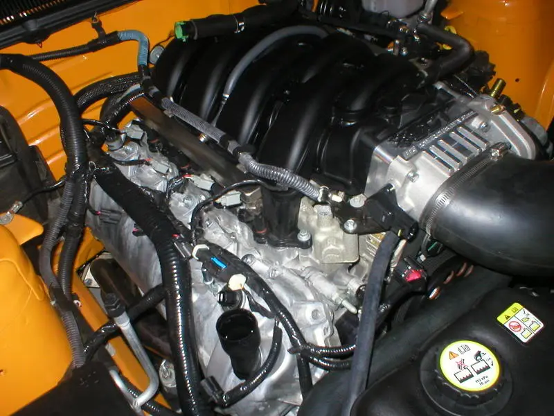

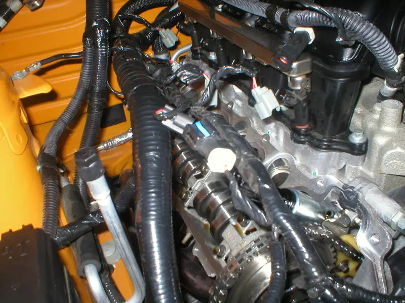

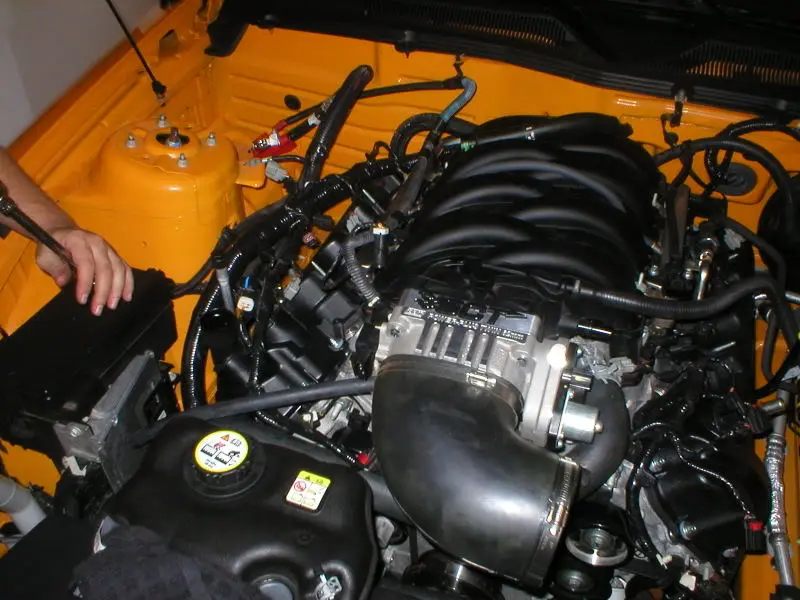

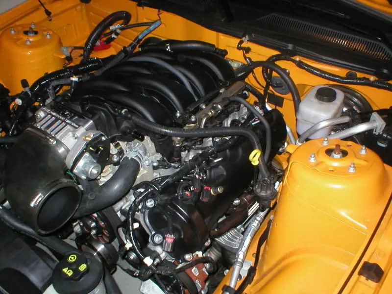

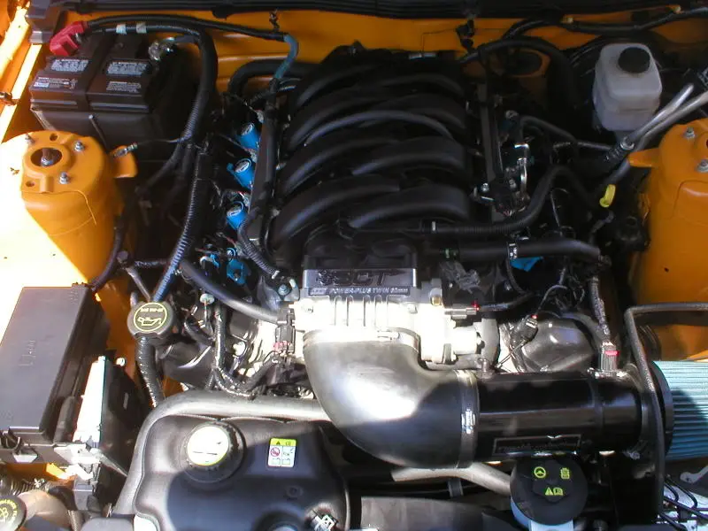

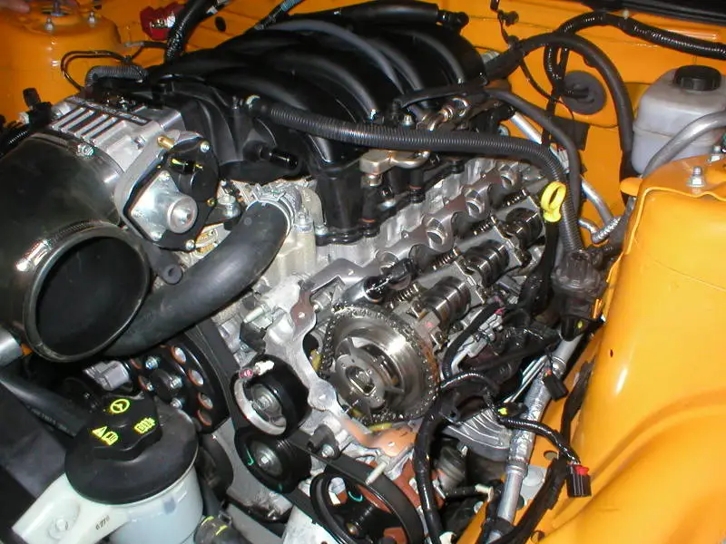

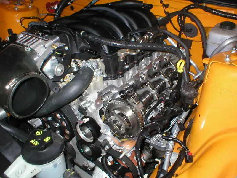

The process:

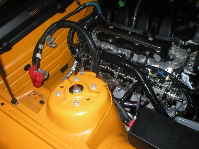

Had to remove the battery and battery mounting box to remove the passenger side valve cover

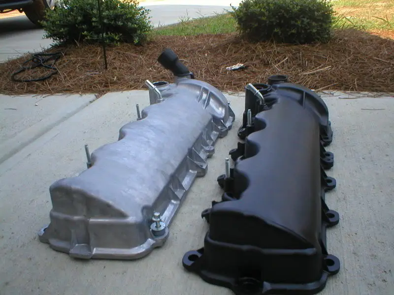

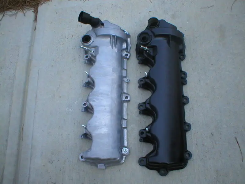

The 3v has c-clamps not cam ladders
The black one is oem off and 05 GT, notice how ford did away with bolt hole locations on the 07 valve cover, although the heads suport all the mounting holes, weird.
