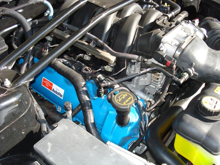

Jpplaw is correct - you can also re-use the gaskets (if you have low miles -if high maybe buy new) - but let me give you my own two cents - I painted mine old pre - 73 FoMoCo blue engine temp paint when I did my cams - Don't just try and just 'brush on' some paint by hand with them still installed - I saw this at a car show one time (the guy was actually all proud? ) but it looked really stupid and amateur - take your time - do it right

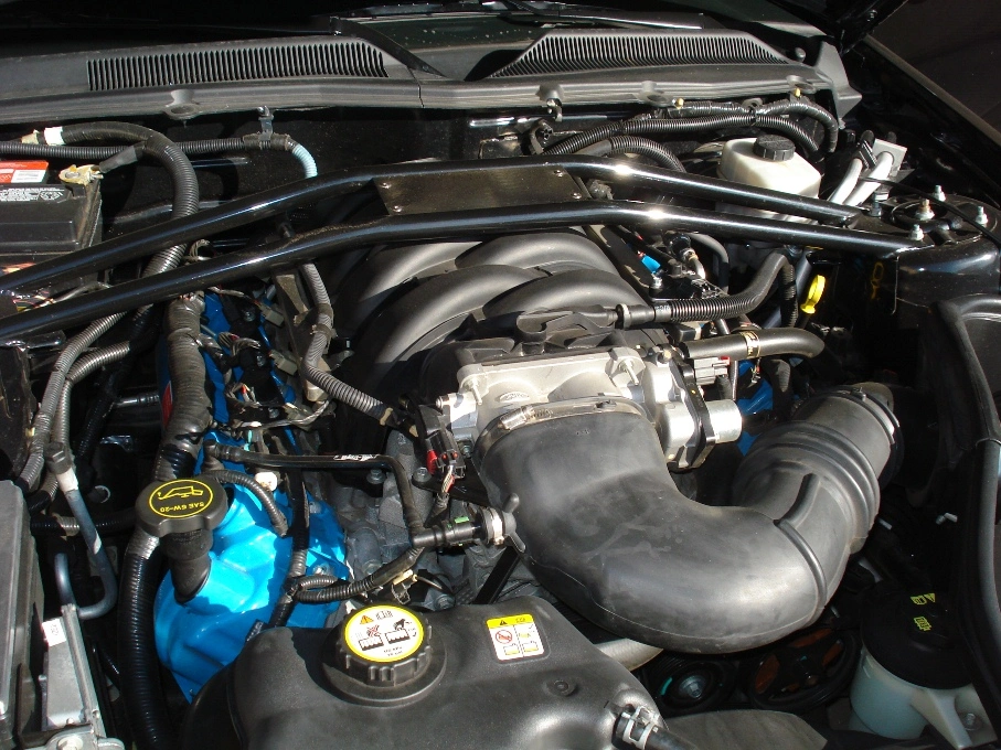

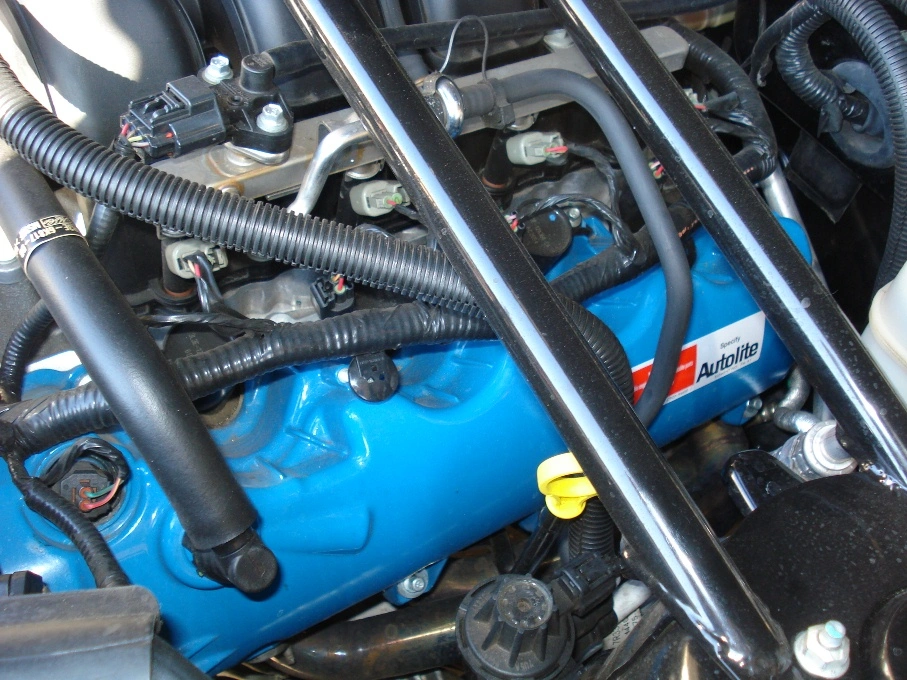

I degreased them / took the bolts out - sanded them with a 3M red pad / light prime coat (re-sand with 1200 - any imperfections)/ taped off the oil spout / layed flat and light misted a coat - firm second coat and a final firm coat ....Let dry - they look great to me - even added an old school Auto-lite sticker for fun -
Thanks Mike - There's a few guys on here -who have pulled the 'whole' 4.6 motor and then painted it the old school blue after a rebuild (looks awesome I think) - the autolite stickers are reproductions from a 429 Cobra jet you can find easy on ebay - I liked the larger size -

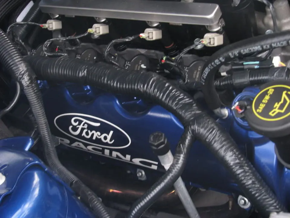

I painted my 351 W I'm building and sprayed it in the darker corporate /after 65' Blue
310352_2018589836596_1599416733_31671419_1774818627_n[1].webp 317126_2018592396660_1599416733_31671420_1398096300_n[1].webp
- I may buy another 302 roller motor and paint it the older school blue like the 07' valve covers .....but that's way down the road -

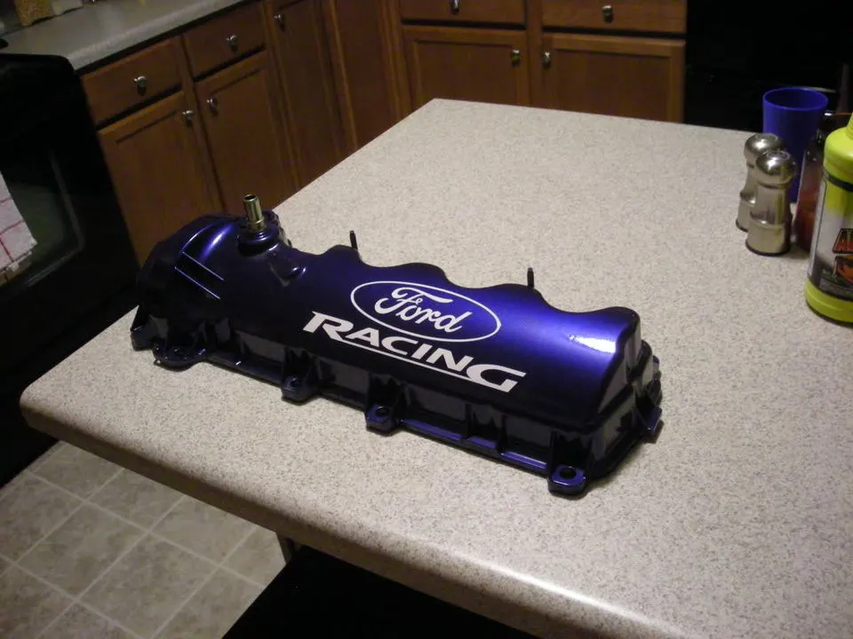

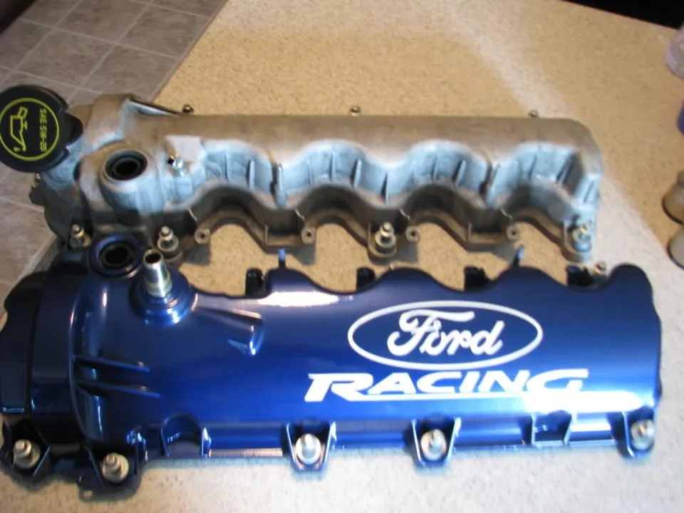

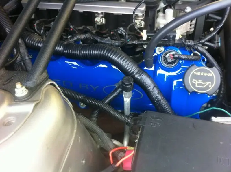

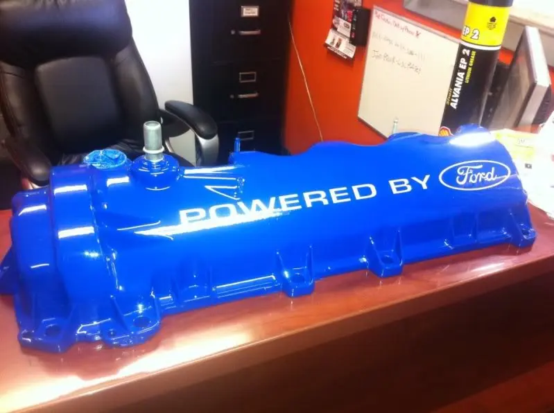

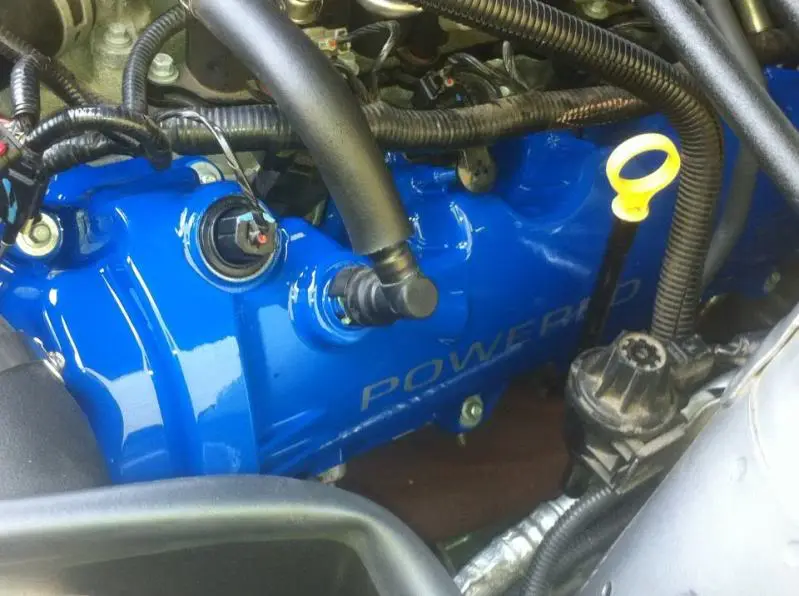

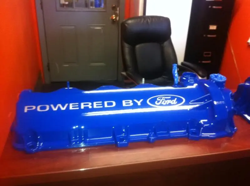

I used high temp dupli primer (about 3 coats) the rattle can of dupli color Sonic blue and about 4 coats of the VHT High temp engine clear. i put the stickers between the paint and clear. TAKE YOUR TIME SANDING AND PREPPING THEM!
