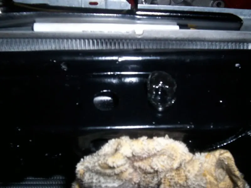

Well, i got it all done today, all the old seals felt hard and brittle, you could see cracks in them, replaced all of them and readjusted the valvetrain. It went very smoothly, no mess-ups.
Heres what some of them looked like, this one was chewed up and split in half:
