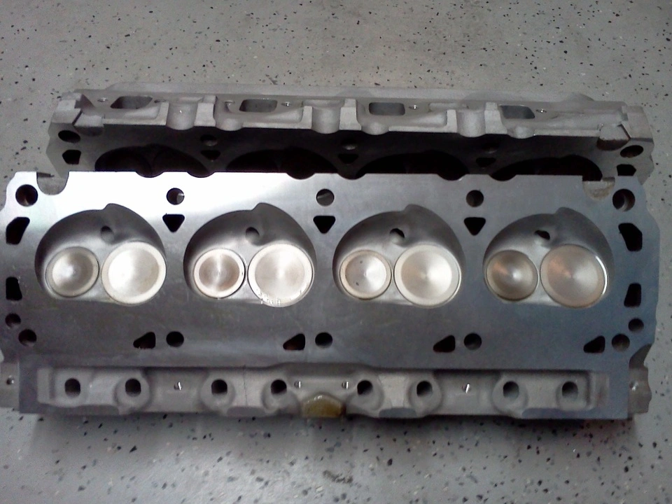

Yeah, the heads themselves have been recently rebuilt. I picked them up from a reputable member on here last week and just waiting for them to ship. They were decked (minimally), with new guides, and valve seals. His machinist apparently "checked" the valve springs as "good" and a valve job was performed, but I don't know the exact details. They've also already got minor port work done to the exhaust side.
I plan on disassembling them and checking the over again and doing a little work of my own to the ports, throats and bowl areas. I know by reputation that these are kind of a middle of the road head performance wise as it is, so it's gonna need all the help in can get trying to feed a 331.
I know there's more power to be had with better heads like Trick Flow or AFR's, but I like the idea of staying with the Ford top end components and I figured for the price (less than half the cost of a new Trick Flow or AFR casting) it was tough to beat.

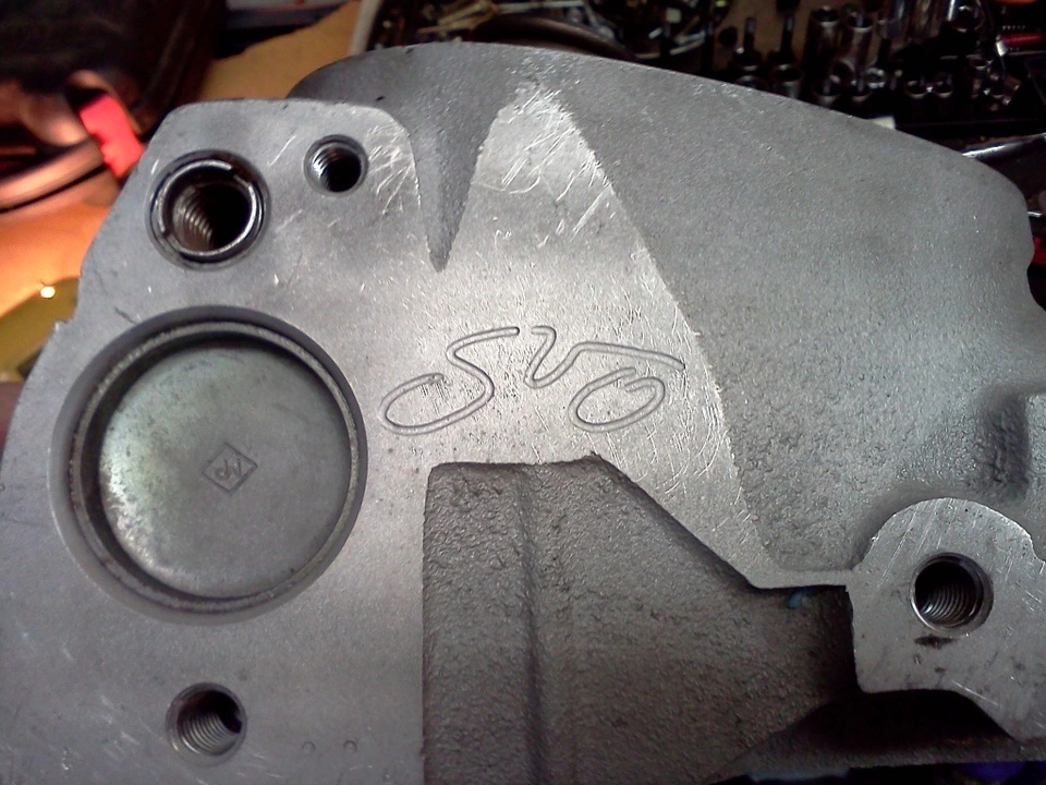

you should take some time and clean up the casting flash in the runners
Yeah, they're going to get a going over.
Does anyone know what kind of material a person has to work with in regards to the runners and throat area? Is there a lot to work with, or are the water jackets just ready to burst at the seams at the mere sound of my carbide cutter?
