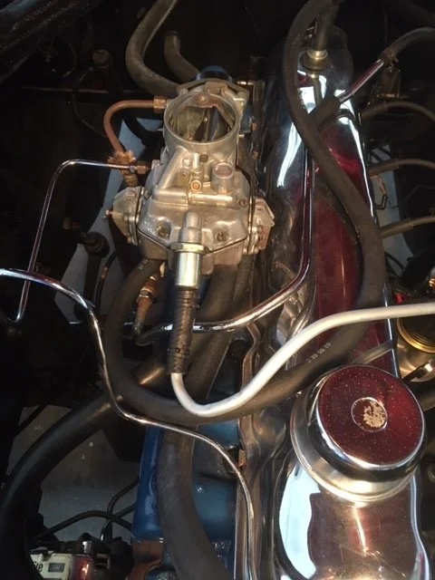

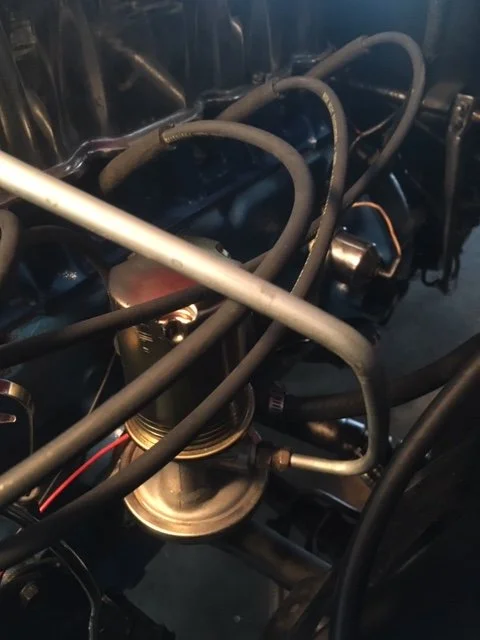

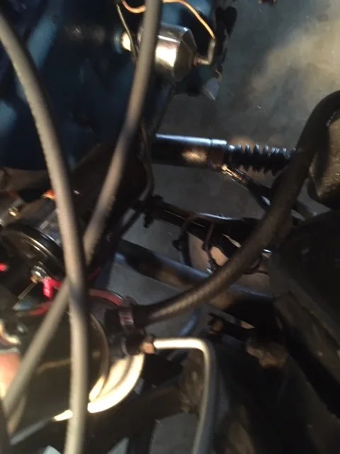

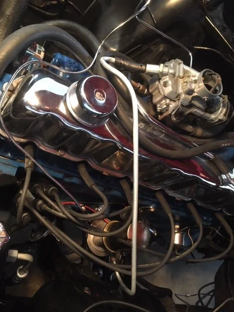

Can you post a pic of the current setup showing the fuel pump, hard line, and cab connection? I agree with wicked93 that the issues isn't the fuel line, but I'd like to see what the fuel line is close to.
I have attached the pic's

Pretty sure my 200ci had a rubber hose instead of a hardline there when I removed it...not that that means anything, but I definitely wouldn't put a braided stainless line there...those plug wires will be rubbing on it constantly.
