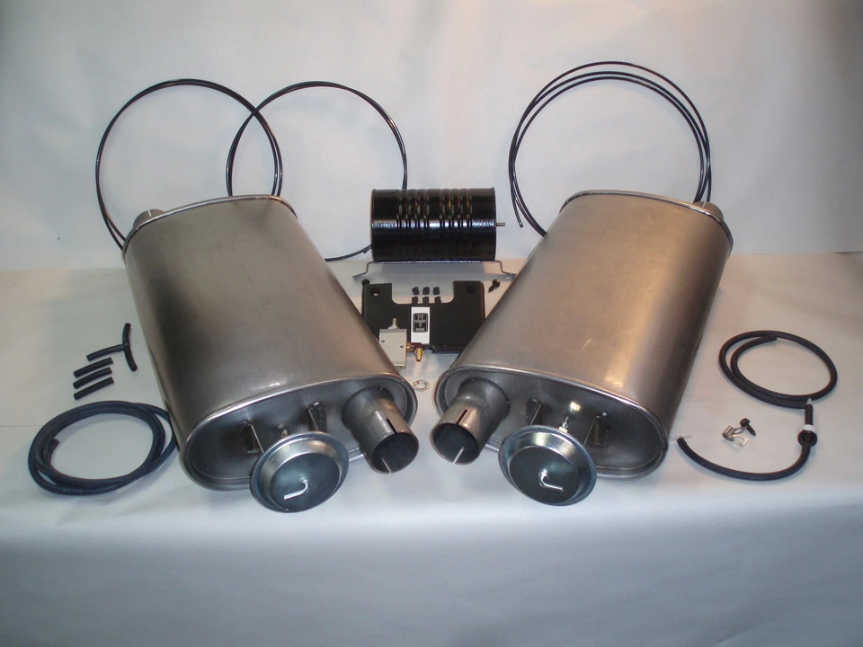

ford racing makes dual mode mufflers with a spring loaded valve in them, at idle and normal driving it goes thru the muff when you punch it the trap door opens and its a straight thru muffler. I havent put mine on yet.

2+2GT said:
Actually, his question said NOTHING about cutouts, at all. He was asking about variable mufflers, which, by the way, all Corvettes have had for years.
uh no thats not correct, there was nothing like that on any C4 or C5 corvette, and the C6's ('05 and up) have an option for a dual mode muffler.

What part of "out" don't you understand? Internal is INside the muffler, cutoutss are OUTside the muffler. By your definition, any straight-thorough is a cutout.
Um....no, the word "out" when referring to exhaust cutout implies an alternate route used to remotely bypass the primary exhaust system.....a secondary means of cutting out the middle man (sound deadening material(s), resonator(s), converter(s), etc) from the equation, so to speak.
The definition is not dependant on the placement of said junction within the exhaust system. Whether the placement occurs right off the collector, before the converter(s), before the muffler(s), or occurs within the body of the mufflers itself has nothing to do with the interpretation of its definition. Its definition is however soley dependant on whether or not a secondary routing exists.
A strait through exhaust is just that...a strait through exhaust. There is no secondary system or bypassing involved since a strait through exhaust is a singular exhaust routing, with no secondary involvements.
Get it now, or do I need to draw you a picture?
You mean like the picture I posted above of exactly such mufflers?
Sure, if you want.
They're built as a vacuum operated exhaust design...I would imagine similar to (and probably a more refined version) that of the short lived design of the early 70's Pontiac GTO. In one mode, they run full baffling and sound deadening and in the next (presumably with the flip of a switch, or pull of a cable) the system redirects the exhaust path is via the vacuum operated valve to an alternate pathway within the muffler containing either reduced baffling or sound deadening material, or depending on how you'd like it set up....none at all.
This is the exact same concept as the traditional exhaust cut out, only its done so within the confines of the muffler itself. Same ****, different pile. I really don't see what your argument is here?

well since you are such an ass let's look at things this way.... he wants a MUFFLER that is internally bypassed but still runs through the full exhaust system, your suggestion of using a cutout would in most cases mean that the exhaust would exit the cutout BEFORE the rest of the exhaust system, thereby actually being louder than if it ran through the exhaust system. all the bends and curves and even the tubing itself reduces the sound level as the exhaust passes through, which is not the case when using cutouts before the mufflers unless you run a seperate exhaust system out to the back of the car which is really stupid.
BTW, there is another option for a muffler with an internal bypass to change the sound level that is a good bit cheaper than the repro GTO system from Waldrons.
VaraFlow Tunable Muffler
They also offer Smithy's, a type of muffler used on many early Corvettes. It's straight through, but not a glasspack, it uses baffles. Pretty tame at idle and low power, but gets loud when you stomp the gas. That's my idea of a variable exhaust, controlled by my foot.
