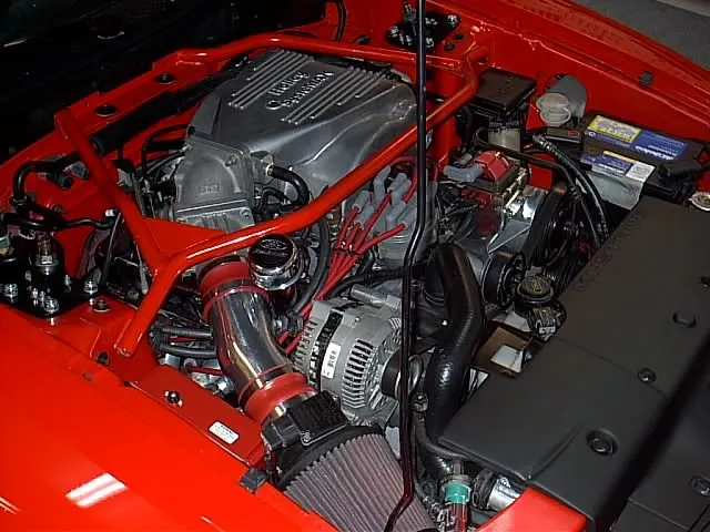

You can see all three here.

Same wires and same problem. However I had this problem with the 9mm ford wires and the Jacobs Ceramic wires. I am running a crane hi-6 w/ an LX 92 coil. DOnt remember if it did this with the stock stuff. However I am running about a .065" gap on the plugs and I think thats where the problem might be. And like you said in the daytime its fine but when you turn the lights out and pop the hood I see faint little sparks going everywhere. I havent bothered w/ it too much as I have not had any drivability problems from it. Although I think that there are so many sparks and a lot of juice going through the wires that I'm still getting plenty to the plugs.
