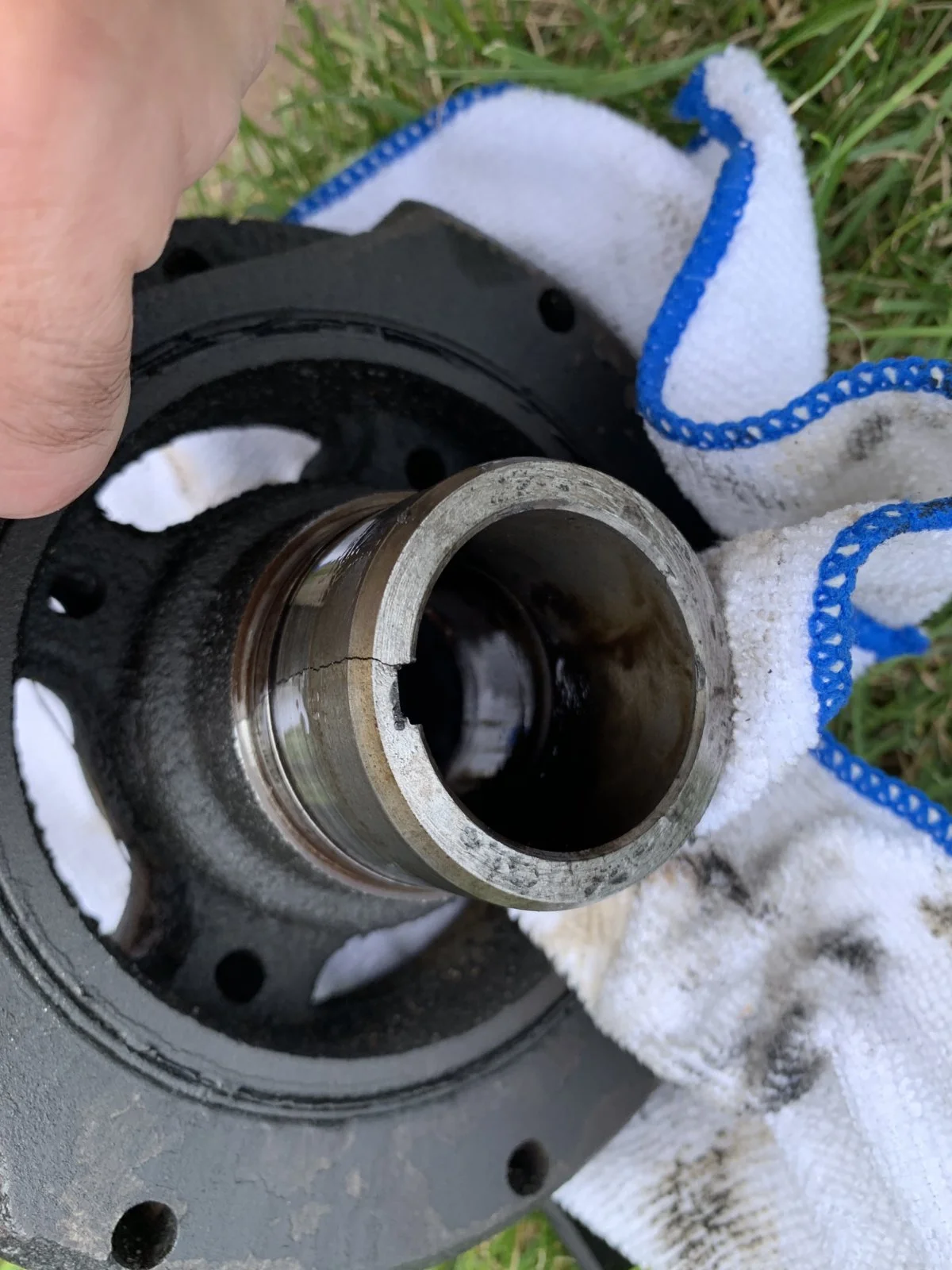

So it ended up being the harmonic balancer snout was cracked in the key way area! The supercharger was making it worse! Thanks again guys
