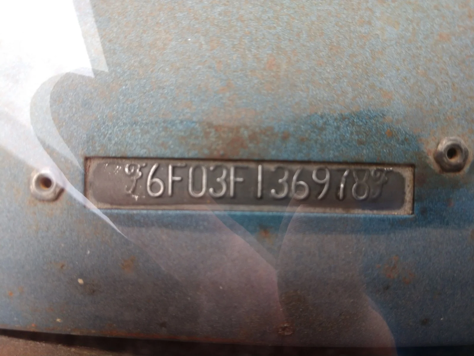

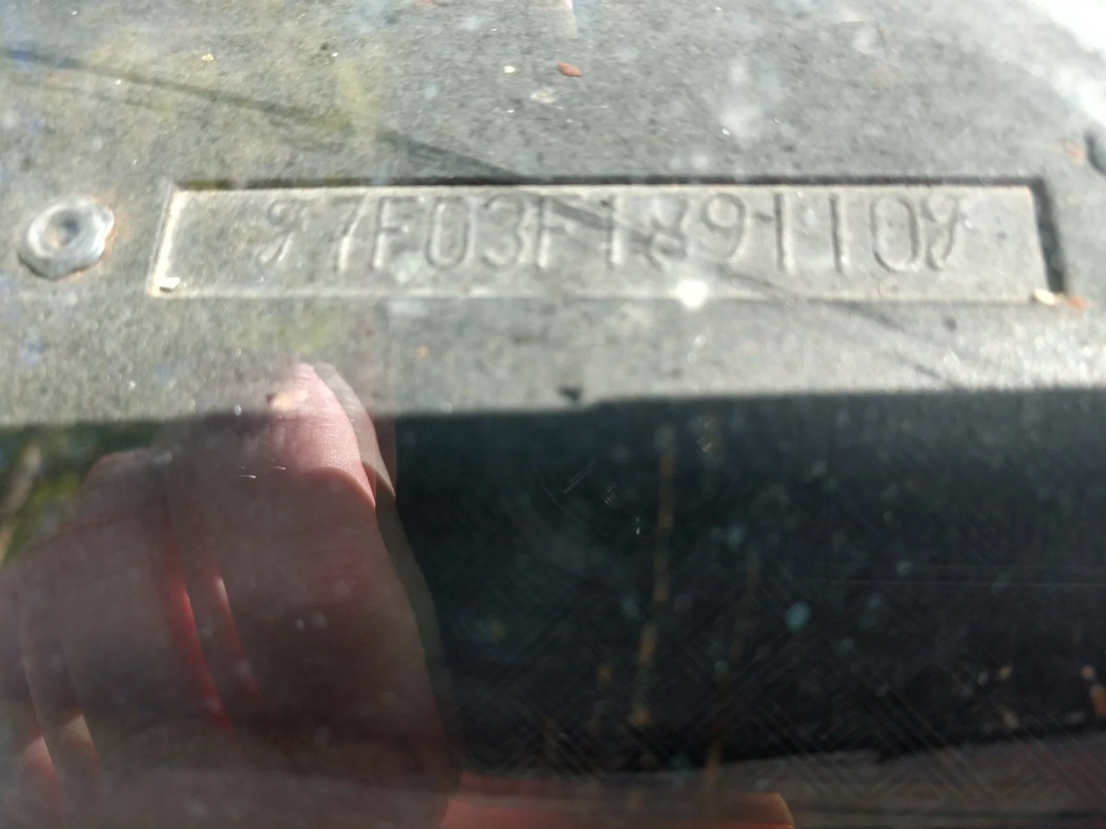

Anybody have the skinny on VIN decoding?

Going from memory, the first number is the year, so #1 is 77, #2 is a 76. 5th digit is the engine code, F is a 302. I don't remember the other 2 offhand, I think the 4 cylinder is a Y? All I was ever concerned with was the F, so I never paid attention to that one!! :cool: And if memory serves, everything after the 5th digit is the consecutive number in production. I'd have to use a decoder for the 2nd, 3rd, and 4th digits.....

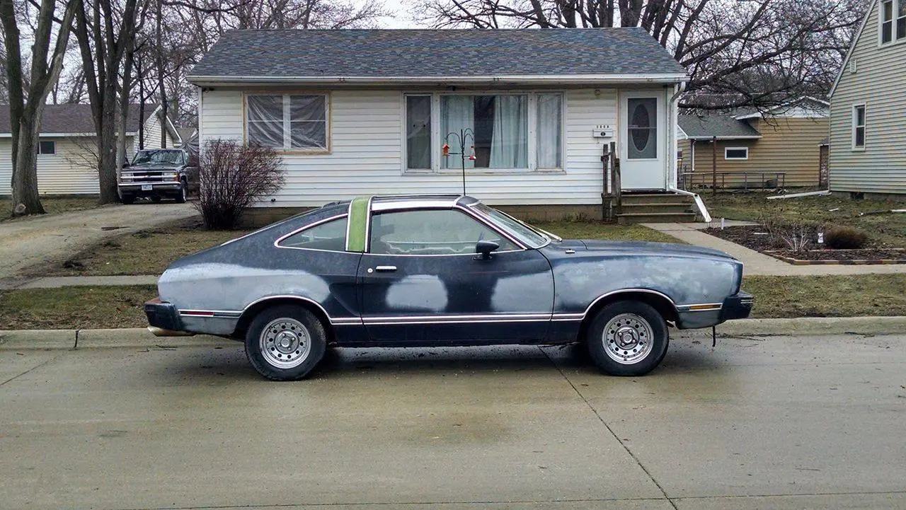

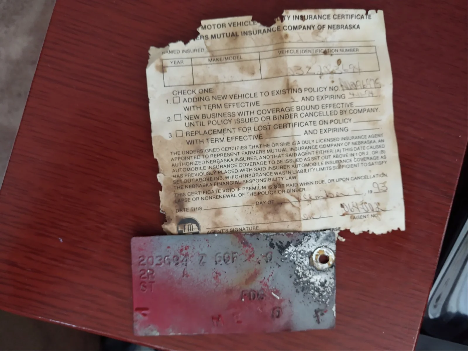

Well, it's hard to say what updates I should go with.
The VIN that begins with the 6 is in a dash that isn't even bolted into the car.
The Buck Tag was on the car and it leads me to believe that the car is really a '78, rather than the '76 that the dash VIN decodes as.
I found an old paper insurance card with a VIN hand written on it that the sequence number matches that on the Buck Tag.
The split rear seat of the car also suggests that it is, in fact, a 1978.
So, the car is supposed to be a V6 4 spd, but is currently a cobbled together V8 auto.

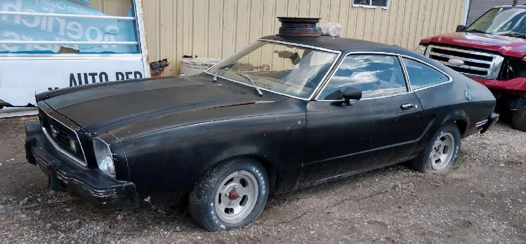

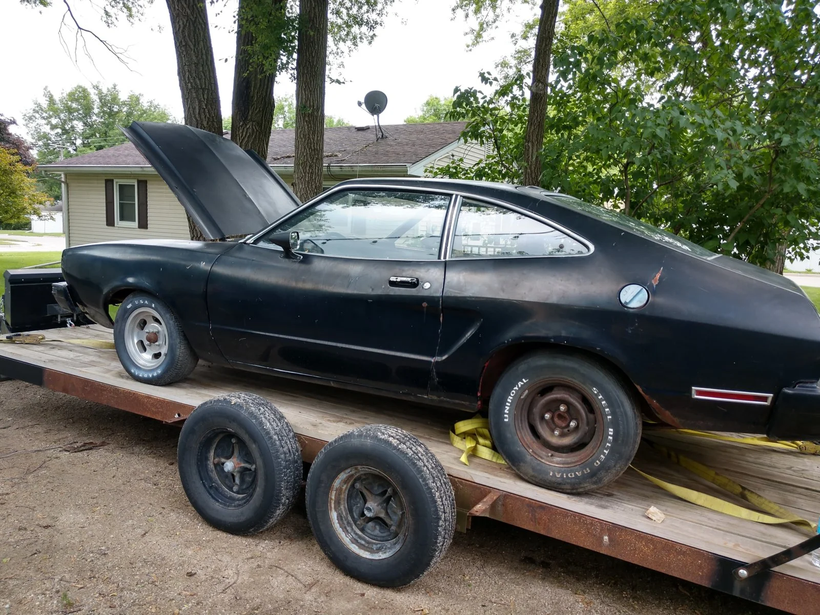

I bought this car as a parts car, but after cleaning it up and tearing out the destroyed carpet, I can't do it.
The ONLY rust I've found (so far) is a small patch about the size of a 1/2 dollar in the passenger's side floor.
It's just too solid to ruin it. So, now I have to see about getting a bonded title or something.
I want to get this thing together and use it as a daily driver.

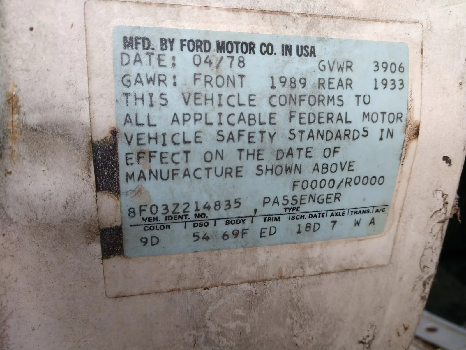

The VIN that begins with the 7 is in a dash that was bare bolted in. 3 screws.
That VIN doesn't match the door tag or the Bug Tag.
The door VIN, Buck Tag, and the VIN tabs under the front fenders confirm the dash is wrong.

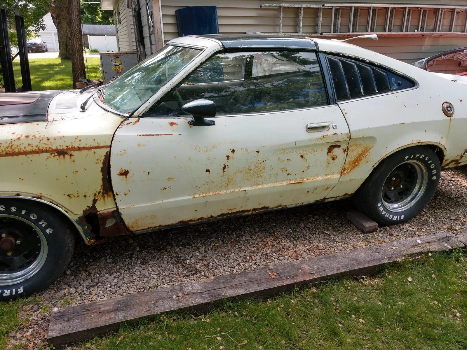

This car turned out to be a 1978 Cobra II. A billboard car. White with red interior.
Currently it has black interior. I was able to salvage many parts, but the body has had it.
It suffered a front end collision at one time so the driver's corner is crumpled up in the frame rail.
There is very significant rust through the entire floor, up into the firewall, and up into the door jams.
The hatch/spare tire area are pretty solid and the t-top roof is clean, so I'll save those.
It was a V6 auto car, but is now a V8 4 spd, so those will be saved.
The dash shell was completely unmolested (radio opening), so that will probably go into the other car.
Sadly, the billboard car is junk (as far as I'm concerned) and the car I wasn't even really interested in buying is a keeper.

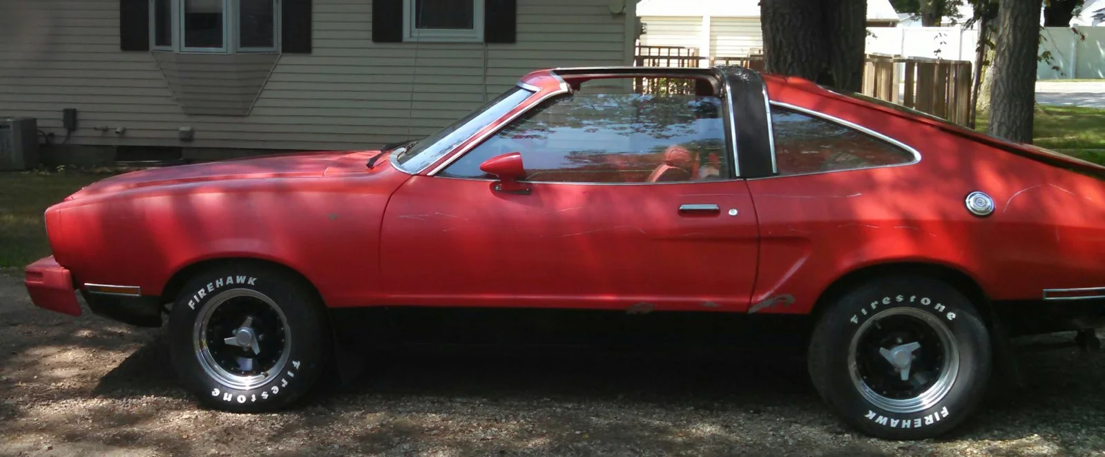

The project car.
The original project car that became the parts donor.
The white parts car. Right where I found her.
The "parts car" that became a 2nd project. :)

I told him where I found it and what the guy that had it had planned for it. He didn't seem happy about that. Then I showed him a picture of what the car looks like now. He said he always did like that car, but "It looked better in red!" :D
