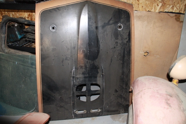

could be a mach 1 or even a G T they were both available with a 2 v 302. i have a 69 fast back GT with a 302 2 v that was special orderd with the under hood ram air and mach 1 hood scoop the color code was j 5 for gulfstream aqua with a black out hood
the hood is factory punched out for functional ram air.

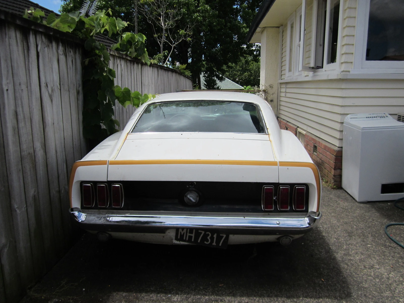

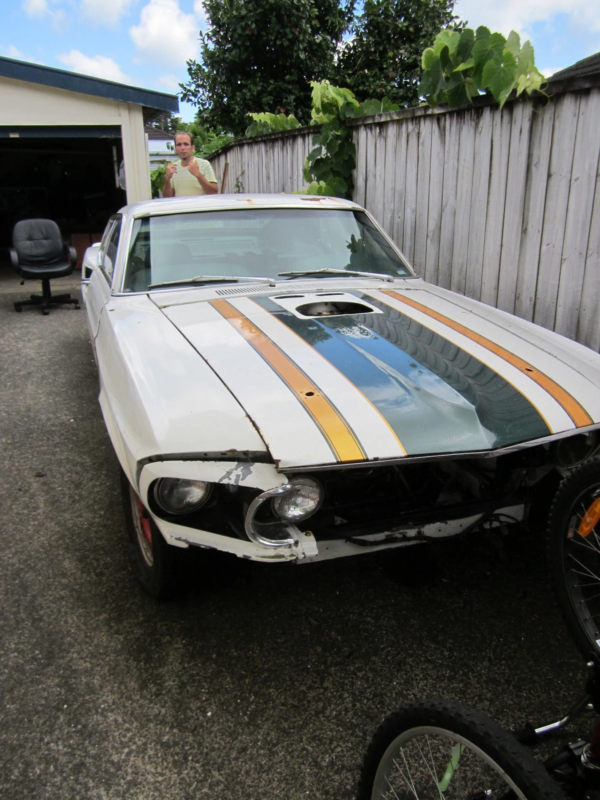

and a repaint.
It looks as it had a functional hood scoop and factory cut outs, I'm not too sure what they look like tho as its my first classic Mustang and it has the wiring for turn signals in the hood.
A couple of more knowledgeable restorers have had a look for me and have said its a really weird spec. 69-70 Mustangs are really rare over here and very expensive.

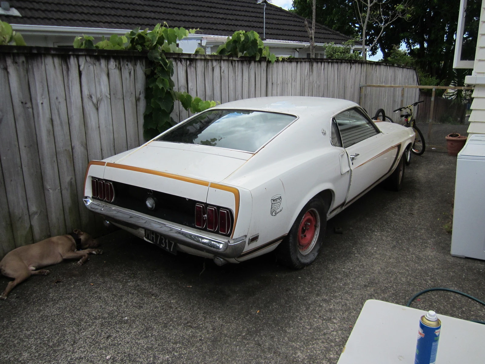

I'm looking forward to getting stuck in and getting it back on the road, I've included a couple of pictures.
Any help appreciated :)
p.s sorry for the poor pics, I just snapped off a couple when I picked it up
actually, now that i look at it further it appears the only twisters were built in 1970. so i guess it could just be a repop sticker. the marti report will tell you everything about it.

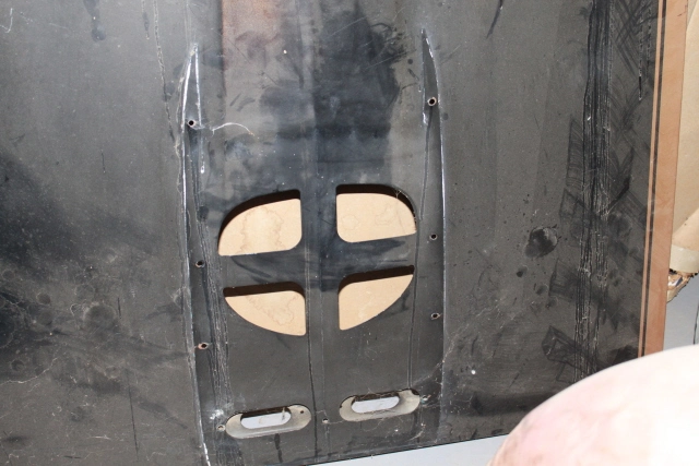

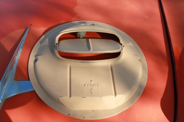

very nice, marti report will not help you .that is a san jose car ,marti report only covers east coast cars .the hood apears to have the ram air cut out although the center of the opening is cut out. i see it has the dash plack below the clock ,what does it say? the interior is standard black interior in my car but a lot of GTs were plain interior the deluxe was optional. yours could very well be a GT .same as my car it is a 2 v 302 and does not have the reinforcement plates in the rear floors because it was not a duel exhaust car. here is a couple pics of my hood showing what the cut out should look like.it must be a fairly rare option ,i have only seen two of them .the second was on a 428 GT fast back i owned several years ago . i was offerd $1,200. for my hood but i turned it down. the air cleaner was the cougar type under hood ram air with vacume flapper plate lid and rubber seal to the bottom of the hood. looks like you have a very nice start there.
Hi The Marti report has not arrived yet, but it says that it will give me the full spec for a San Jose car, I think they might have just started being able to do that though?
The hood does appear to have exactly the same cut out but with the center also cut out, its got the same bonnet pin holes too, maybe its original, maybe not, I'll take some better photo's soon and you can see what you think.

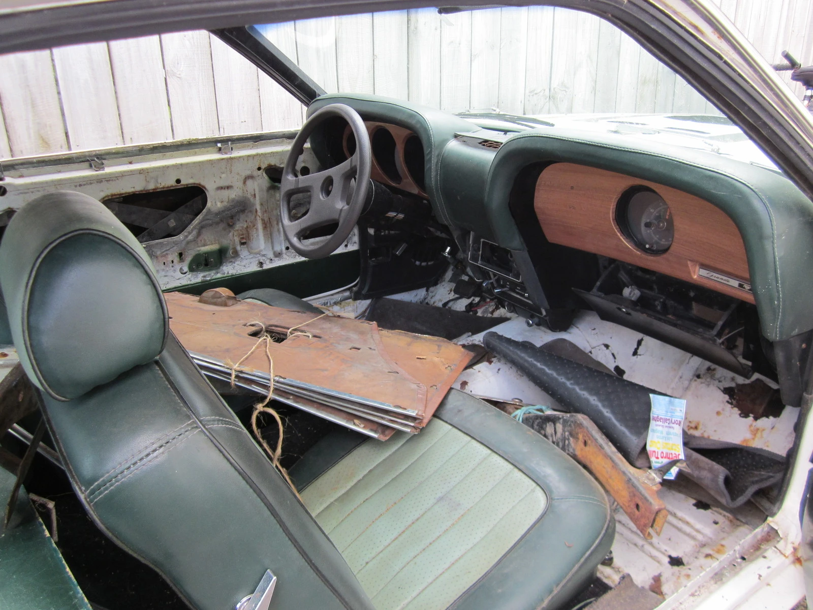

It says Grande on the dash plaque, and I have no idea if its original or not, its wood grain tho, the rest of the interior is in really good shape, but the door cards are standard I guess as the deluxe cards had wood grain and were a full fit not the short ones like mine.
I'm quite confused as to the fact that my car has 01 (hardtop)stamped into the vin, not 02 (fastback) any idea why this could have happened? I've had a few people over to take a look and everyone says its original and its definitely an original fastback, mistake on the line perhaps?
Thanks for helping :)
The Grande cars were not fastbacks, so something changed. The Marti report will be interesting to see, as it looks like the car has been through several modifications.

I would like to see the apron you are reading the vin number off of. You say it does not apear to have been welded. My guess is that someone had a 69 Grande coupe they were using as a doner car to put parts into this car. I bet that VIN you gave us will come back as a Grande Coupe that donated its apron to this fastback. Have you had a chance to look for the stainless steel VIN plate that should be visible through the windshield on the passenger side at the back of the dash? If it matches, you may have a 69 Grande that has had a sportsroof grafted to it. If you disassemble the interior in the back, we may be able to confirm or rule that possability out.
Hi I'm going to guess that its not a real Twister, sadly :( I think the sticker may have been added after it was painted, and maybe the dash too!

I had a the same thought about the car starting life as a Hardtop Grande, but it does not appear to have been altered structually all the welds seem factory to me and the other people who have checked it out, I 'll strip it out and add some better photo's and maybe one of you guys will see something!

The dash had been recovered in green vinyl so I stripped that off and pulled out a load of interior and stripped back the inner guard (apron?) paint and have discovered the following.
