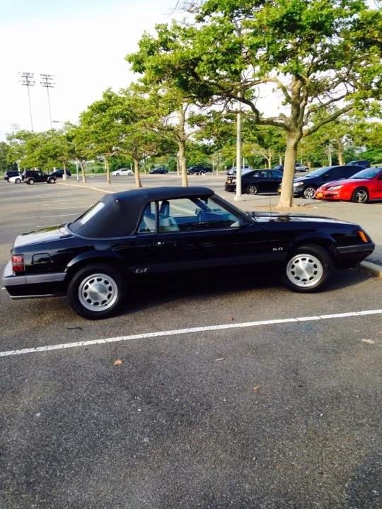

i need to replace my convertible top and I was wondering what people's thoughts were: vinyl vs cloth? The car is an 86 so it currently has a vinyl top.
