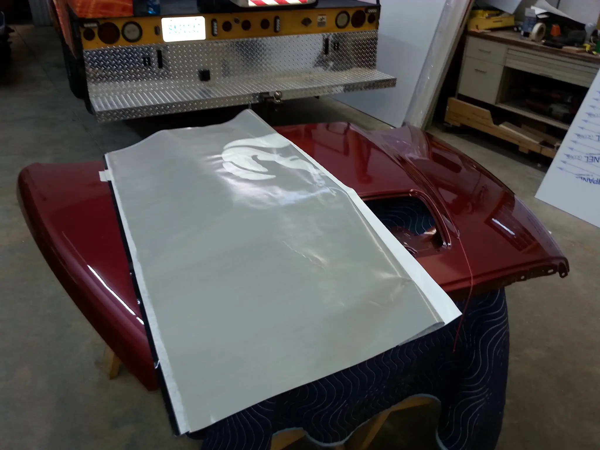

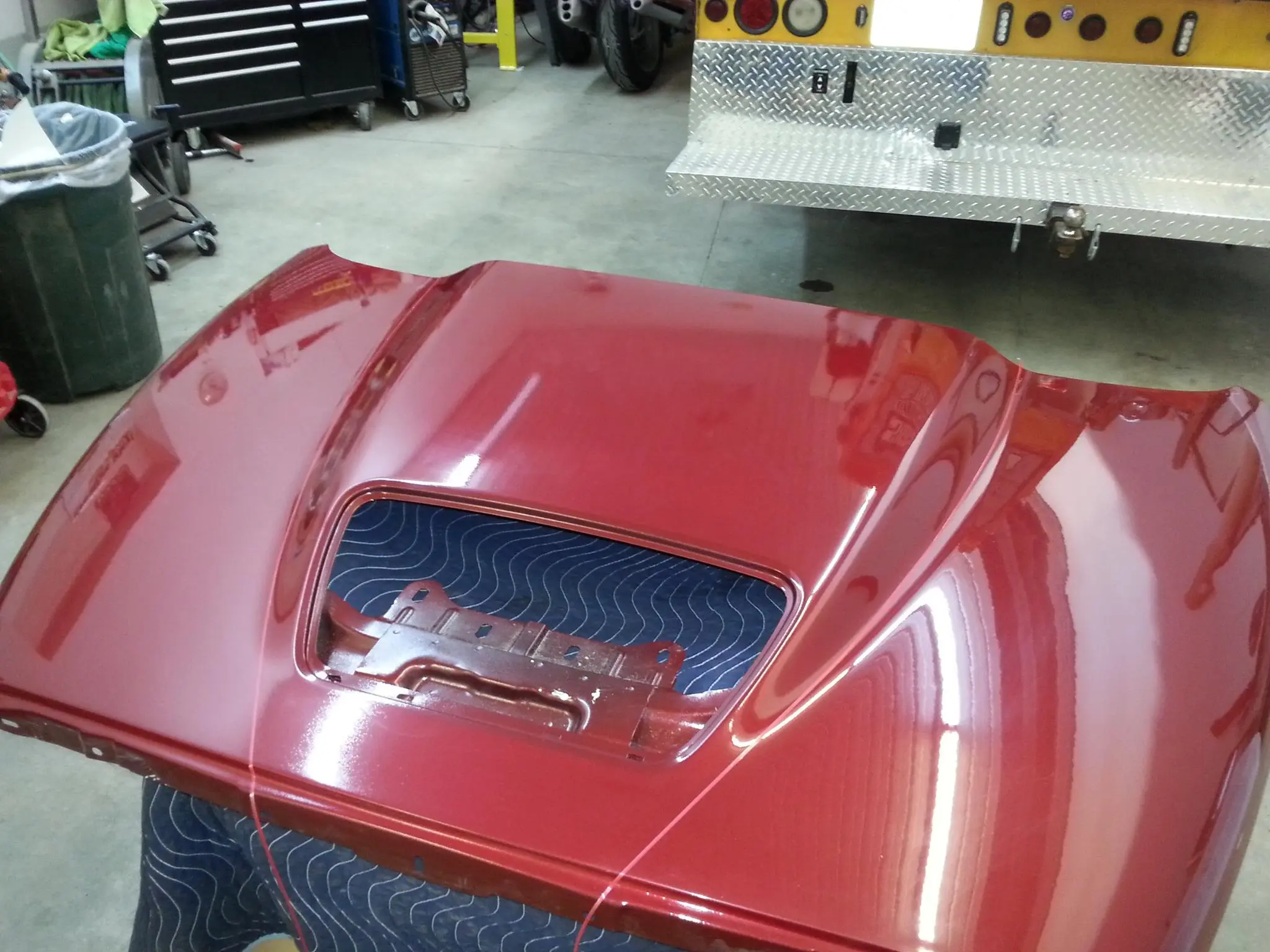

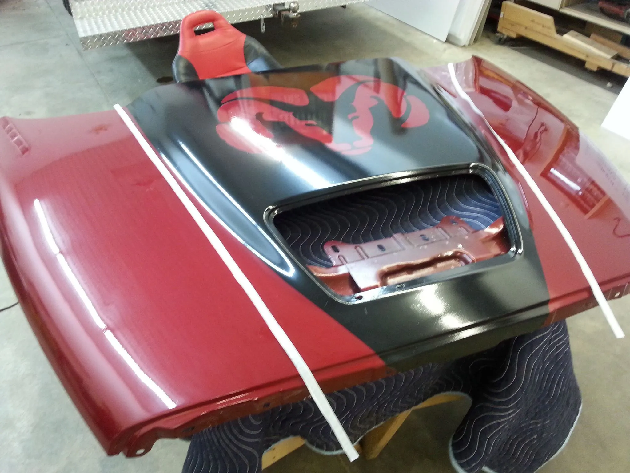

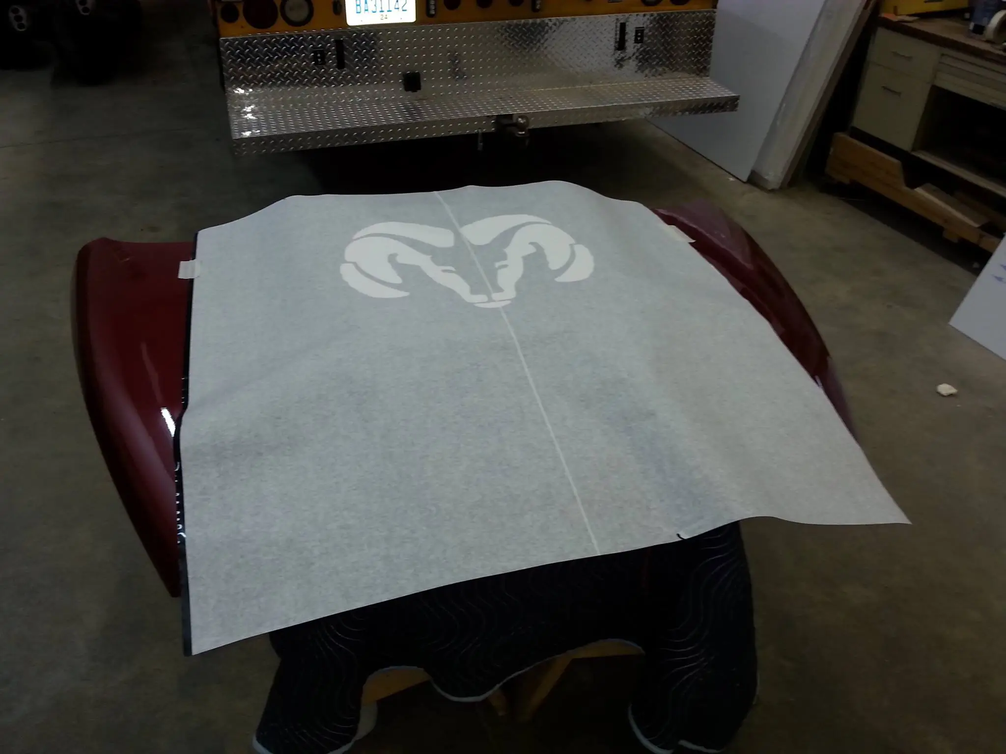

Here's what we are starting out with. If you can see the "pin stripe" on there, that is cut tape. It is basically really low tack tape with a string in it. It makes it so I can cut off the extra without using a knife on the paint.

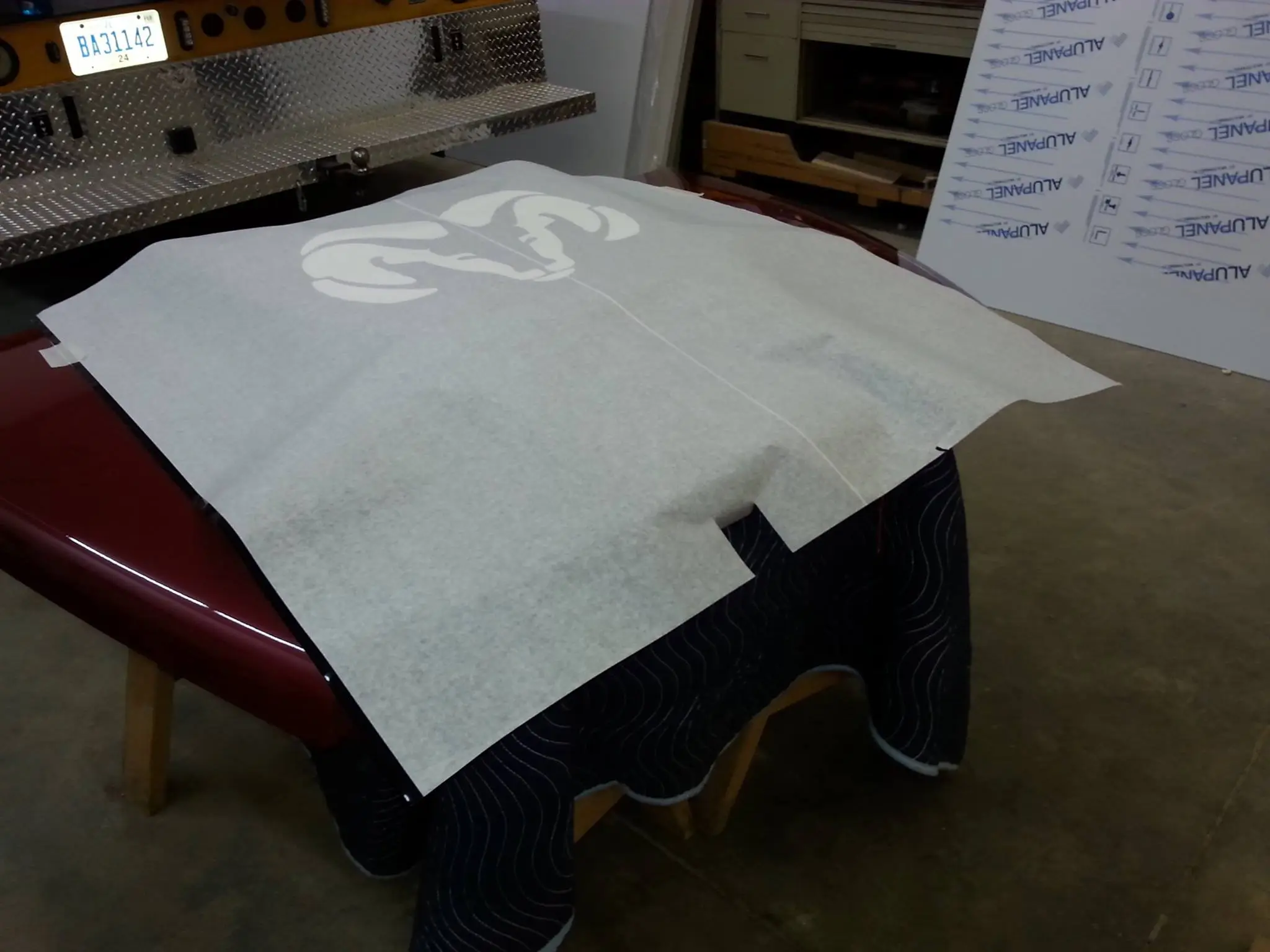

Once I was happy with how it was lined up, i had to cut some notches in it to be able to tape it down
no turning back now

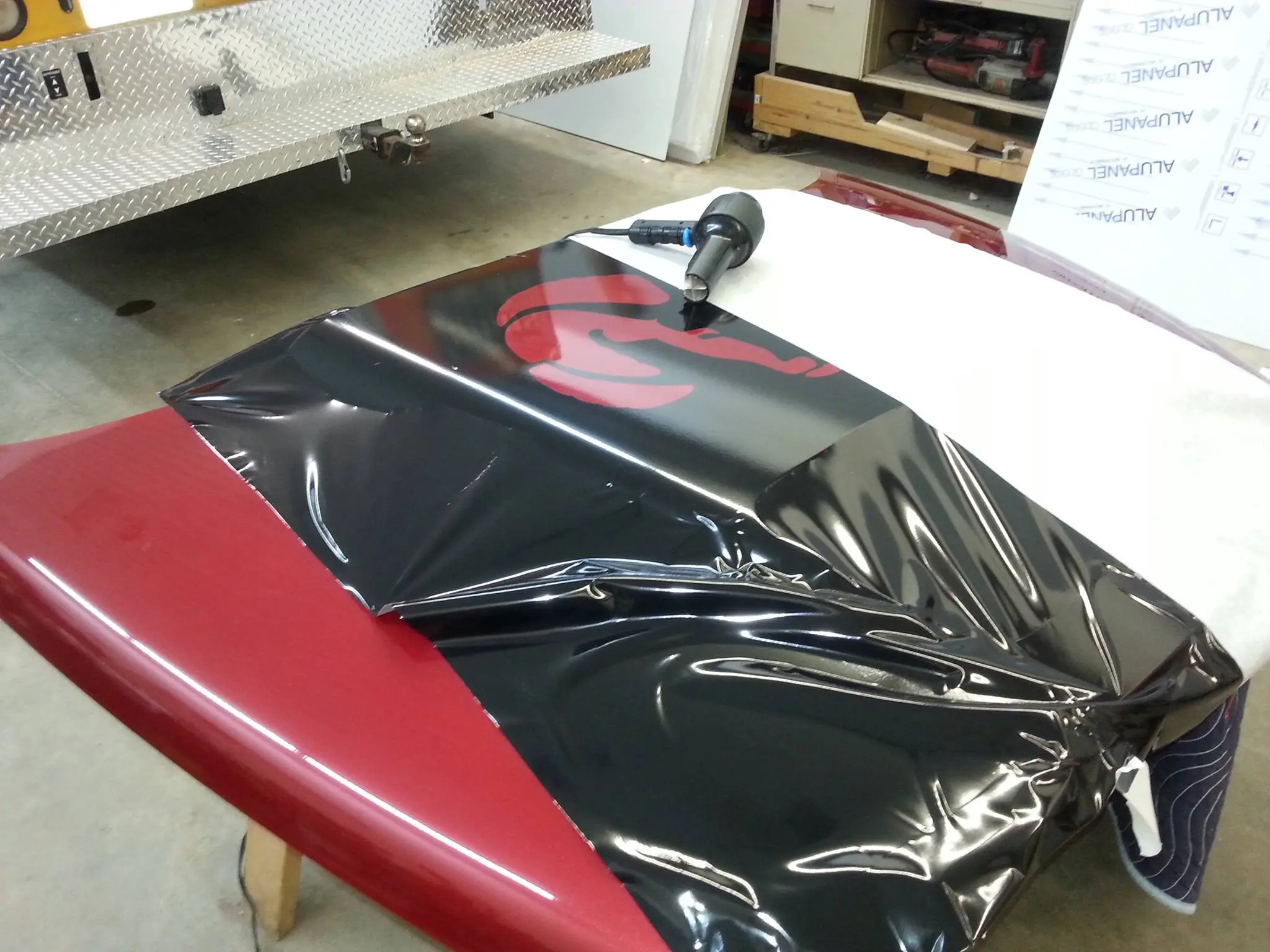

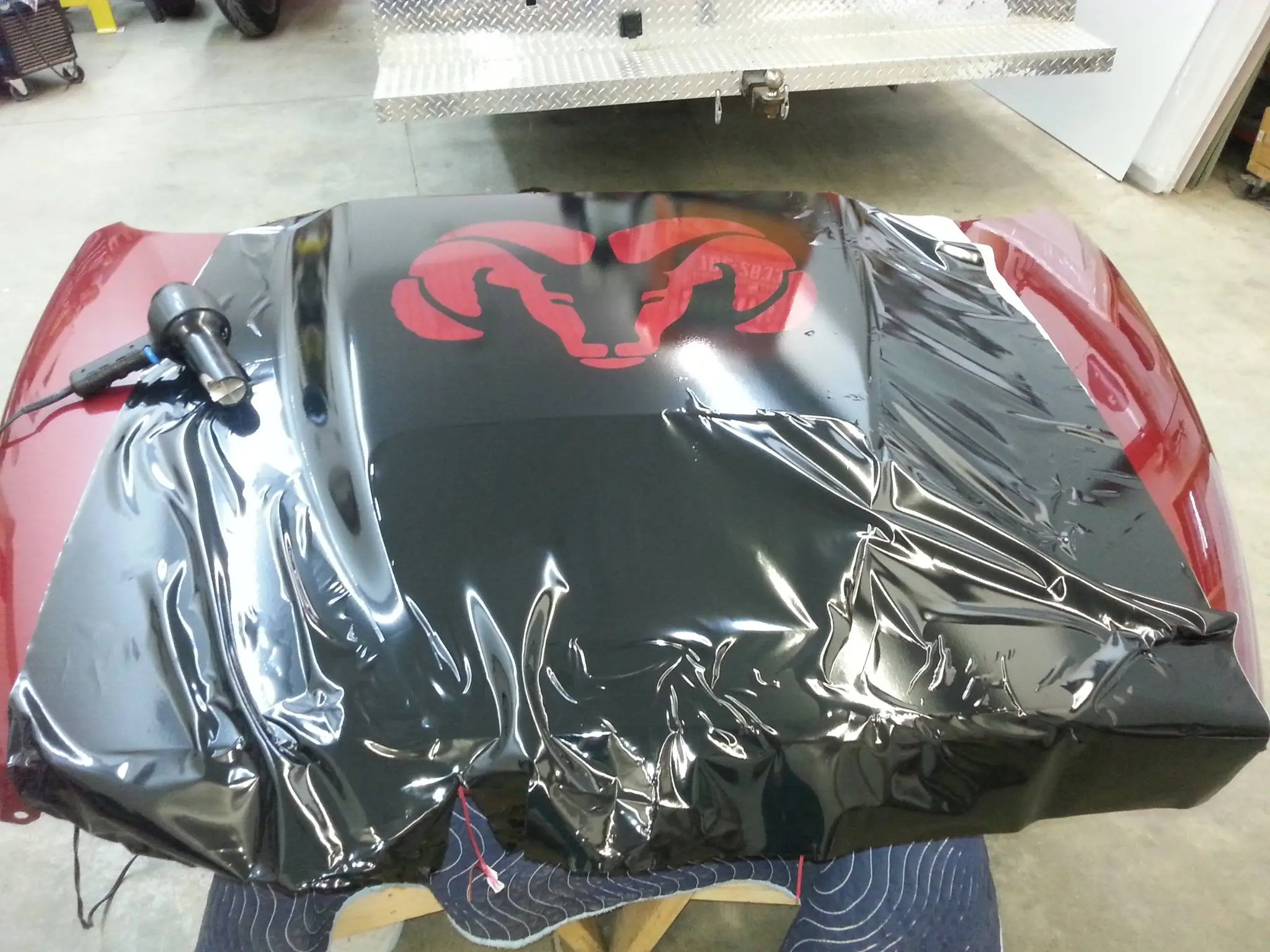

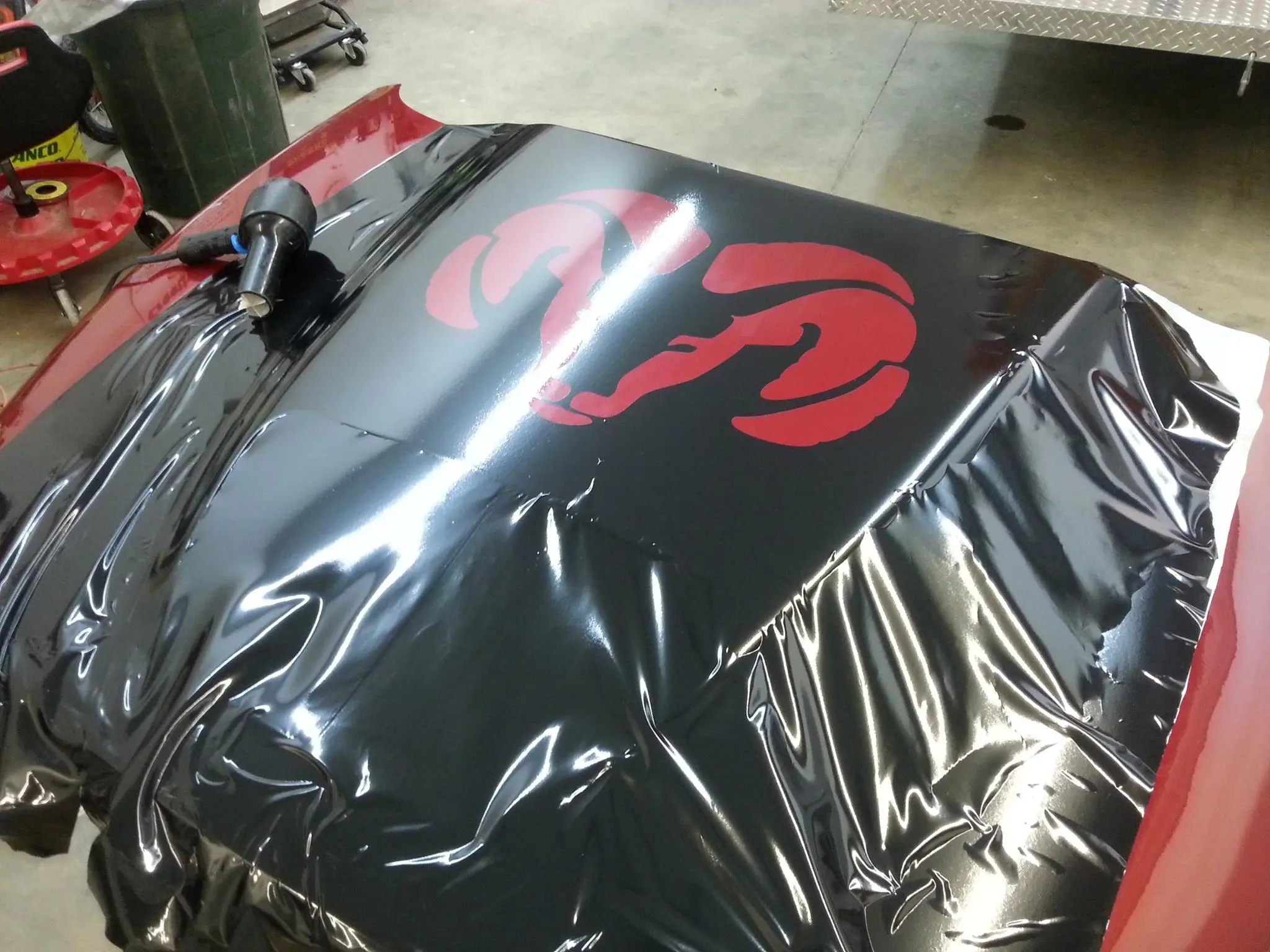

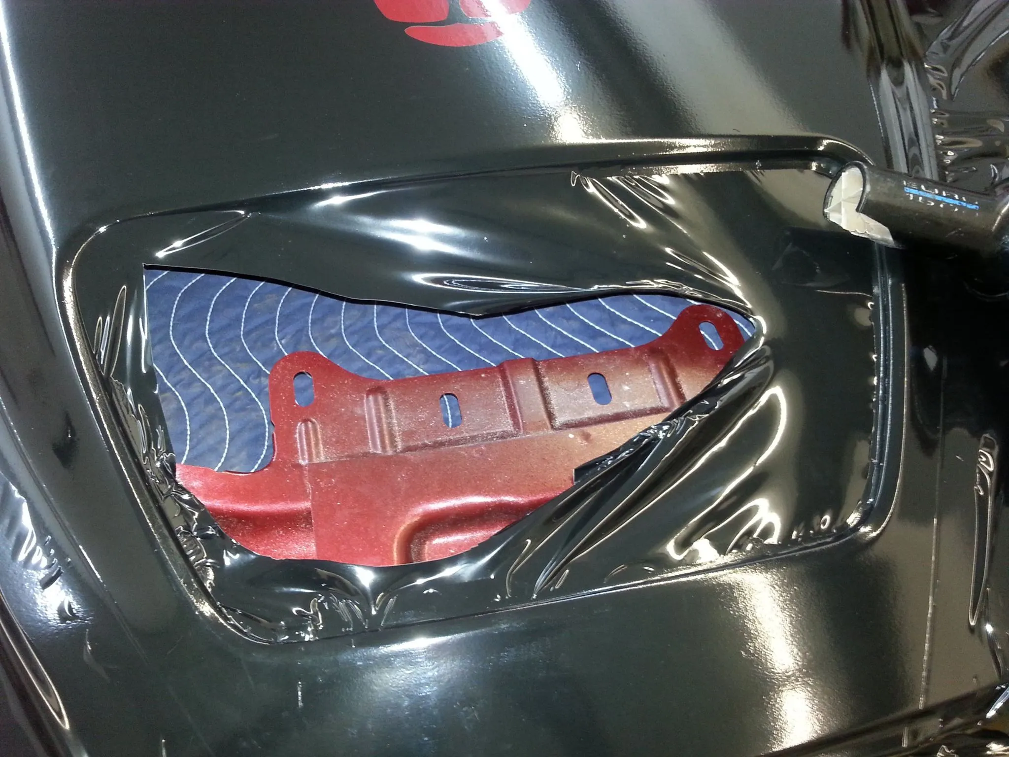

The vinyl is more conformable then the tape, so the tape has to be removed once there is too many curves. Once the tape is removed the vinyl can stretch much easier, and that can create its own problems when you don't want it to stretch...
Aaaahhhhhhhh!!
lots of heat to get it to stay put...

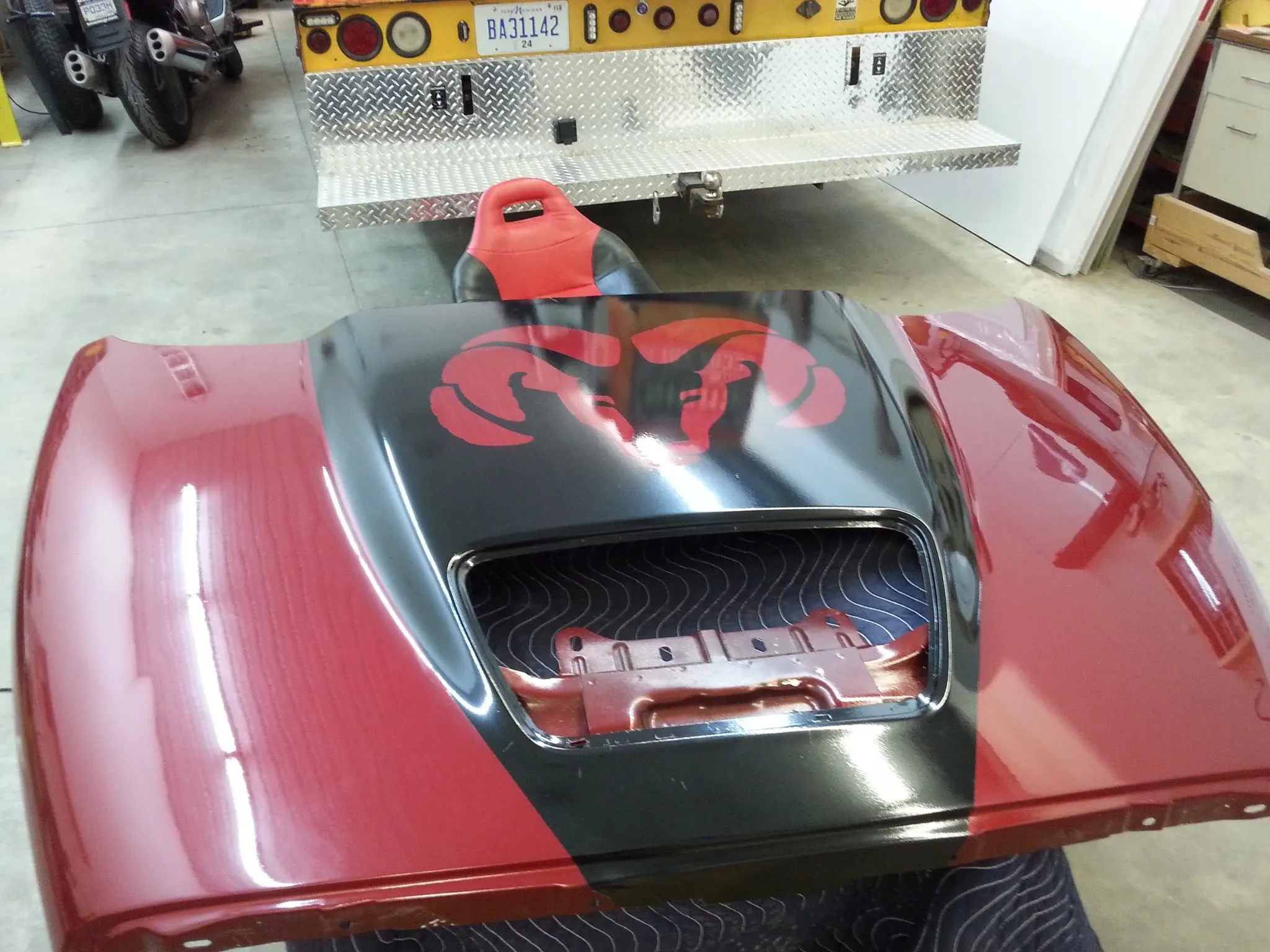

Almost there

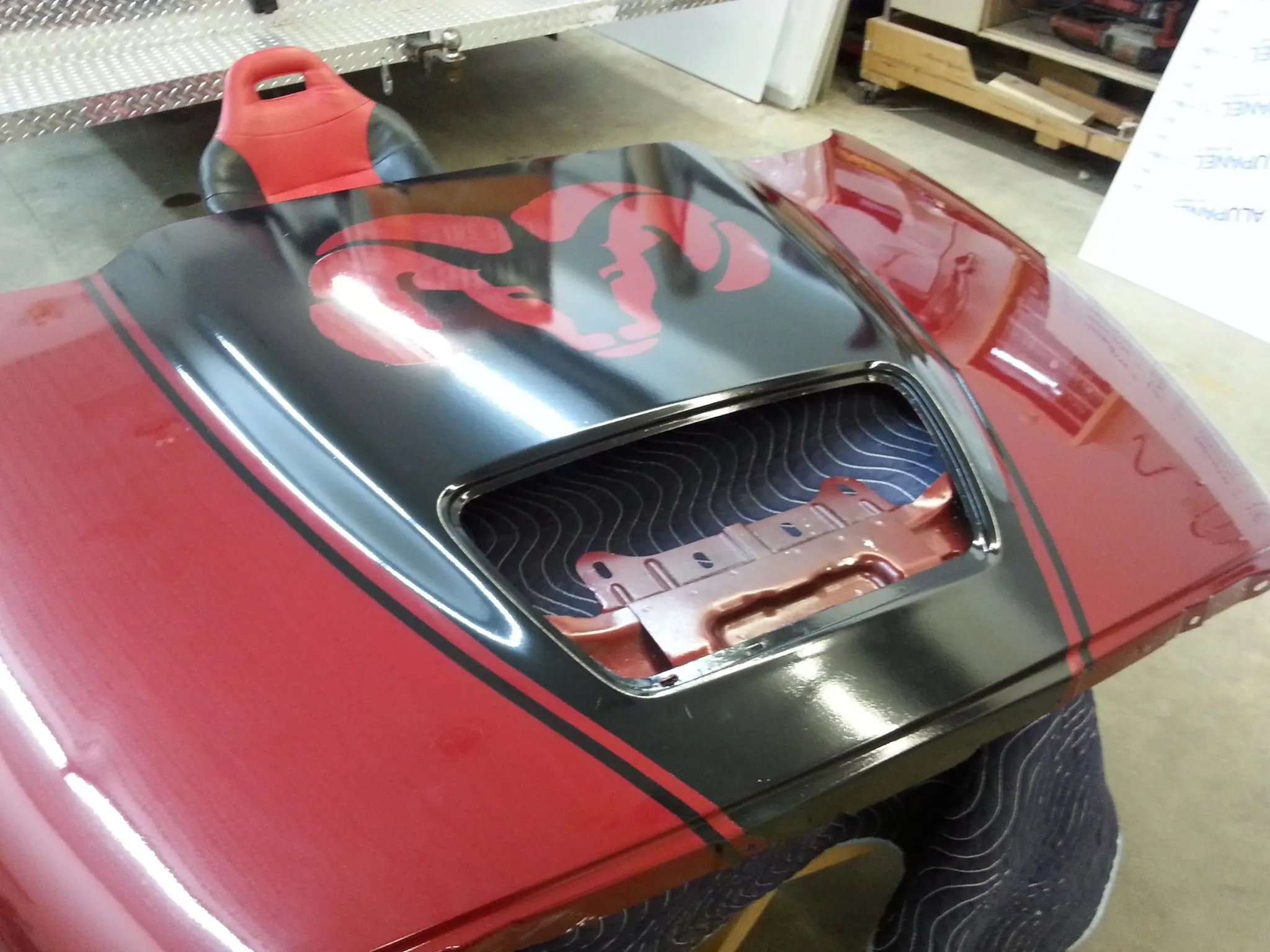

He also wanted pinstripe along the sides
Taa Daaa.
Time wise, this took me right around 2 hrs.
