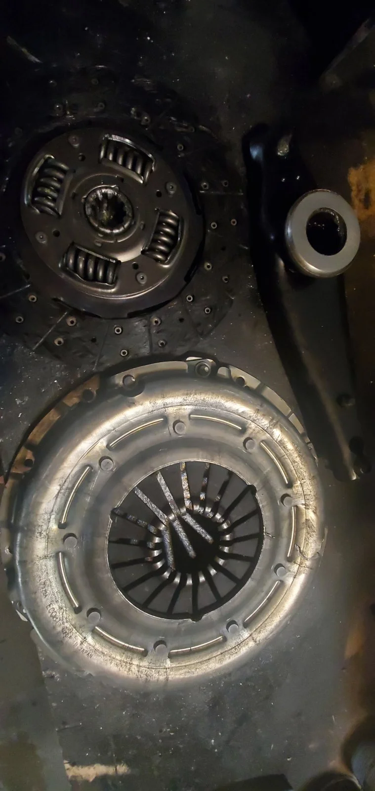

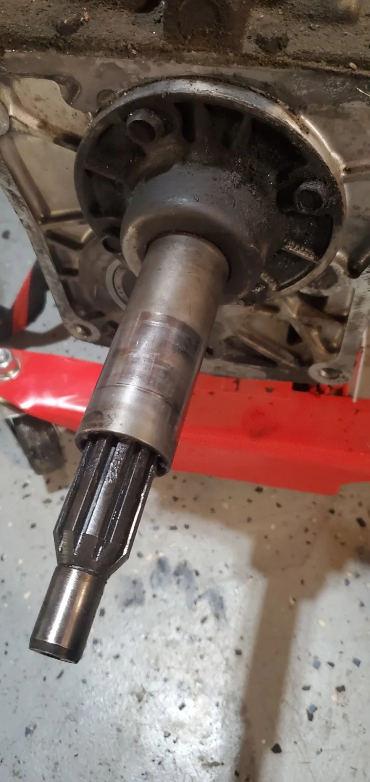

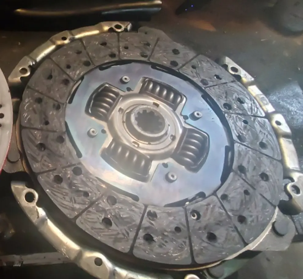

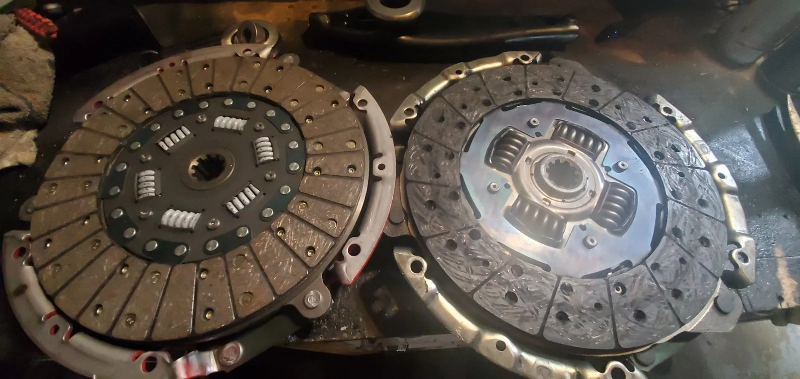

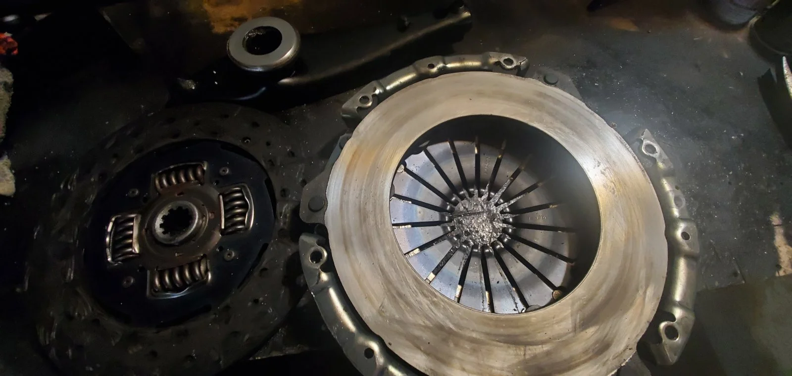

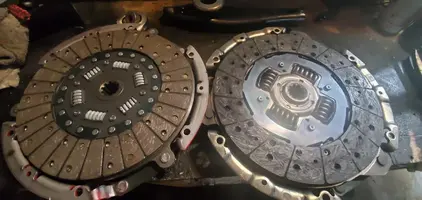

Okay guys, I got everything out. Honestly, it looks pretty good still. The bellhousing wasn't on very tight, but wasn't loose. Anyhow, as promised here's pics of everything, including the new McLeod clutch set, side by side with the old Exedy clutch set.
Back together it goes!

If this is how it looked when you pulled it then I'd say that you found your chattering. This looks like it was cocked to one side.
Did you order a steel retainer?
Your first post was about the clutch fork falling out when you took it apart.... I am coming from a chevy old school background here, but when we did a clutch as kids ( a very long time ago) you could easily install the clutch fork incorrectly on the pivot ball.. Again I am talking GM here, but you could slip the fork on the ball using just the flat spring which was incorrect...
I want to think clutch forks are all pretty much the same, so I would check and make sure you have this correct...
